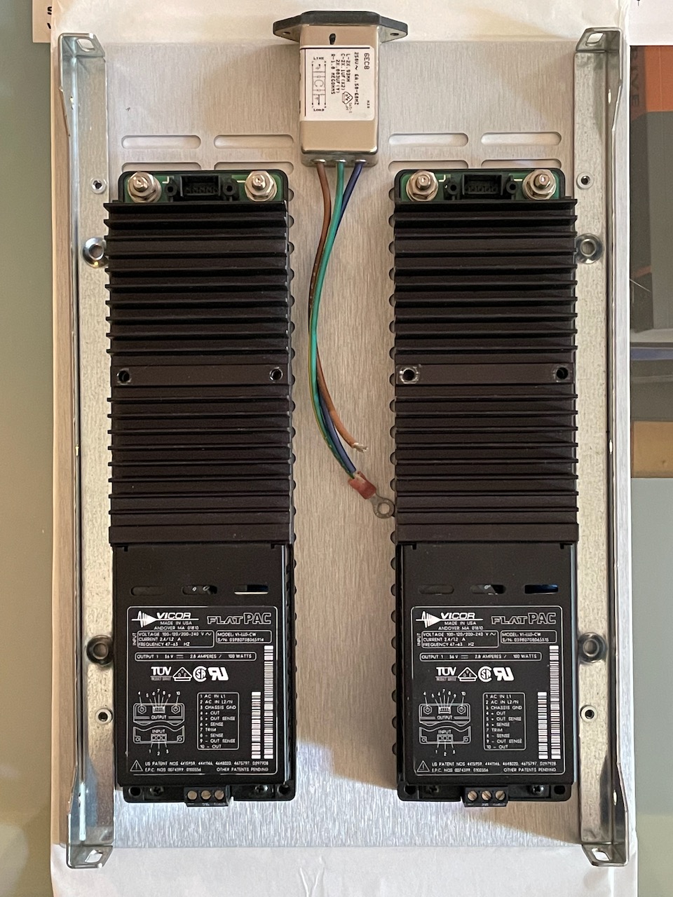

I just can't help myself. For better or worse, I'm still stuck on an internal power supply. After mocking up 2nd chassis ideas in CAD, I'm not really feeling the aesthetics are working out... 1U chassis too short, 2U chassis too tall, when stacked with the V-FET chassis. So, it's back to internal.
These twin cuties caught my attention... hauled them out of the "surplus acquisitions" box. Very expensive new, but sometimes you can snag them surplus at fire sale prices. Pure coincidence, but these ones are just the right voltage. I'll test them out carefully and see if they're up to the job or not. And not to worry about blocking the ventilation - I'd mount them on some standoffs to create an air gap for good flow from the slots underneath.
If I go with these dual-mono supplies, then I'll probably design a high-performance filter board for them and will be happy to share. Most likely to employ a quality common-mode choke and meticulous RF layout & component selection for best switching noise suppression.

They are very quiet, but not as quiet as the VFET. Hoping for a higher-power SMPS filter concept from Mr. Johnson...

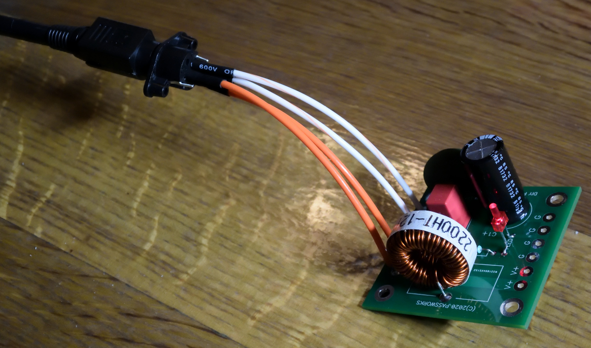

Soldering the power connector required a bit of patience. To be sure I mounted it correct I attached the Meanwell and measured the output voltage on the filter board (36.2 VDC). Also the red LED "worked". I dim everything so I do not install a LED at the front. But I can always look down in the amp if I am "in doubt". I switch everything on at a central place so I also do not use the on/off switch (bypassed on filter board). Then I don't need to think about the longtime DC-current performance of such a tiny switch
.....but I installed it to "fill out" the hole.....
