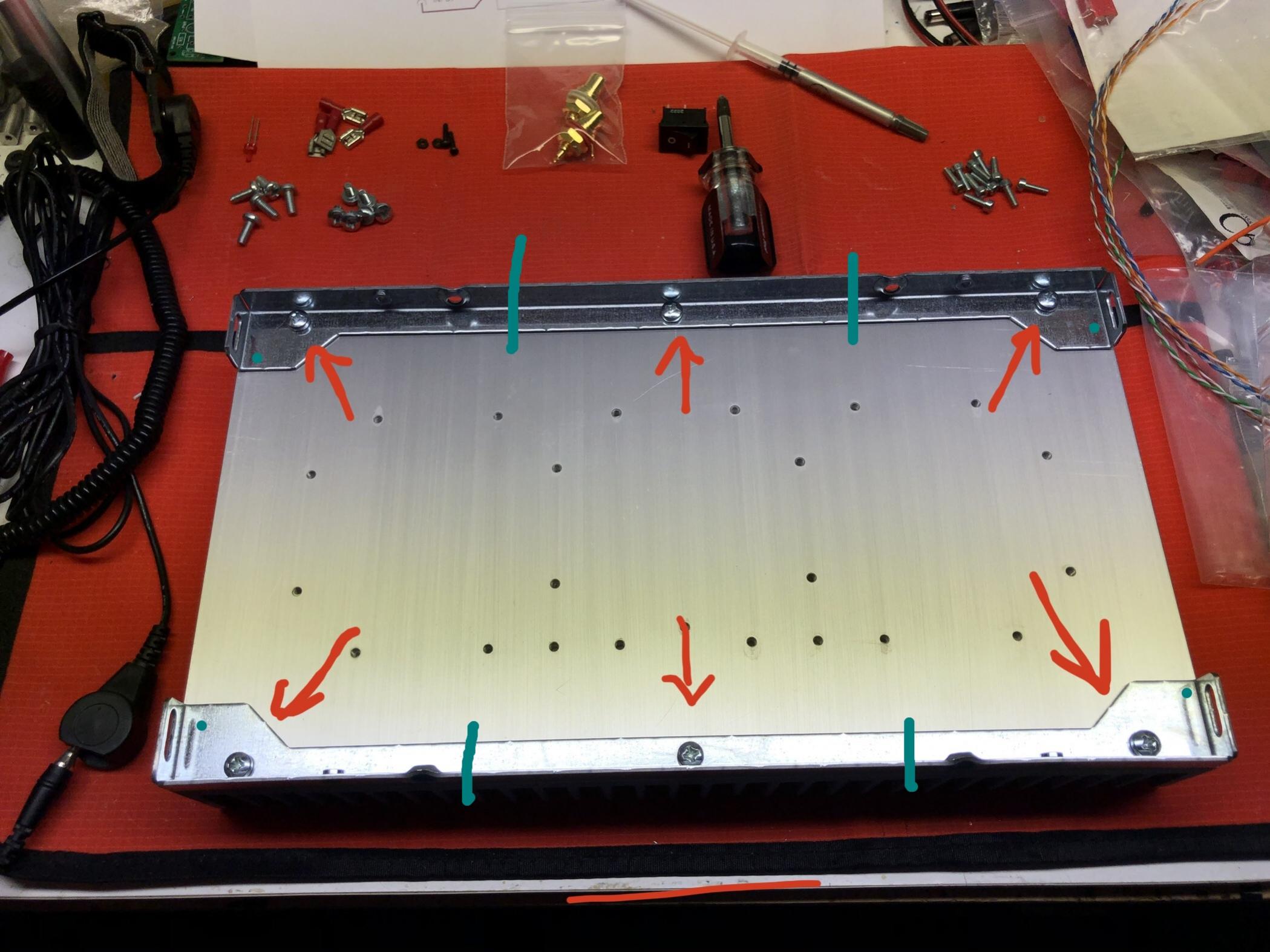

All of the Hifi2000 Dissapante chassis (best stuff you can get short of being your own machinist) use high quality heat sinks, and well done panels. The rails, I have to say are not always perfect. However, they are easy to use. I try to adjust them to fit the heat sinks, which are straight, and square. As mentioned in other replies here, washers cane be used for shims in some cases. I have not needed them, so far.
Short of your own fabrication, I love these chassis, and look forward to using this modified chassis for DIY VFET round 3. Just work with the chassis, it’s really hard to find better for this application.
I re-aligned the rails on my chassis after first assembly so rails flush the heatsinks at the ends so no part of rails is above heatsinks. Then rail lowest point is in the center which then is a bit below heatsink edge. Then top and bottom plate fits nicely this way with no gaps.
