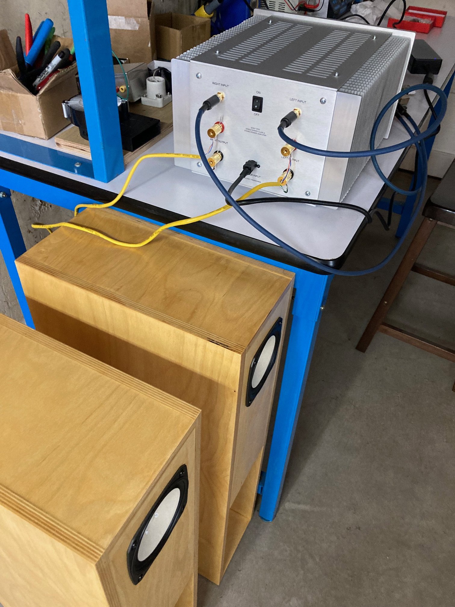

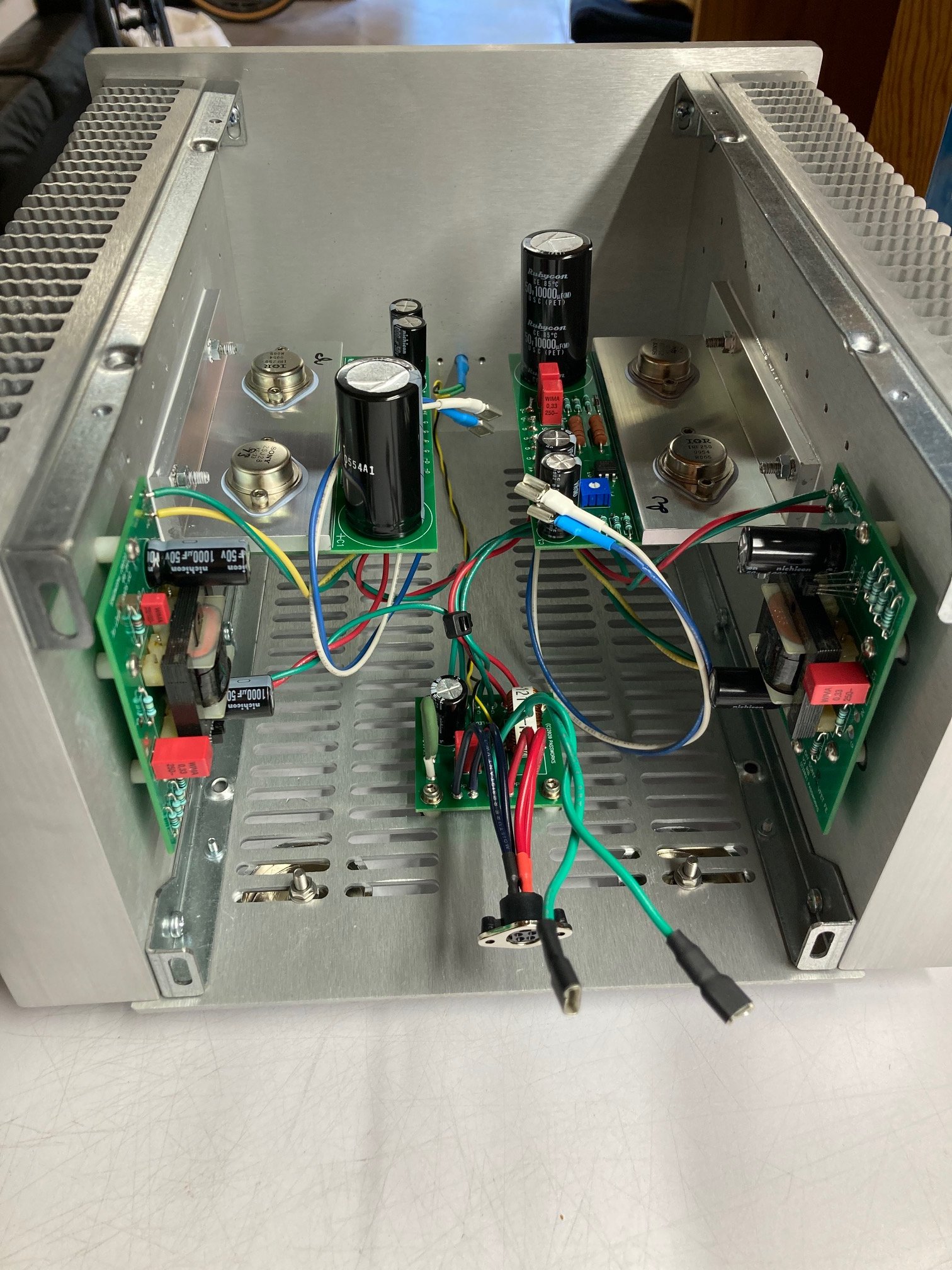

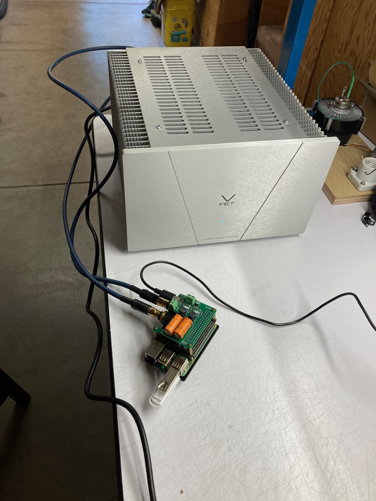

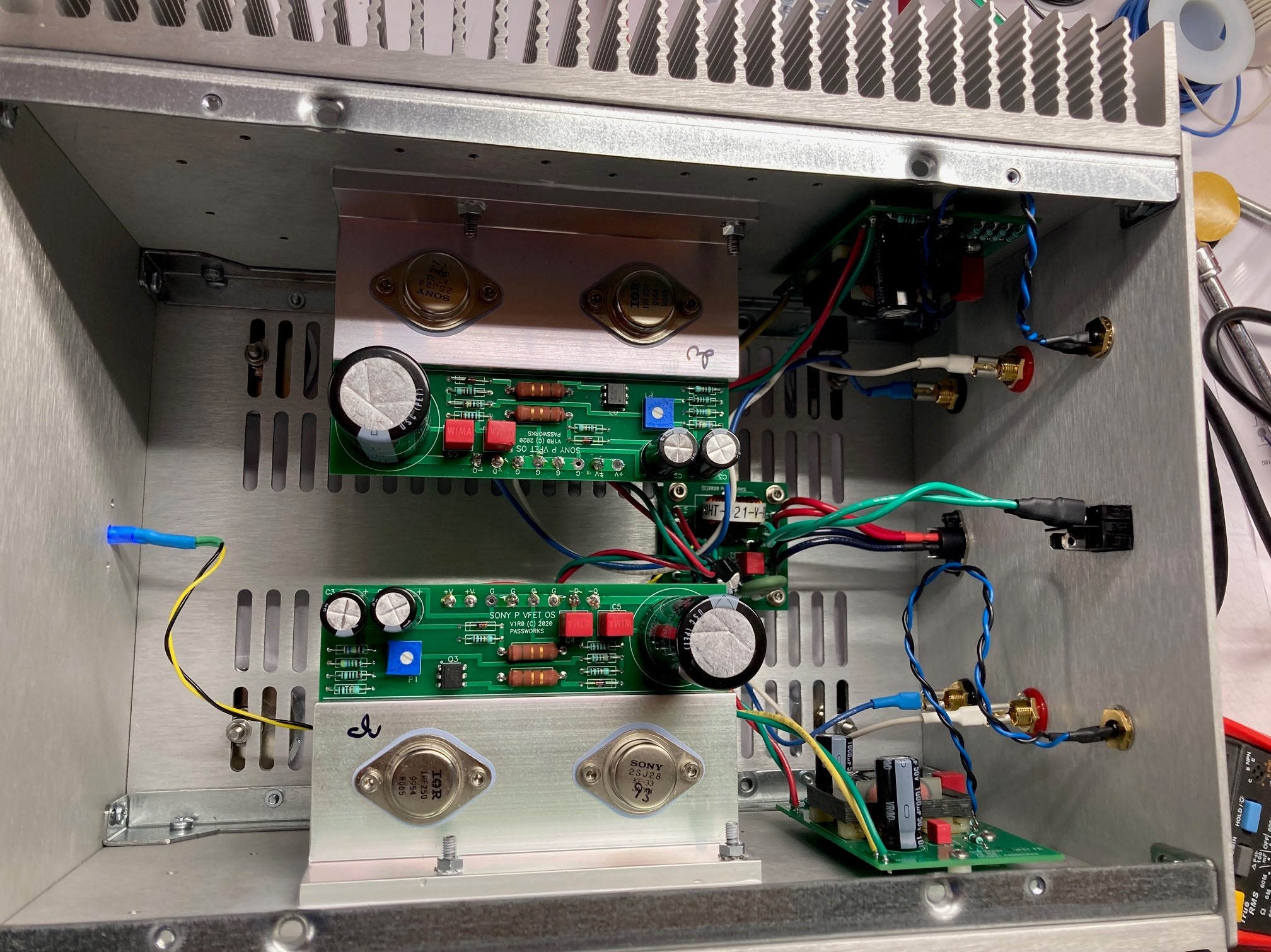

One of the last of the P-channel DIY Sony VFETs is built up now & singing. Done just in time for Christmas too. How cool is that? ![Santa 2 :santa2: :santa2:](https://files.diyaudio.com/forums/images/smilies/santa2.gif)
(Eternally grateful not only to Papa for the lottery gift of the OS, FE and PSFILT kits at BAF2022, but to Gianluca for re-opening the chassis production, to 6L6 for the build guide, and to ZM for his modifications- note this one has M4 studs holding the T-bars to the heat sinks.)
