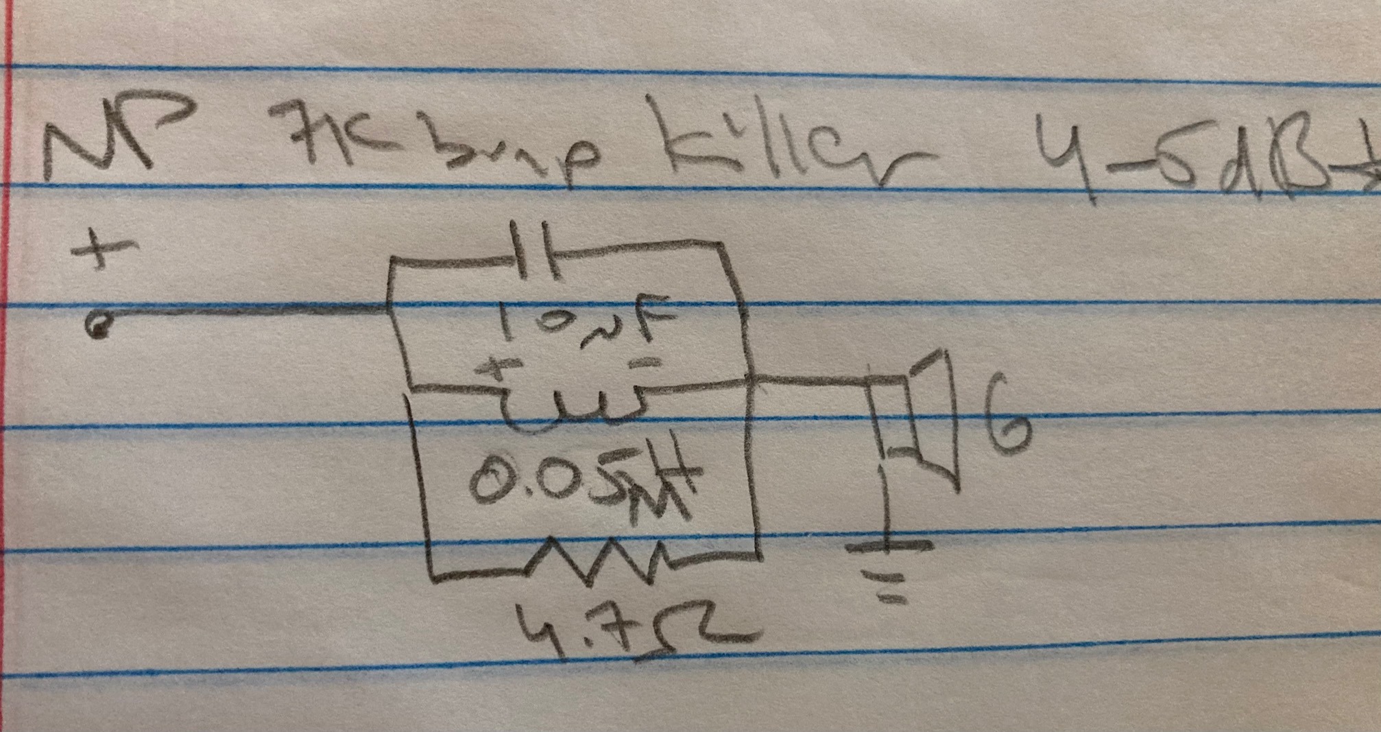

There's a 7k tank circuit that NP designed. I don't remember where I saw it, maybe in the current source docs? Was thinking of trying it but haven't yet.I have the BK108 Eckhorn & FE108sigma horns and I've matched it with my VFET (2SK82) but, it is shouty - and the vendor sold me a step correction (not really baffle step correction); in his horn the low mid dissappears, so a step just abocve that "should straighten it all out". It does not. The sound is not natural. [I bought the complete horns in Covid lockdown mode, no listening]

BK108? FE108∑?
I am not familiar with the first, but i have a good ideam likely produces little real bass. The FE108∑ is something i have not seem but the pre-EnaBL mods, modpodge/puzzlekoat, and ZIG 2-way glue. Has help with the resonances in all the FExxx & FFxx5wk drivers (the last ned a bit different detail on the metal dustcaps.
I tend to avoid filters and attack the problem at the source.
dave
It is the FE108∑. Thanks Ranshdow I followed up the filter now - though slightly different: 0,39mH//5,5ohm//10 uF, and the a high frequency smoothener: parallel 22 ohm and 22uF+5,1 ohm - direct on the terminals, to take away a slight harshness. It is great now!
Dave yes you are right, the ‘new design filosophy’ at Fostex is a 3-point suspension of the dome, really bad. It will swing independent of the cone. So as such it is a sort of coax, with all the problems. I thought of putting glue in the hole! Probably what you suggest as the 2-way/2 component glue. But I dare not.
