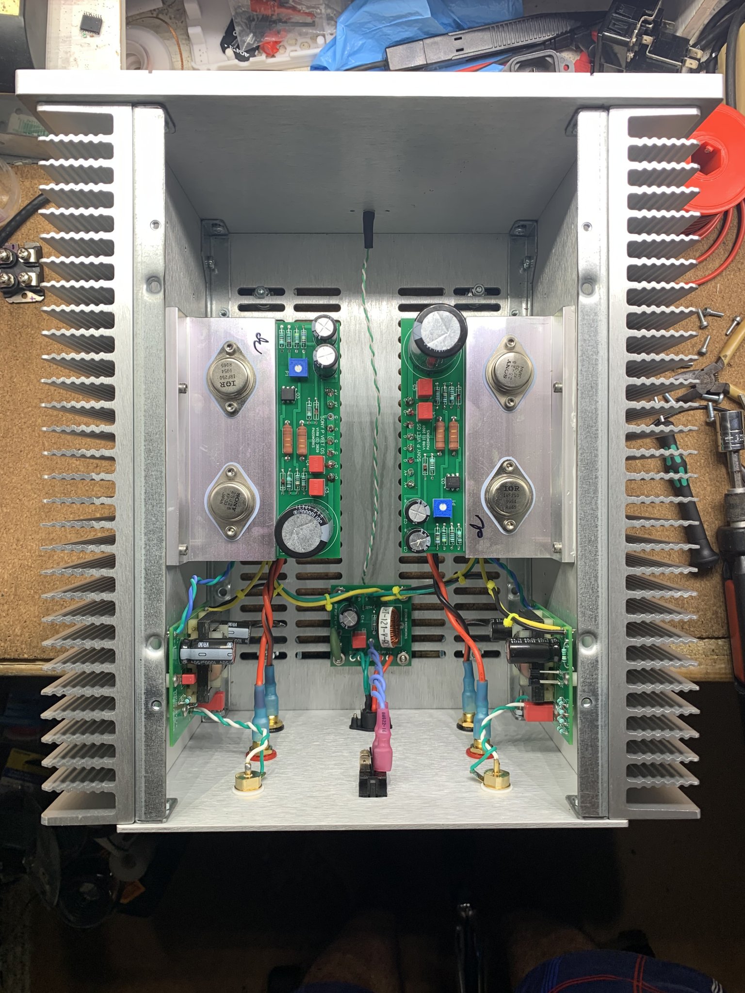

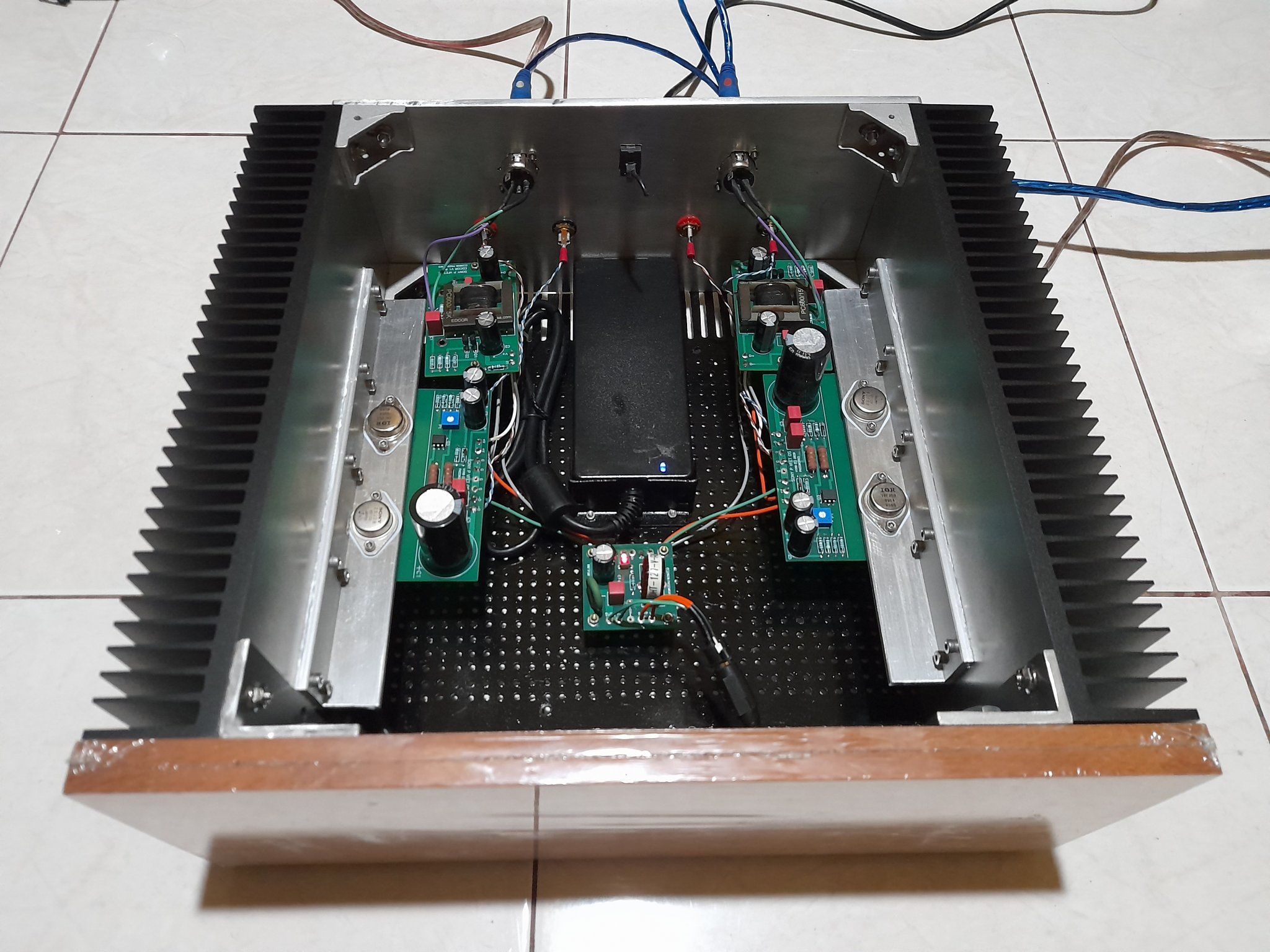

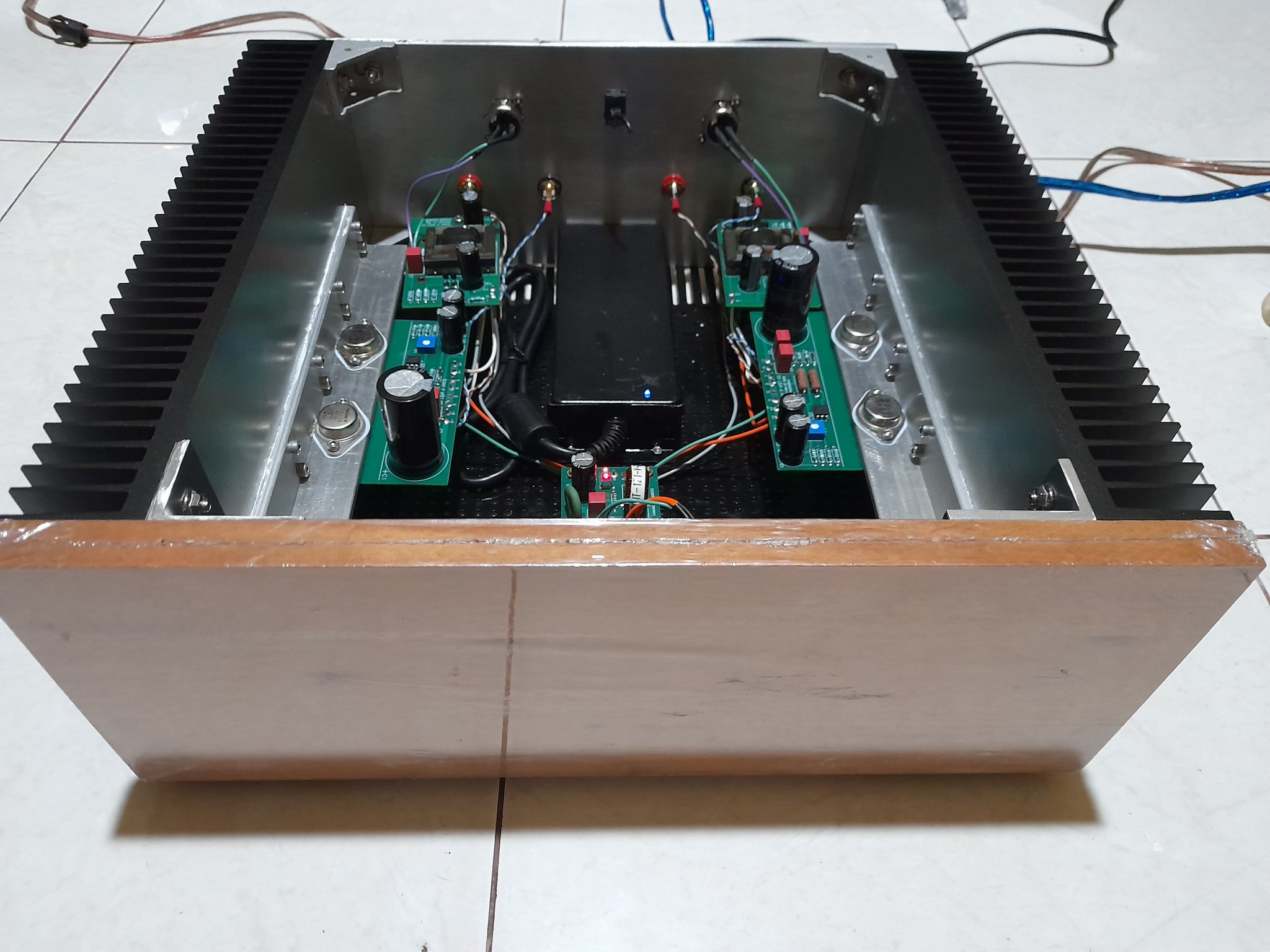

Both channels up, it's alive... reporting for duty from pearl of orient.

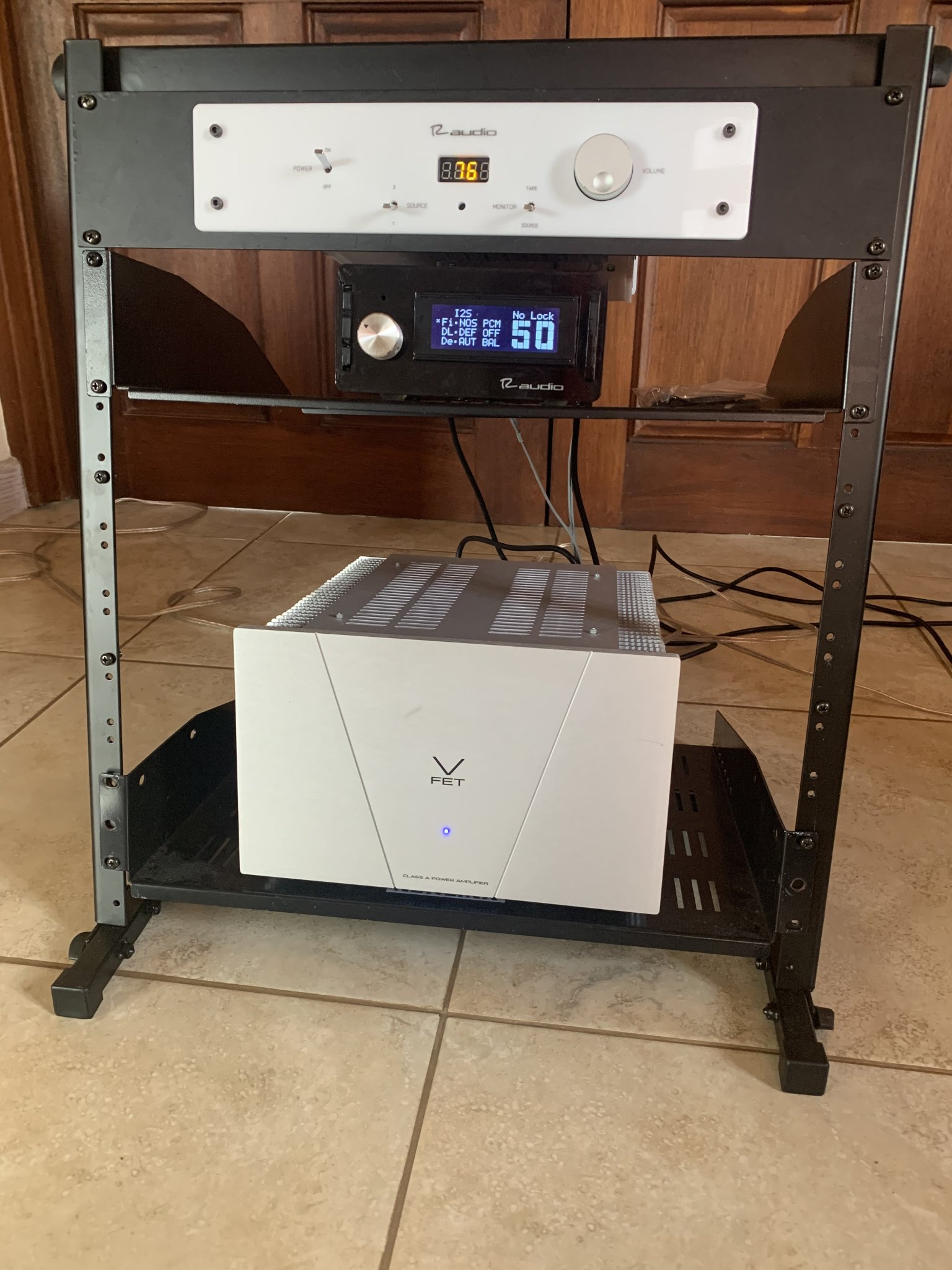

Late to the party and still can’t quite believe I have one of these! Finally got all the bits needed to complete the essentials kit I managed to snag online at BA22 and built it the next day.
Sounds wonderful into 93db floorstanders. Like others have commented, excellent bass and sometimes it can sound downright spooky!

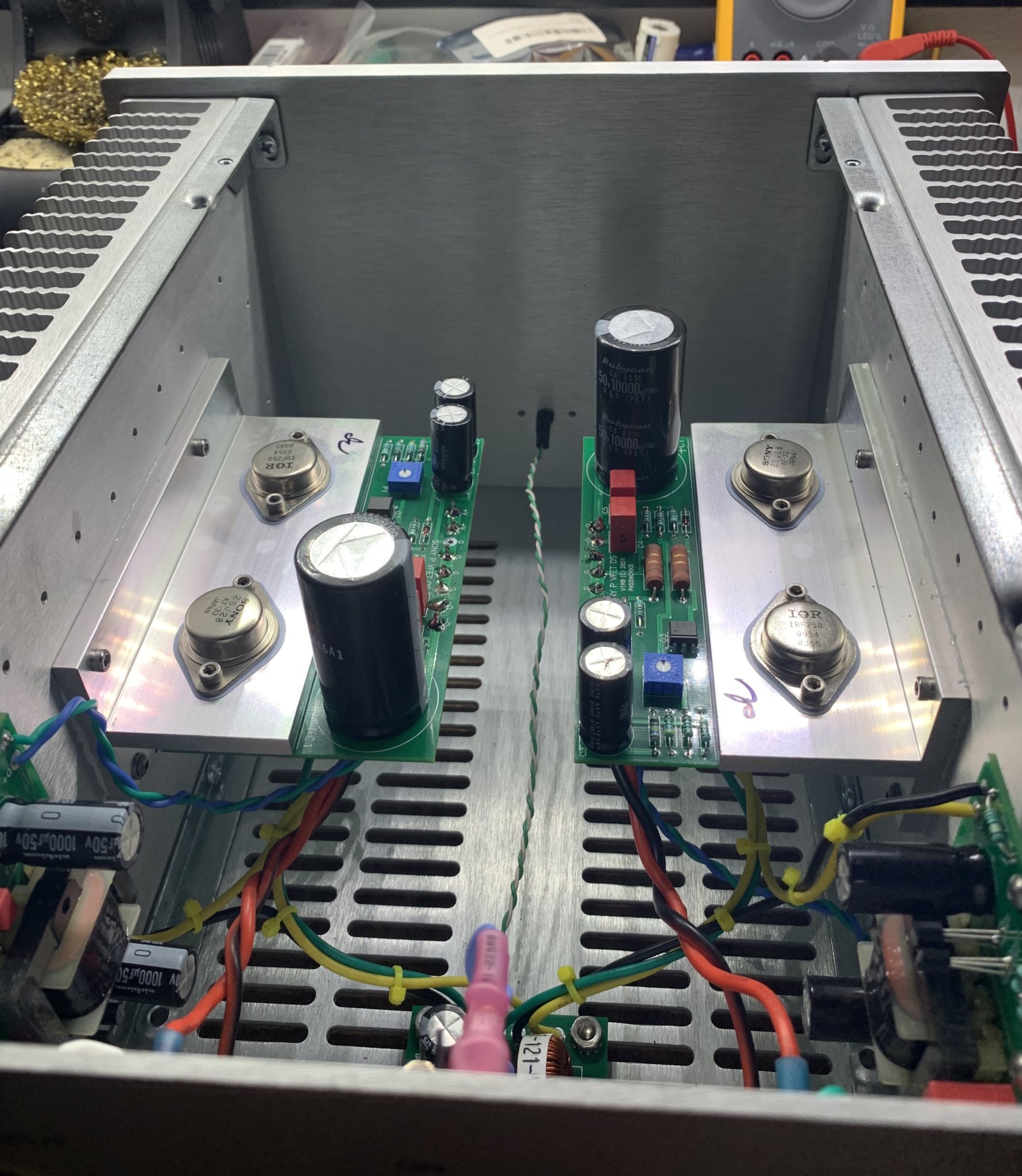

ZM - turned on the amp and fired up the multimeter's temp measurement. It said the ambient temp was 33 degrees C - it IS a hot day but that seemed about 3-4 degrees too hot but who knows....
After an hour playing music with the cover resting in place I removed the cover and measured the VFETs: 61 degrees each. MOSFETS were about 3-4 degrees less. Center between the TO3's was 50 degrees
Outside of heatsink - closest to T-Bar center (i.e, not on fins): 53 degrees C. Fins around 45 degrees. PS case 40 degrees.

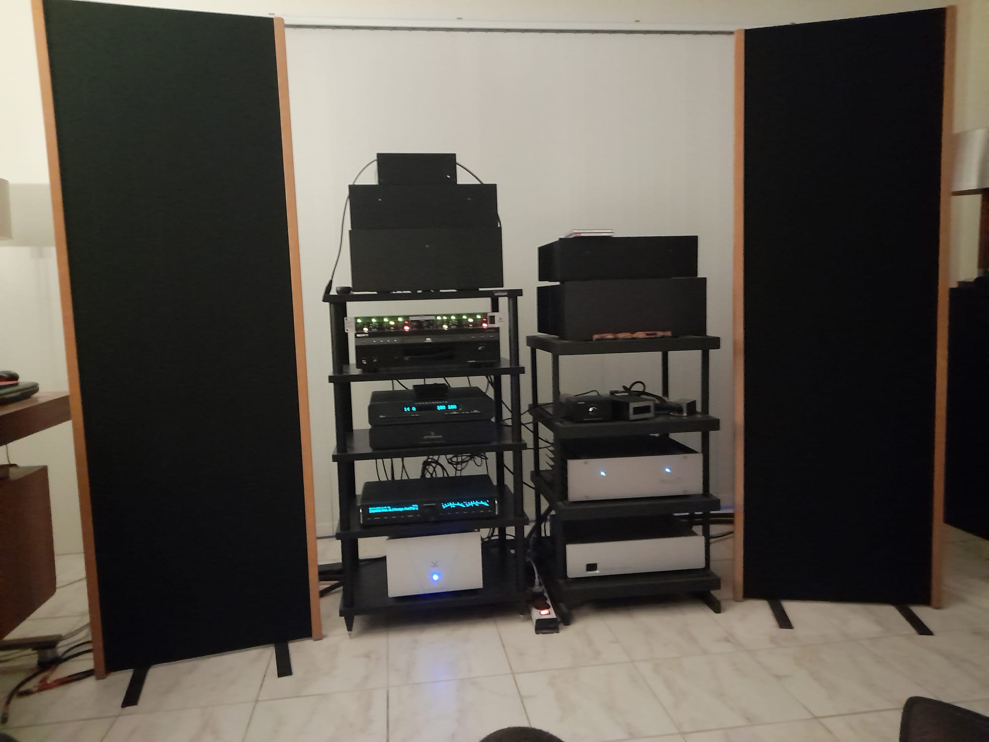

I had my old Magnepan MG3A's rebuilt by the factory some time ago. I have had them for 25 years and always ran them biamped with the same preamp (Jeff Rowland Consummate) and power amps (Aleph 3 for mid/high and Plinius 8200P MkII for bass). The Aleph 3 amplifies the full signal and the bass amp takes the bass output from a Behringer crossover (running the Aleph 3 from the mid/hi outputs of the Behringer sounds awful). [one day I'll build the diy crossover haha]
My preamp stopped working about 5 years ago and replacements (incl. a diy Aleph P1.7) never gave me the sound I wanted. I recently (finally) got the Consummate preamp working again (see my cautionary thread on leaky capacitors) and it is back to it's glorious self. I hooked it up in the old configuration (but now using an F5 for bass instead of the Plinius) and finally have the sound back I had missed for so long.
But ...
Although the vfet only output 5W into 4Ohm, I thought I would try the vfet to power mid/hi of the magnepans on Wednesday (replacing the Aleph 3). My recently recapped preamp was set for 6dB and my crossover needed quite a bit of adjustment to cope with the lower gain of the vfet, but even though it could not play loud, it was the best I ever heard. Today, I changed the preamp gain to 18dB and am amazed at the soundstage the little vfet is able to project through/on the magnepans.
I have a pair of diy F4s so an obvious experiment is going to be to try the vfet in combination with the F4s. Not sure when that will happen though, because I am enjoying just having the vfet powering the mid/hi of the magnepans so much!
