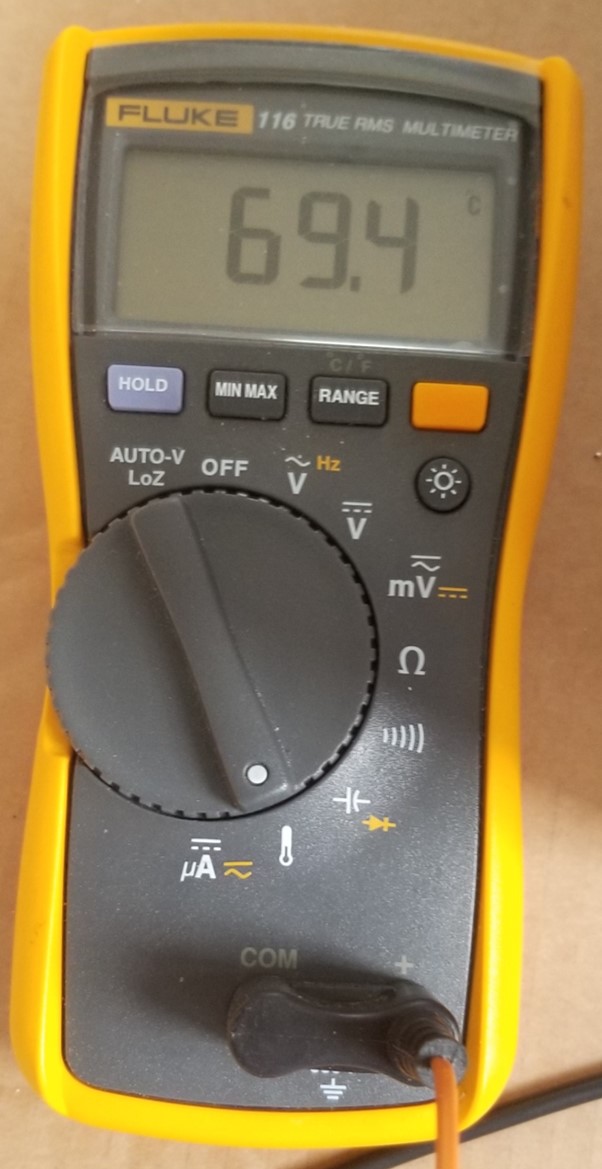

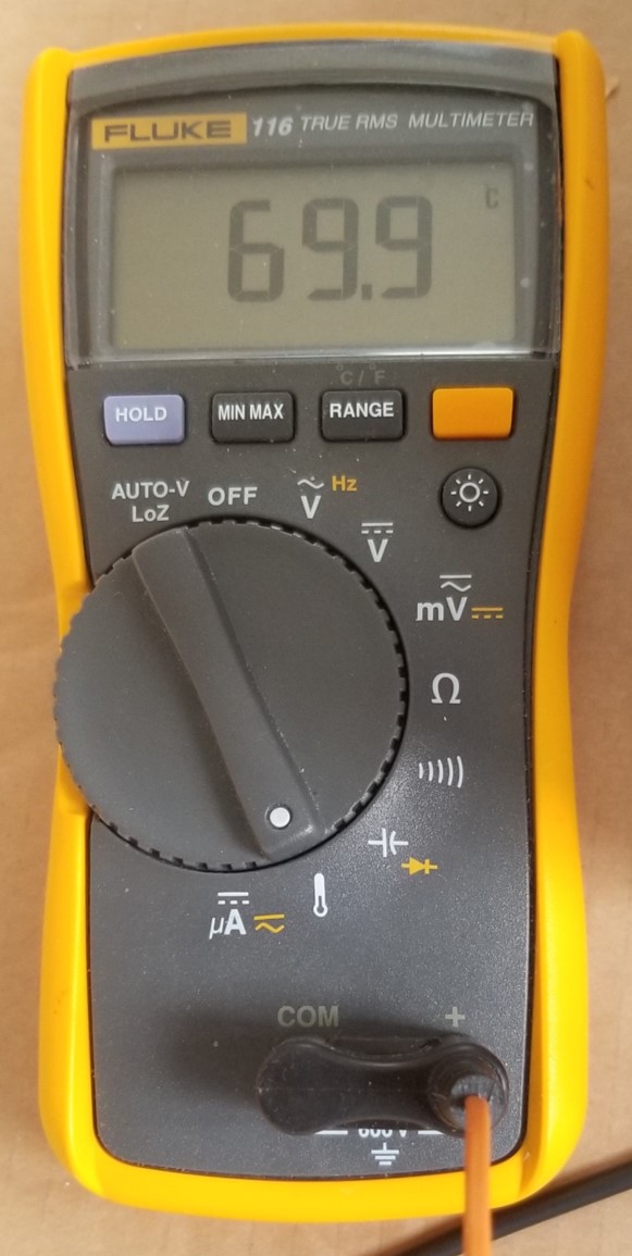

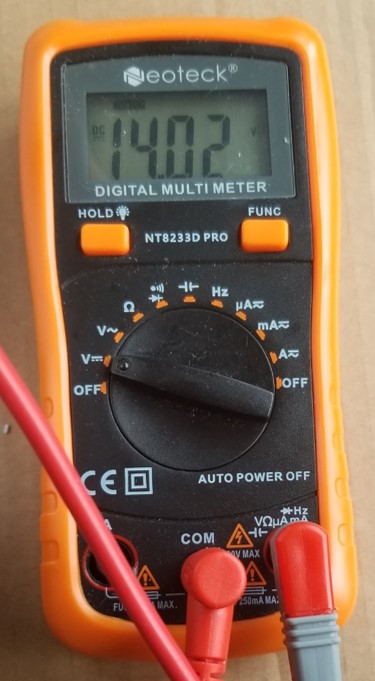

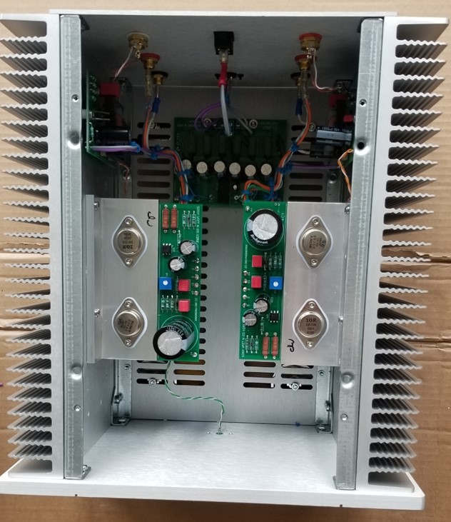

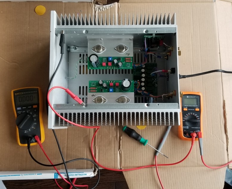

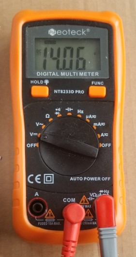

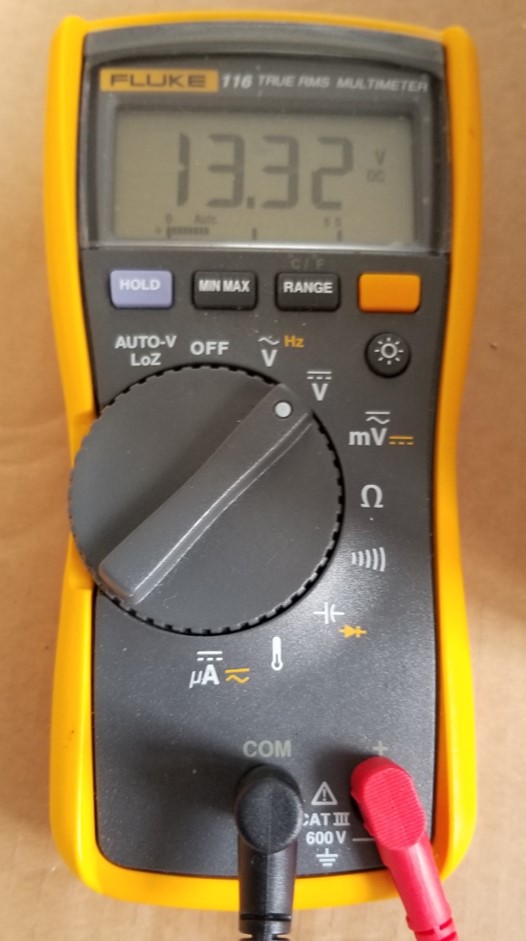

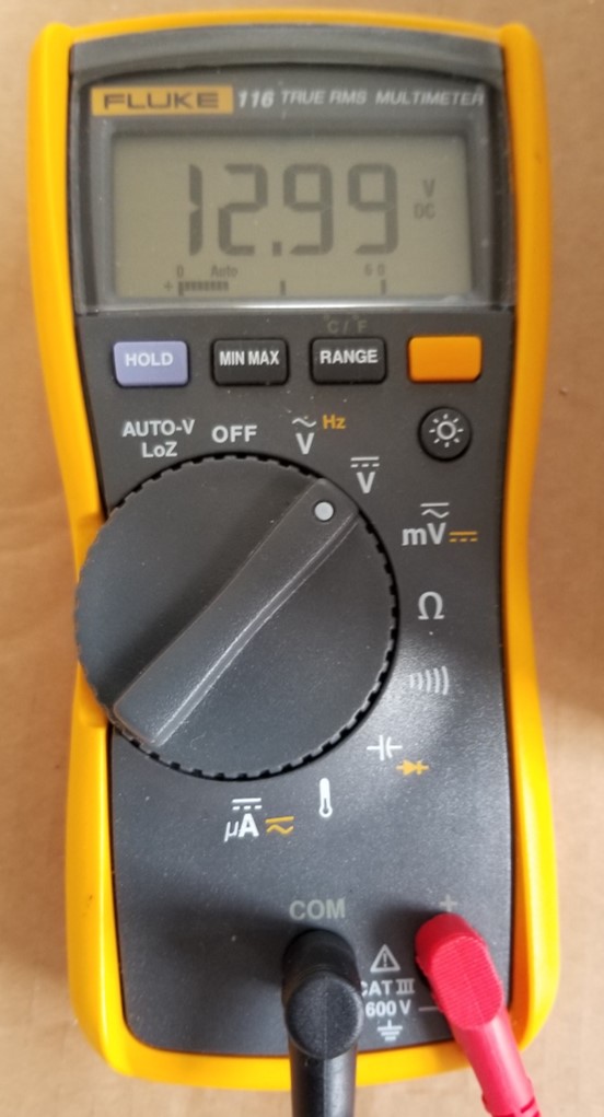

#184 is done and tested.
Everything is perfect.
Only the case temperature of two V-Fet reaches 70C (room temperature 24C).
I don't know if it is too high.

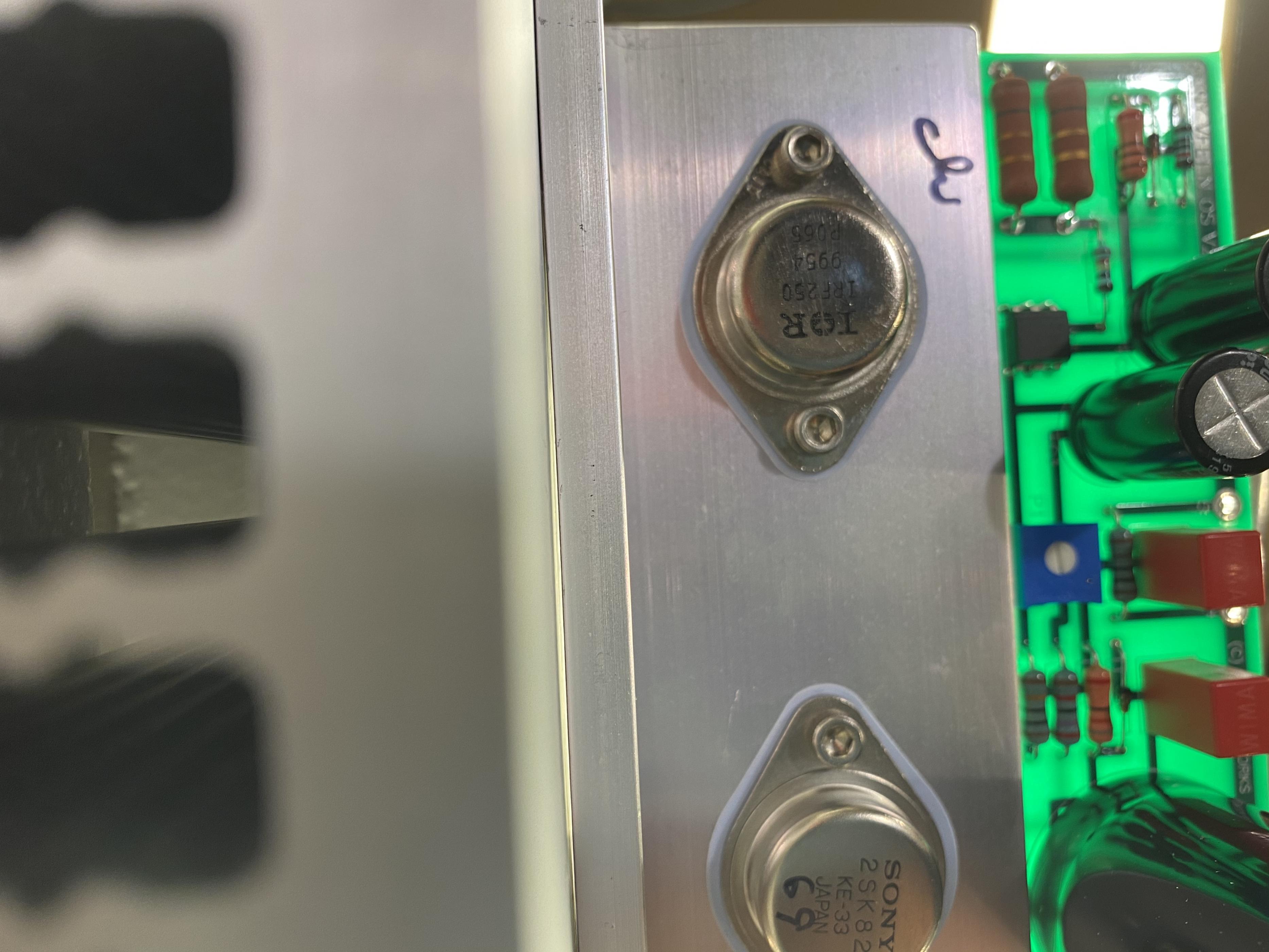

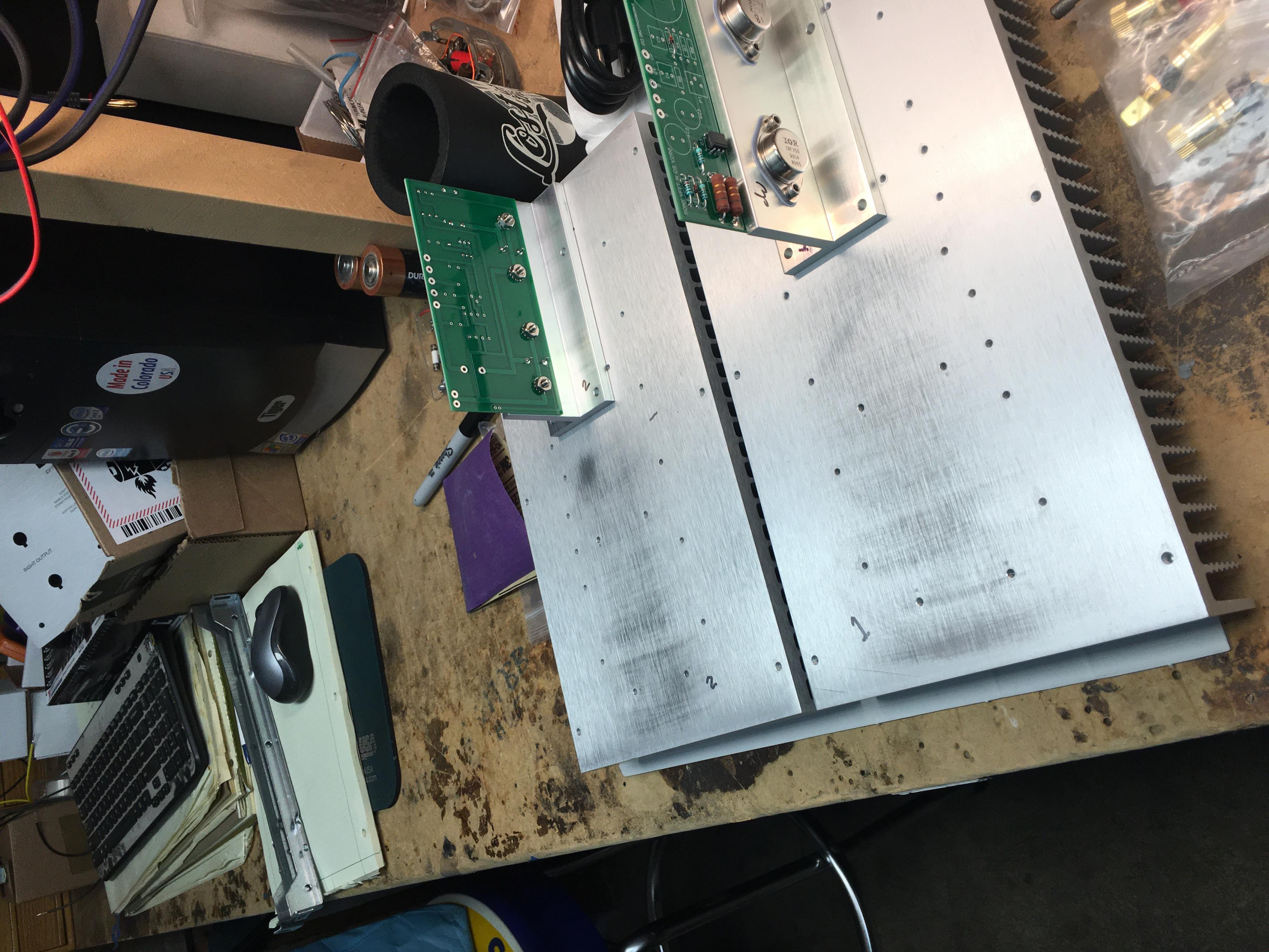

Device temperature has been brought up a few times with the P-channel builds and now N-channel. All amps are essentially the same, I wondered, why has there been a few higher temperature builds? So I mocked up my pair OS sections on the heatsinks. One channel had a slight see-saw action, the other channel felt solid if I tried rocking the OS. I took a close-up pick and you can see a slight space between the T-Bar and heatsink. I checked both surfaces for straightness, the heatsink has a minor wave in it. The wave trough just so happens to be right under the middle of the T-Bar. This situation could be the cause of some devices running hotter than others.
Back in post#58, Monk55 mentioned lapping-in the OS and sinks. Maybe not necessary for all, but definitely worth looking into. My situation looks a bit more involved, probably too much of a void for lapping.
Nice work Fellas
I lapped (sanded) my t bars and only the top and bottom edges touched the sanding bar at first. Took a while until I had contact on most of the surface. The middle half inch never touched the sander. I was moving the sander mostly vertical. If some one had a wave like Vunce and a hollow like mine they could be losing a lot of contact. My V-fets just reached 48 C after 1 1/2 hours.

The boards are looking great! Everything is already stuffed appart from the big caps on the output which will be upgraded with some Nichicon KG, and C2 on the front end which will be replace with some Nichicon KZ. And I have to say that I really like the nice finishing touch from the master![]()

Indeed the heatsinks have “flycutter” head marks. Here you can see after initial block sanding. Also, the T aluminum has ridges. Both should be knocked down with sanding block. Some may be just fine. I took more time to insure they were flat. 8 sq in is not a lot of contact so I wanted it all.
