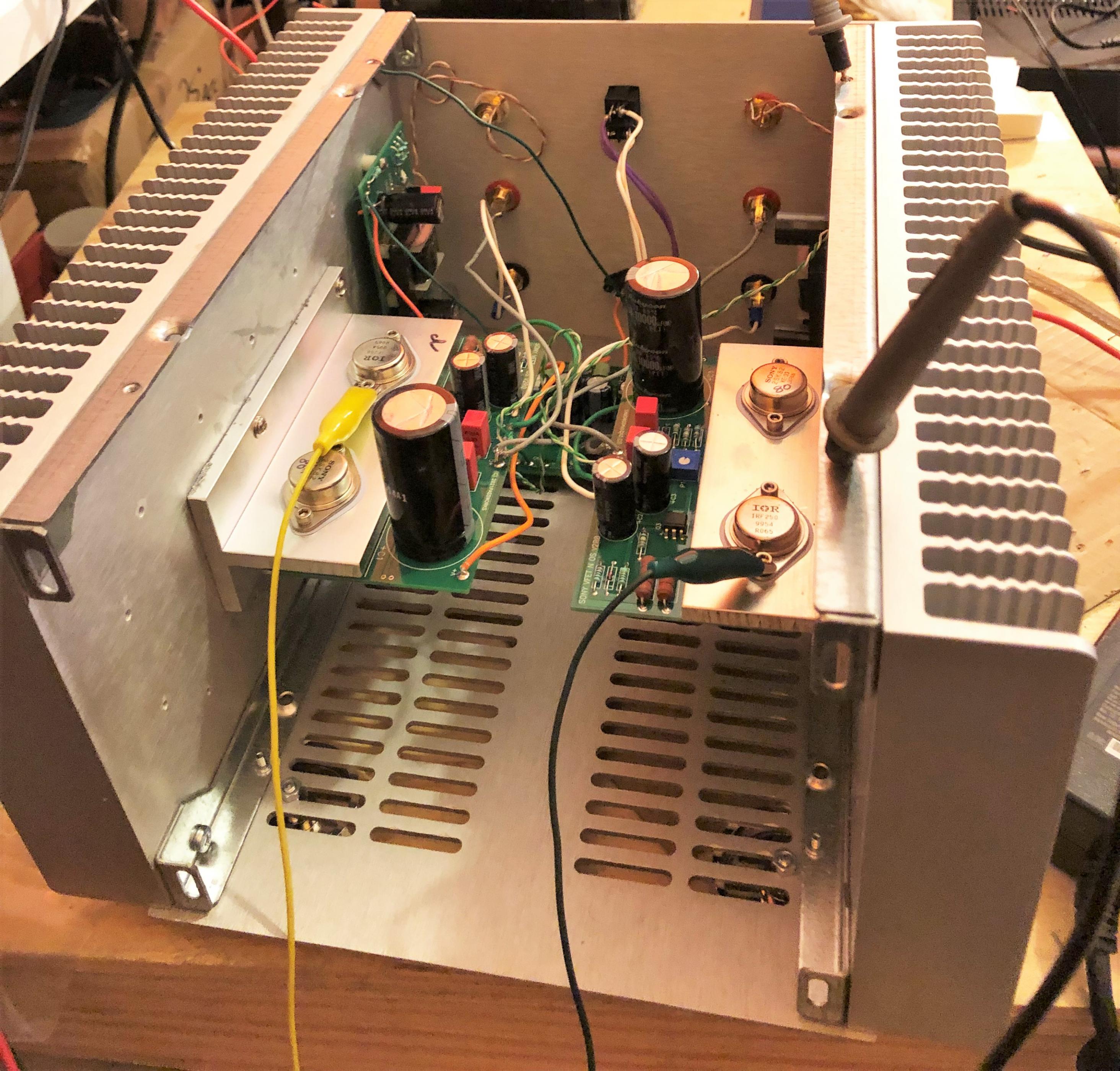

Up and running
Hello Chede,
stupid me, I soldered some wires to switch 2, but have only the one pole switch on hand. So the wires are waiting for the ordered switch to be connected. I didn' totaly get the function of this switch. While testing I shorted this wires for a short while but seems like, I didn't check properly. Now its shorted and the amplifer is up and running properly, problem solved thanks to your hint.

I was worried for you and your V-fets last night! Glad you sorted it out. I am also a bit nervous of understanding this switch. This should be VERY clear in a future illustrated build guide. Feel free to make a short one just about the switch. You took beautiful pictures that will help me a lot.

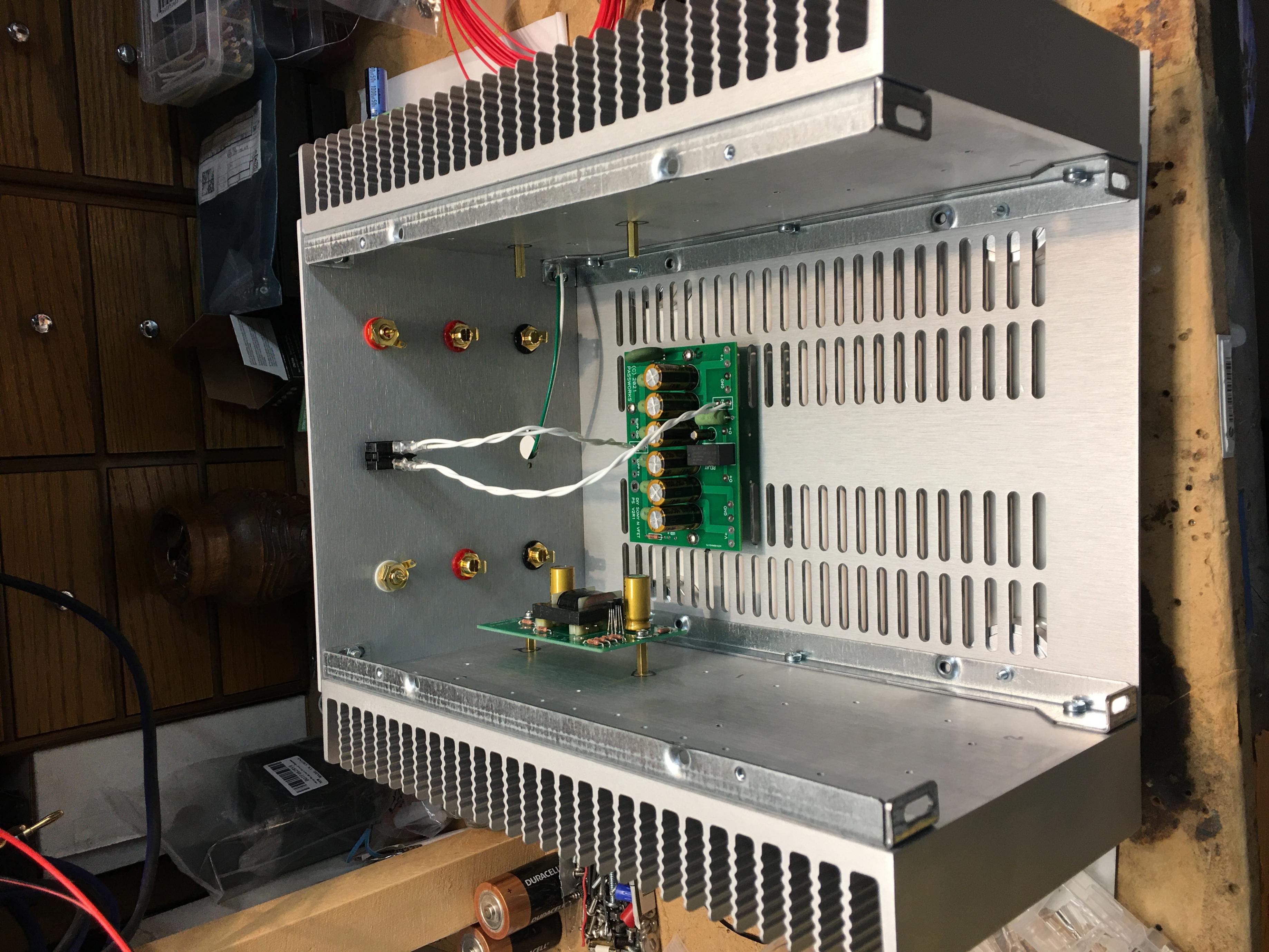

The VFET front end PCBs named Scourge, Bulwark, Marauder, and Dreadnought, all include two different ways to interconnect the board to the rest of the amplifier. Both Euro-style terminal block connectors, and also wire-soldered-to-PCB component holes, are provided. Some builders prefer the former, others prefer the latter. There's even room to use both at the same time, if that's what makes your heart sing.
