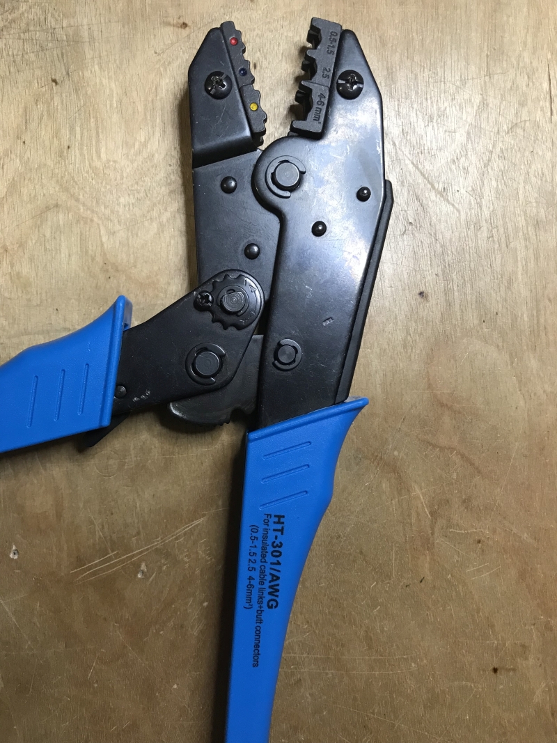

Are those MUNDORF 6.3G Female Blade Connectors?
What tool did you bought to crimp them?
Something of Knipex i guess.

Hi RainfallSky,
naa ... no need for fancy stuff, just standard quality connectors like these:

The die-based crimping tool I bought a long time ago, don't know where and how much it cost, but searching online for the inscription yields a number of hits with cost below 15 EUR. I was a bit surprised myself, because I thought I had paid more for it then ... This tool actually works very well - it is a lifetime investment.
After ten years of building amps, I did actually buy myself a Knipex Electronic Super Knips wire cutter ... and I like it very much
Regards, Claas

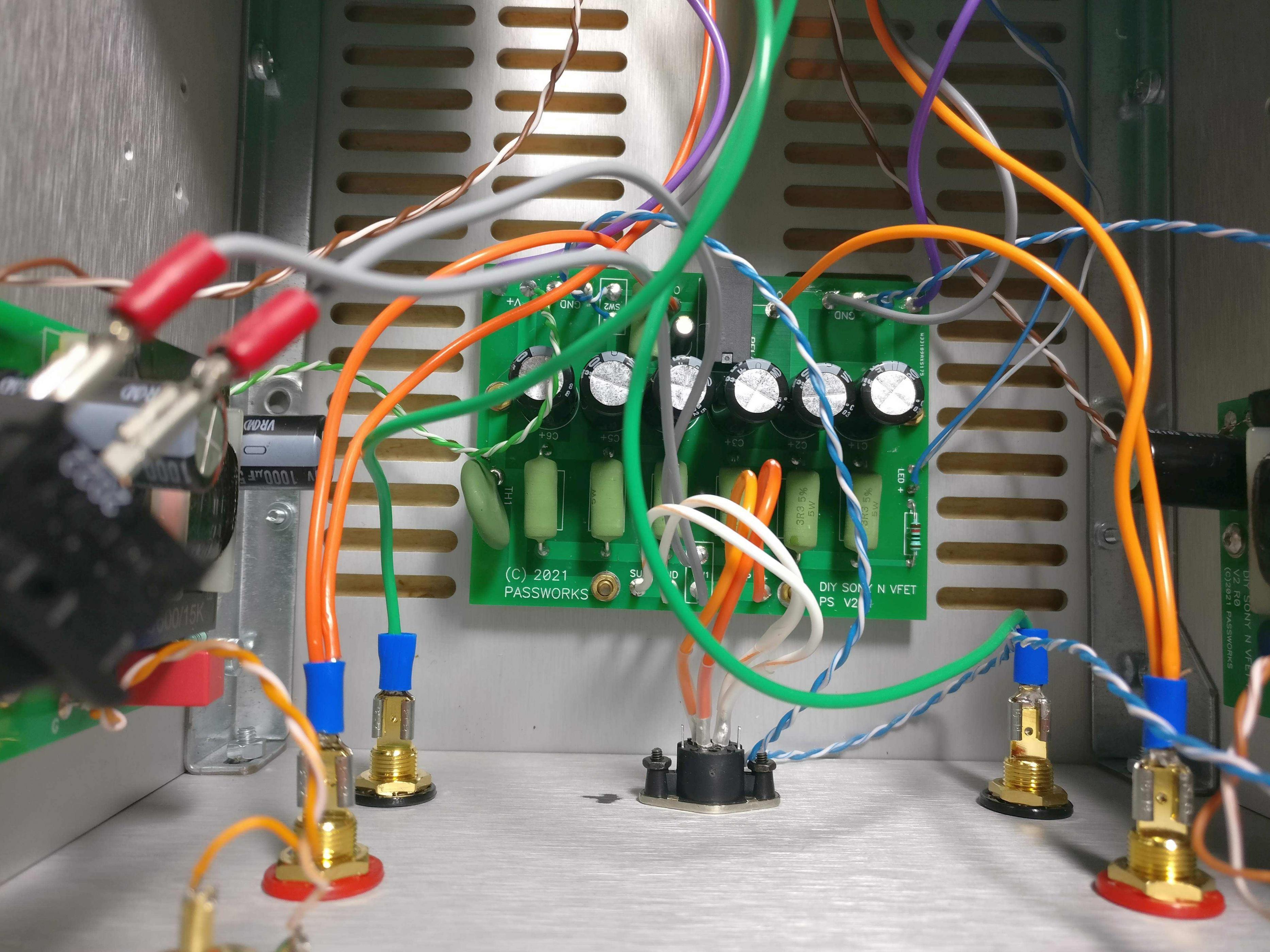

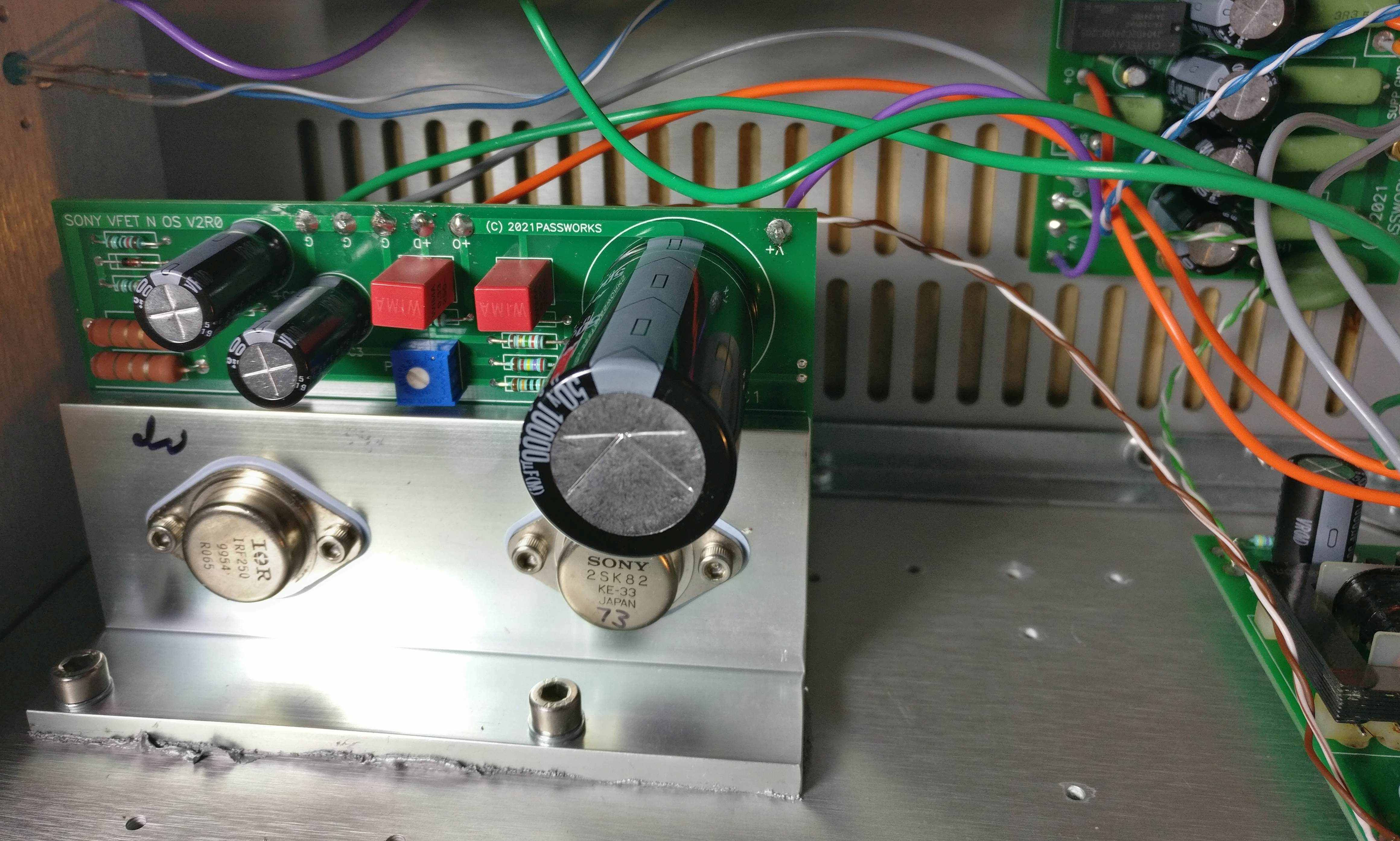

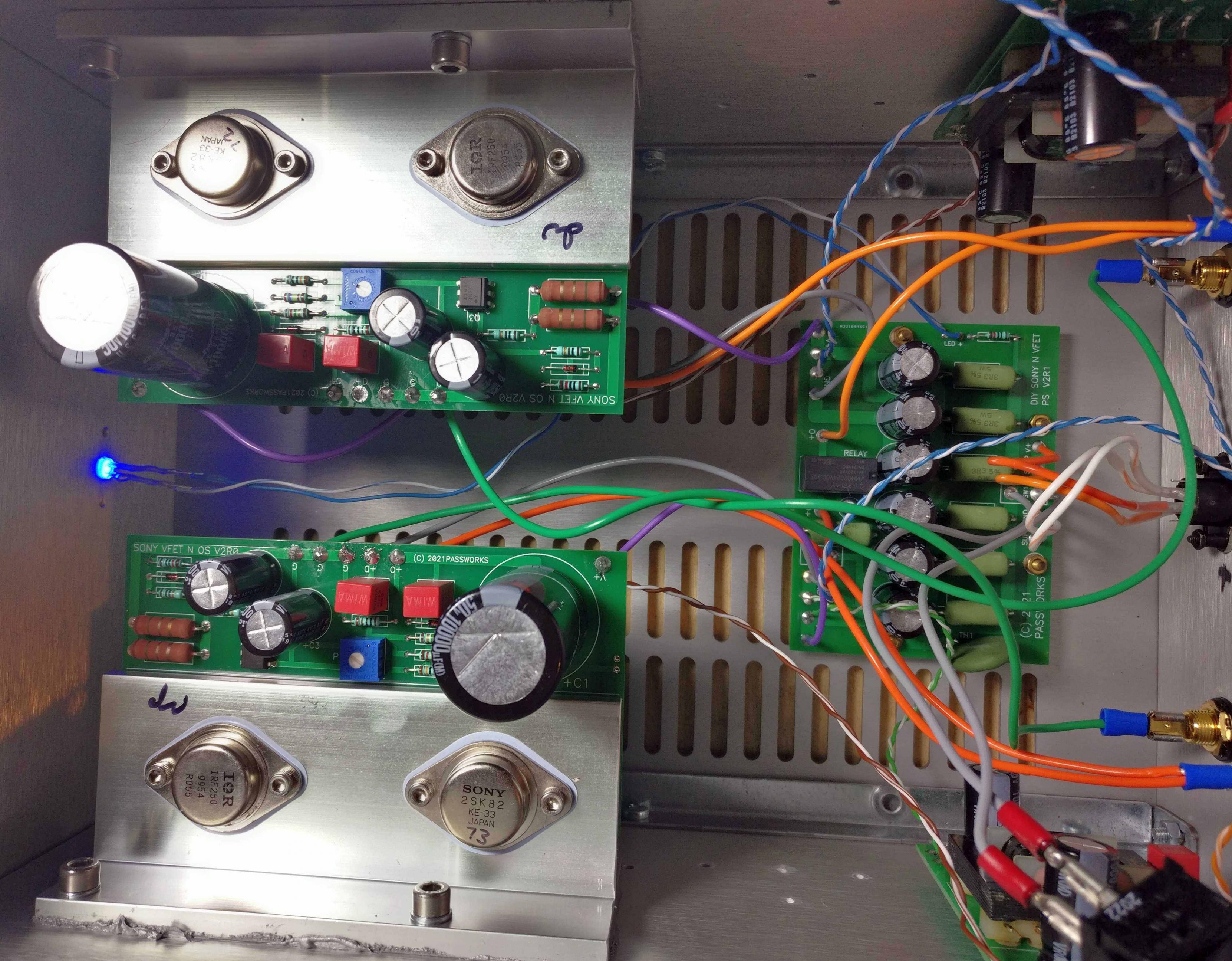

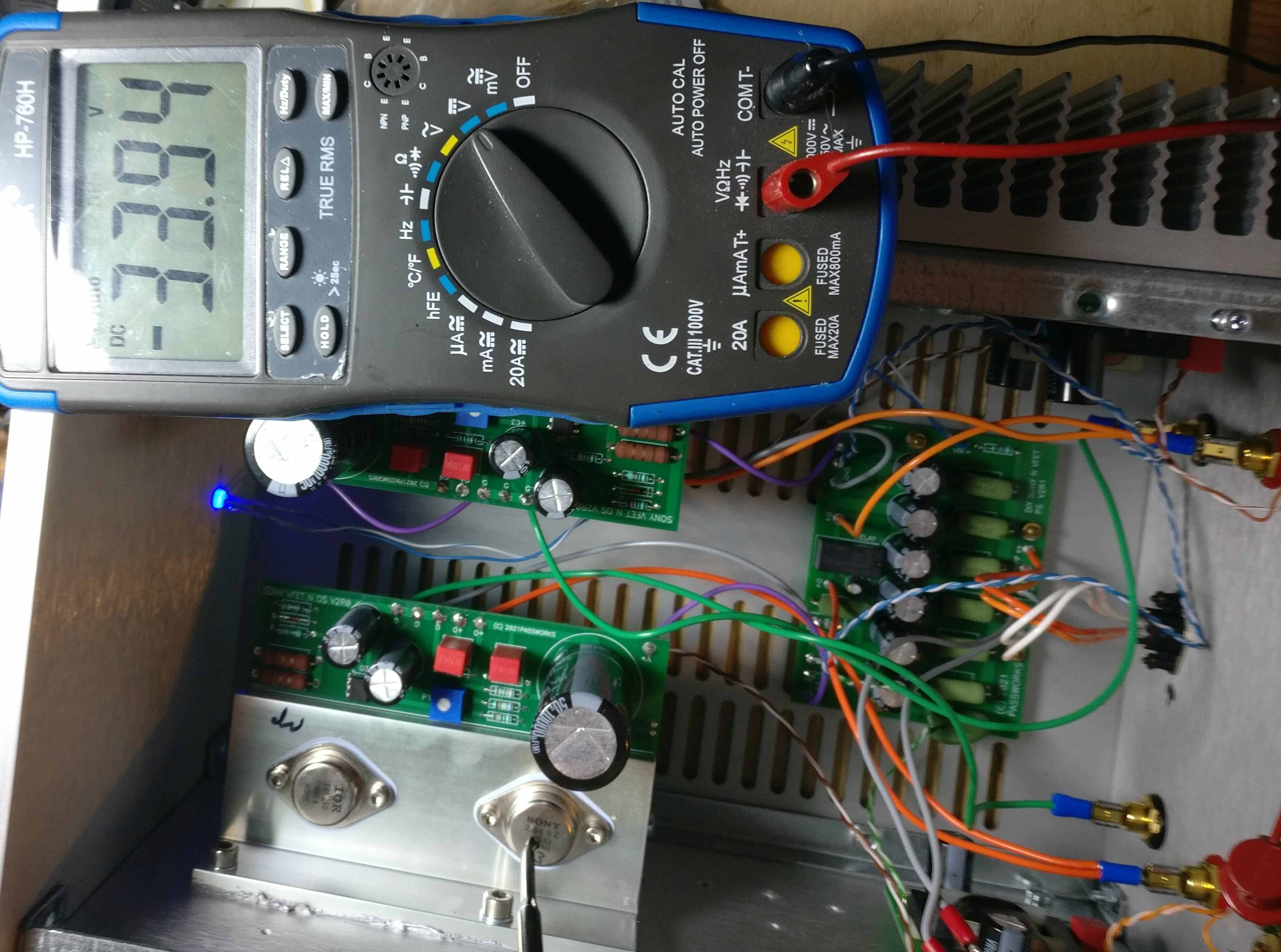

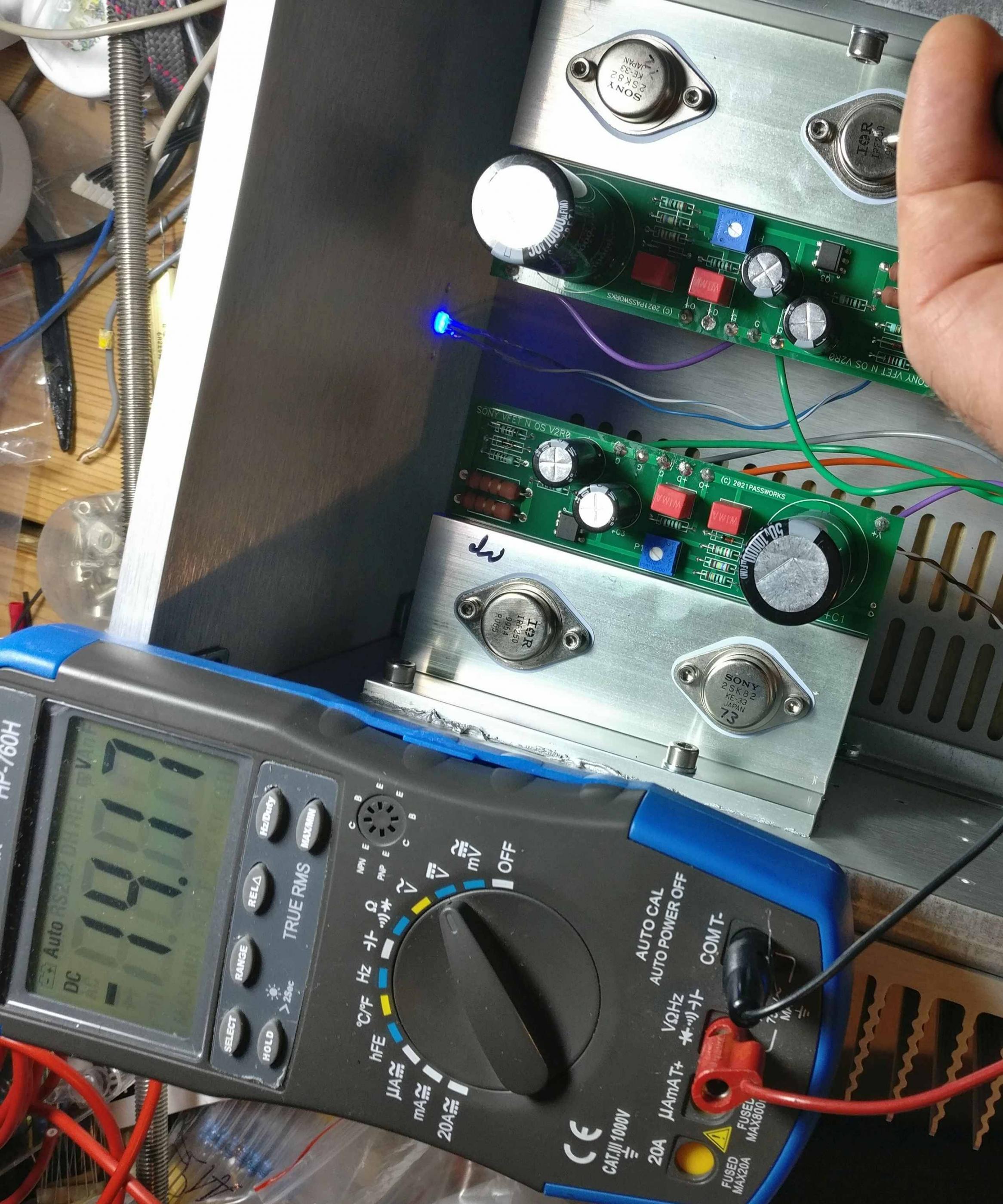

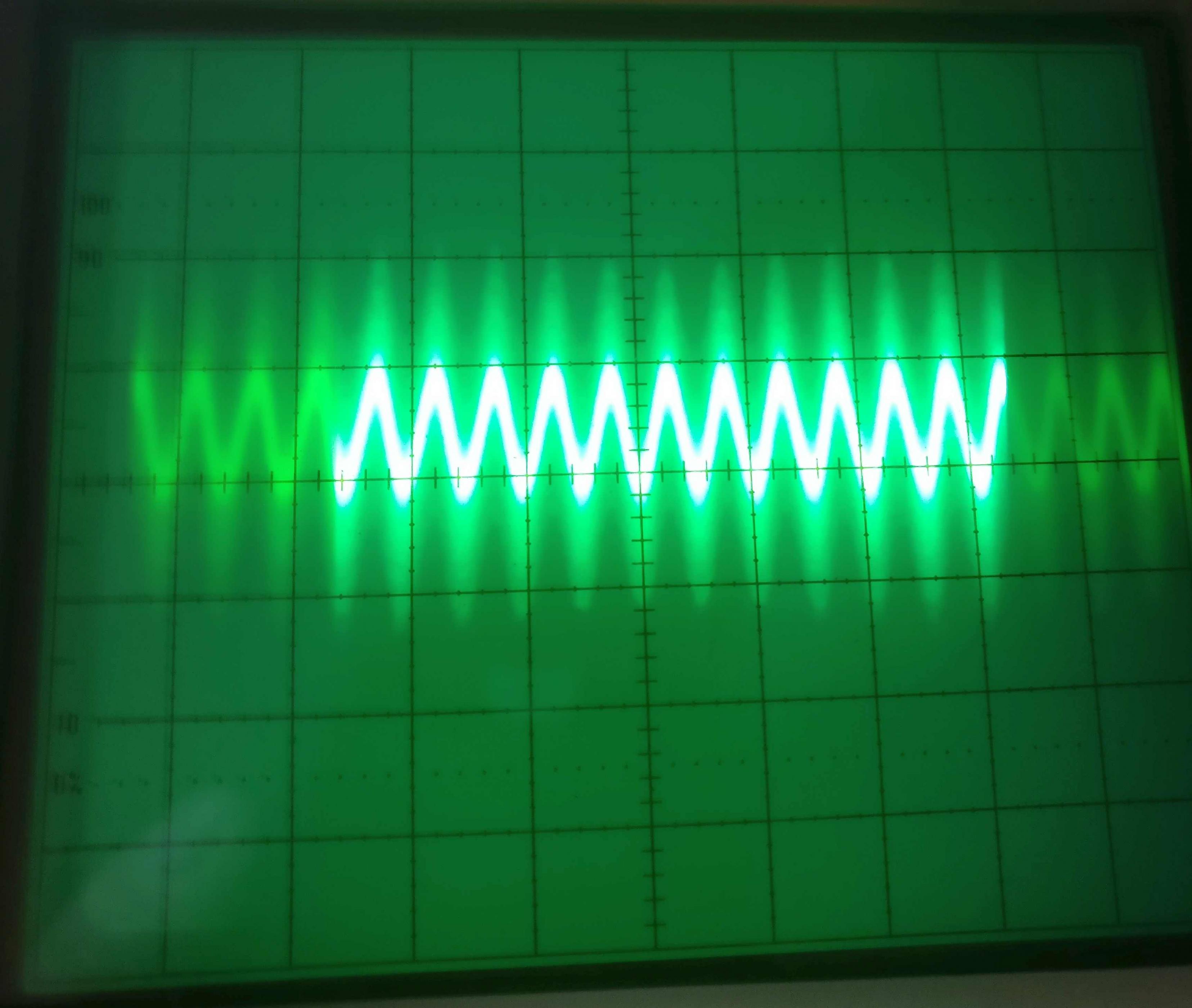

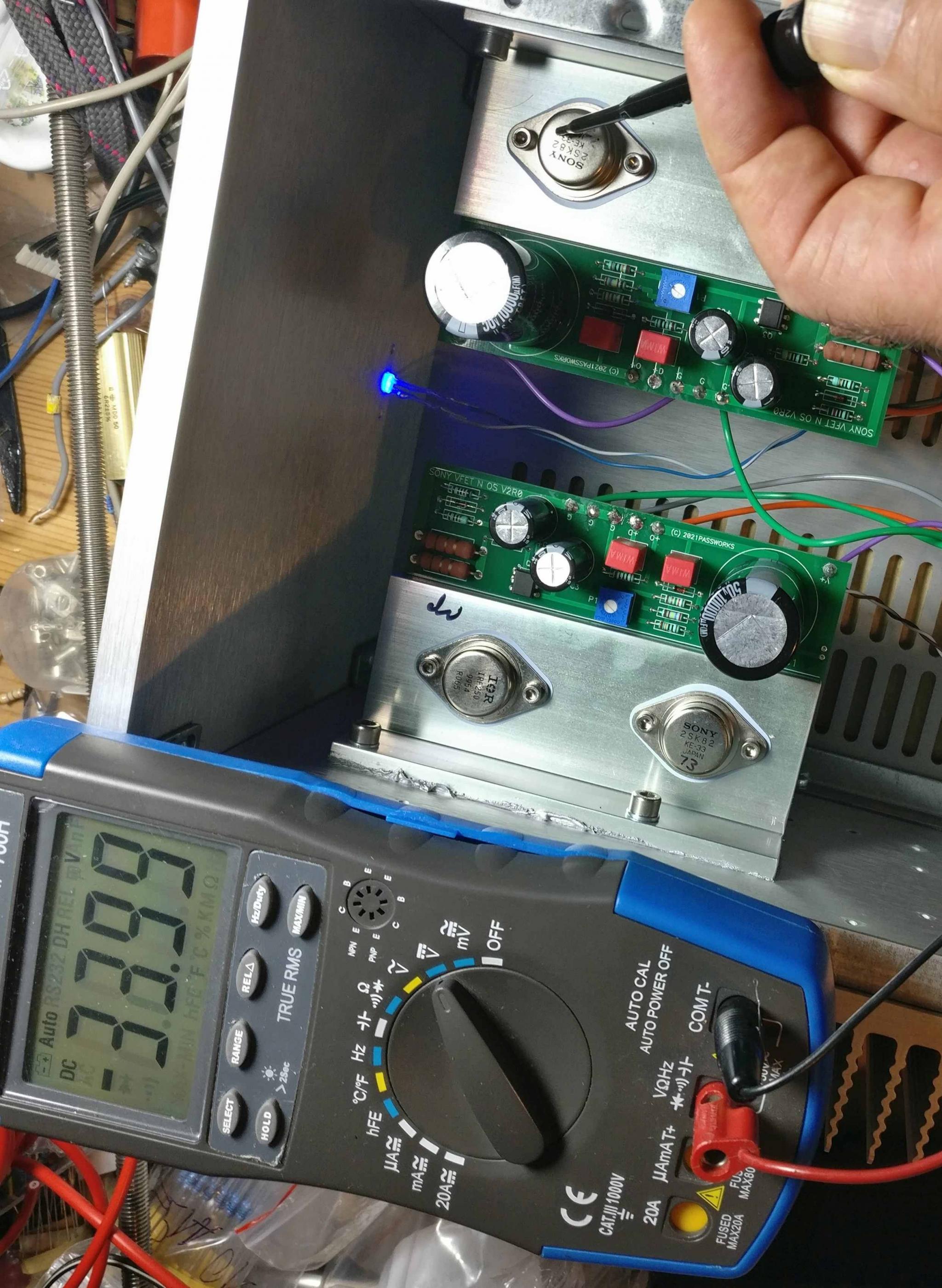

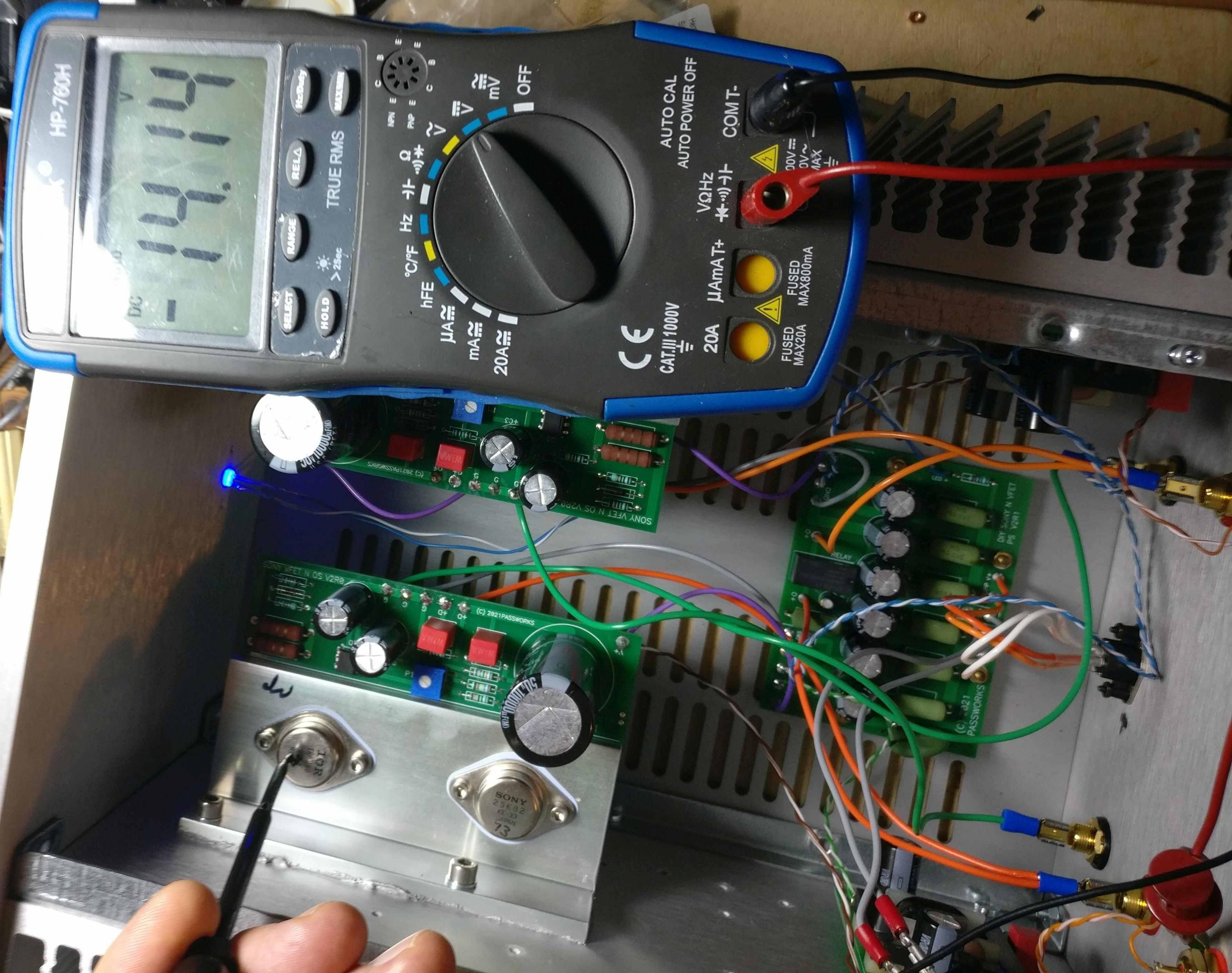

still not working
I still have problems with my amplifier. The preamps mesures quite nice, they give nice amplified signal on the input of the output stage. I took some more pictures, of the amp as well as of some measurements. One pictutere of the output signal. Any ideas?

Hallo Helmut,
I can't really see how your switch 2 is wired. Have you made sure that the relay engages and that the output does not inadvertently stay shorted when the amplifier is on ?
If it works correctly, you should have a resistance of 1 kOhm between speaker post hot and speaker post ground. Otherwise, and when the amp is off, it should be a short.
Let me compare resistors from your pictures with my build next ...
Regards, Claas
Regards, Claas
Hi HH,
Since your using the supplied SPST switch, check if your SW2 wiring is engaging the relay?
Whoopsie, Looks like Claas already brought this up. My snail speed messaging strikes again

I still have problems with my amplifier.. Any ideas?
Do you make with crimping tool strong pressure on the wires with spades who are connected to the speakers outputs ?
Try verify....with continuity tests if all wires have good connection between pcb and speakers outputs ?

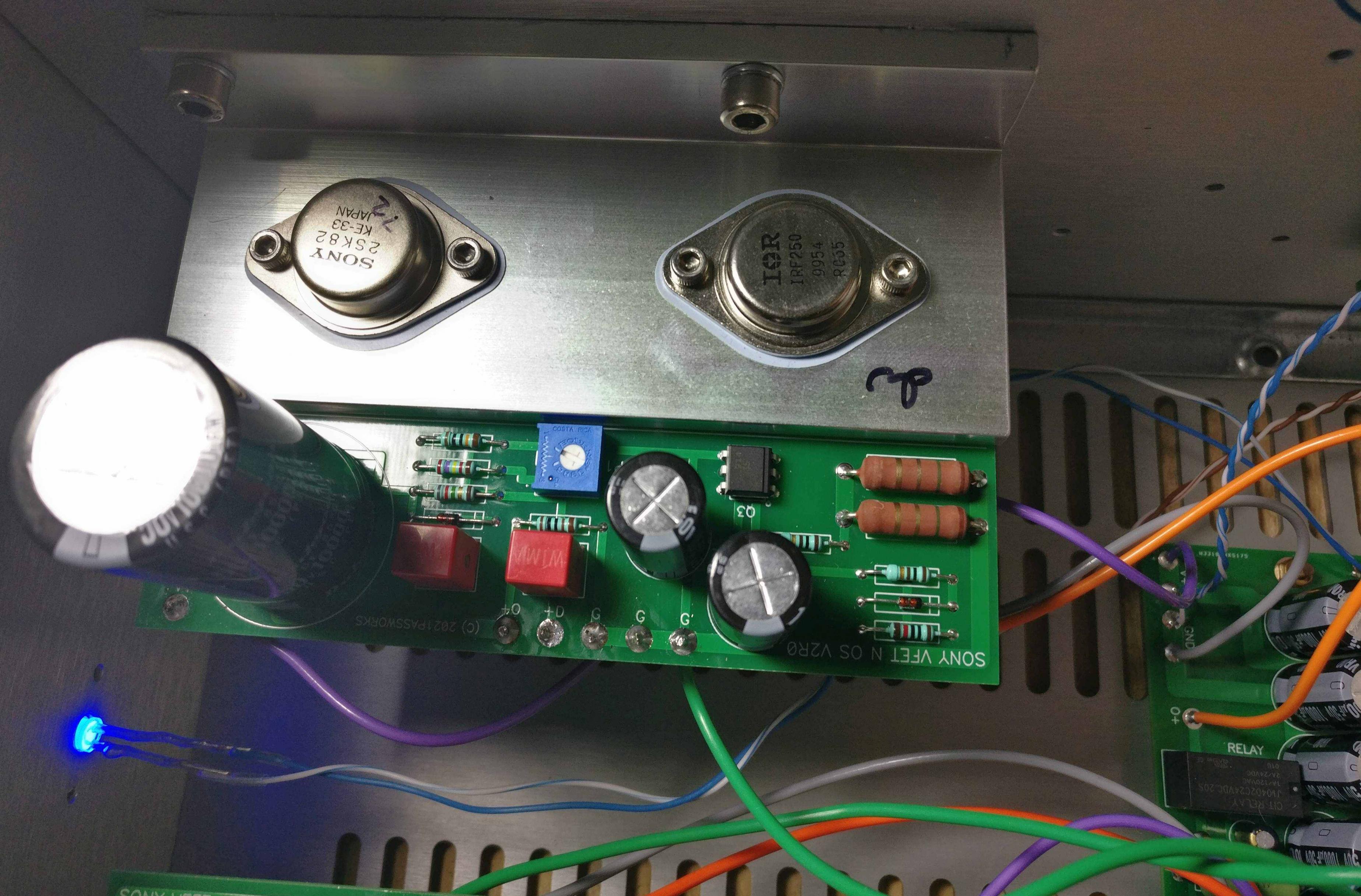

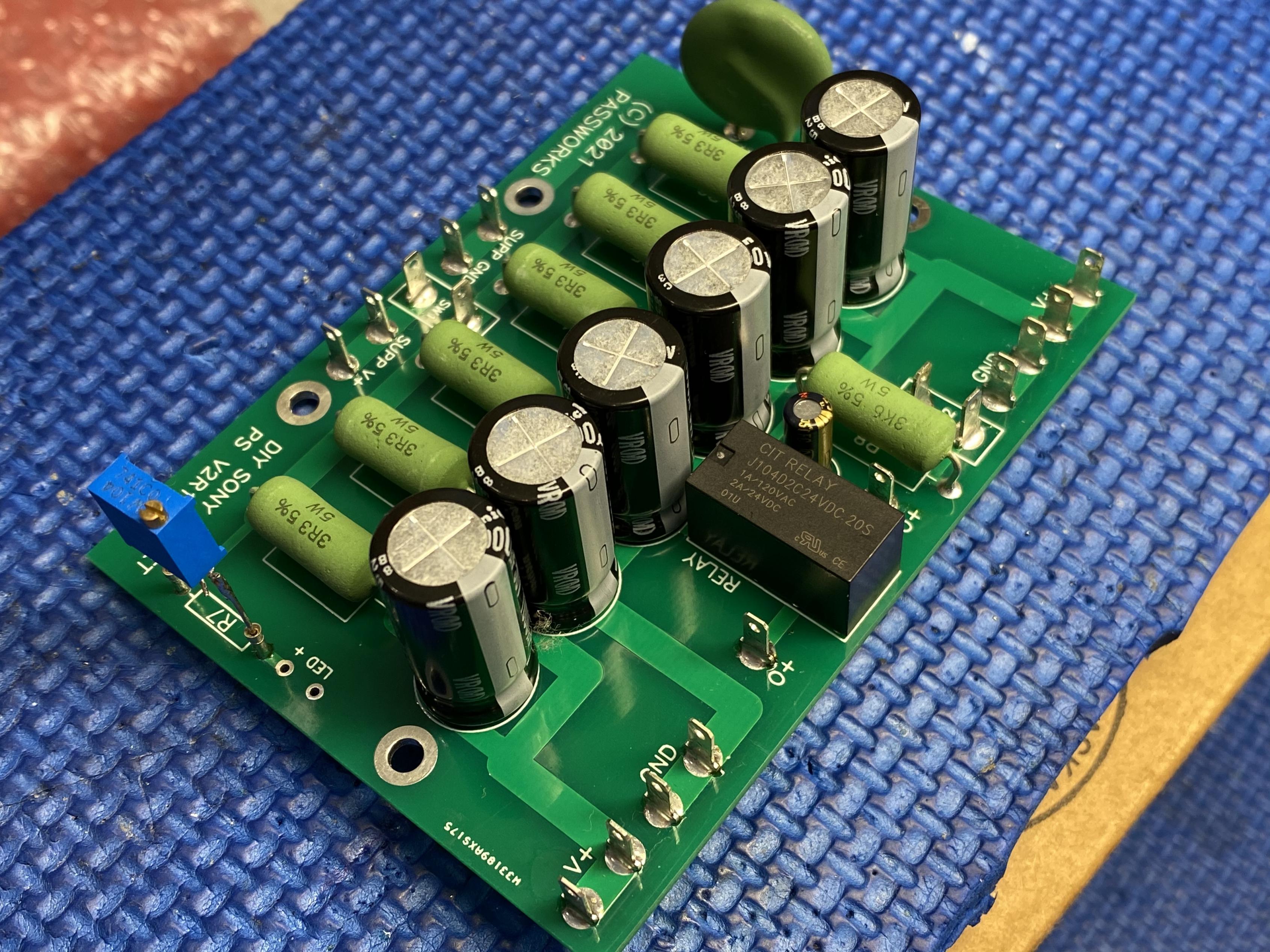

The trimpot is temporary so I can “dial in” the LED brightness. Then measure and replace with fixed resistor.
Hi Vunce,
Could you please let me know the part# for those temporary female connectors which the trimpot is sitting on?
