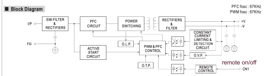

The Switch Mode Power Supply which Nelson has chosen for the VFET amplifier family, is the Mean Well GST160A36-R7B. It is sold by lots of electronics distributor houses, such as Mouser and DigiKey, and is also available from the diyAudio Store (sales link). Since it's a Switch Mode power supply, builders almost always choose to install a noise-removing filter between the supply and the amplifier.
One possibility is to install a PAIR of the PO89ZB filter boards sold in the Store (here). One board per channel, which lets you stay comfortably and safely below the 3 ampere max current spec of the filter. Each channel draws less than 2 amperes, and 2 is certainly smaller than the 3 ampere max spec.
Another possibility is to install a single THESEUS-PSFILT board, from the mechanically and electrically compatible Ship Of Theseus project. THESEUS-PSFILT contains two SMPS filters on a single PCB, one for Left and the other for Right, providing additional channel isolation and separation. THESEUS-PSFILT also includes a fancy turn-on / turn-off "thump" suppression relay, similar to (but more elaborate than) the Nchannel VFET amp's filter, sold last year by lottery. Here are the schematics and PCB manufacturing Gerber files for the PSFILT: (link)
