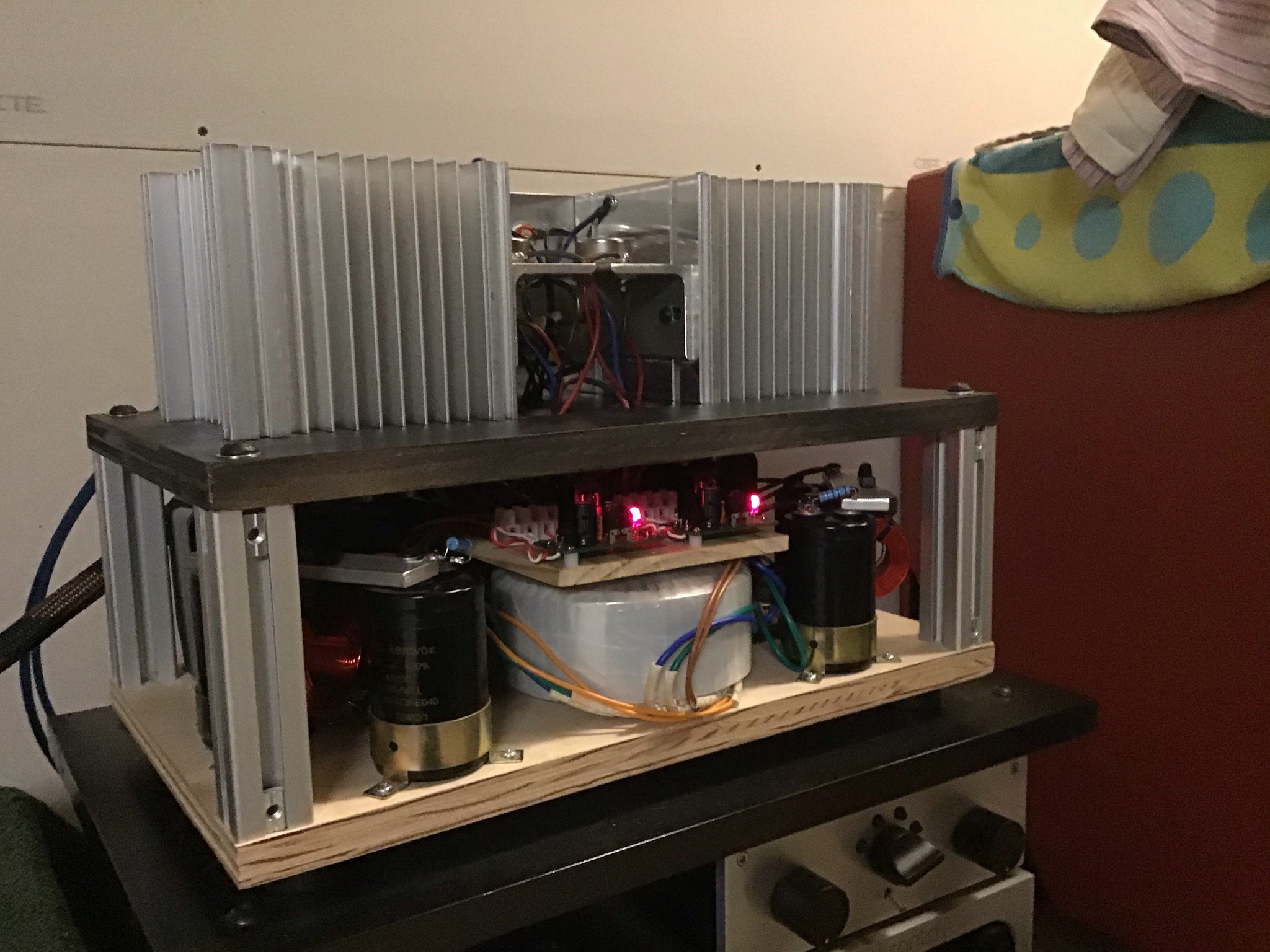

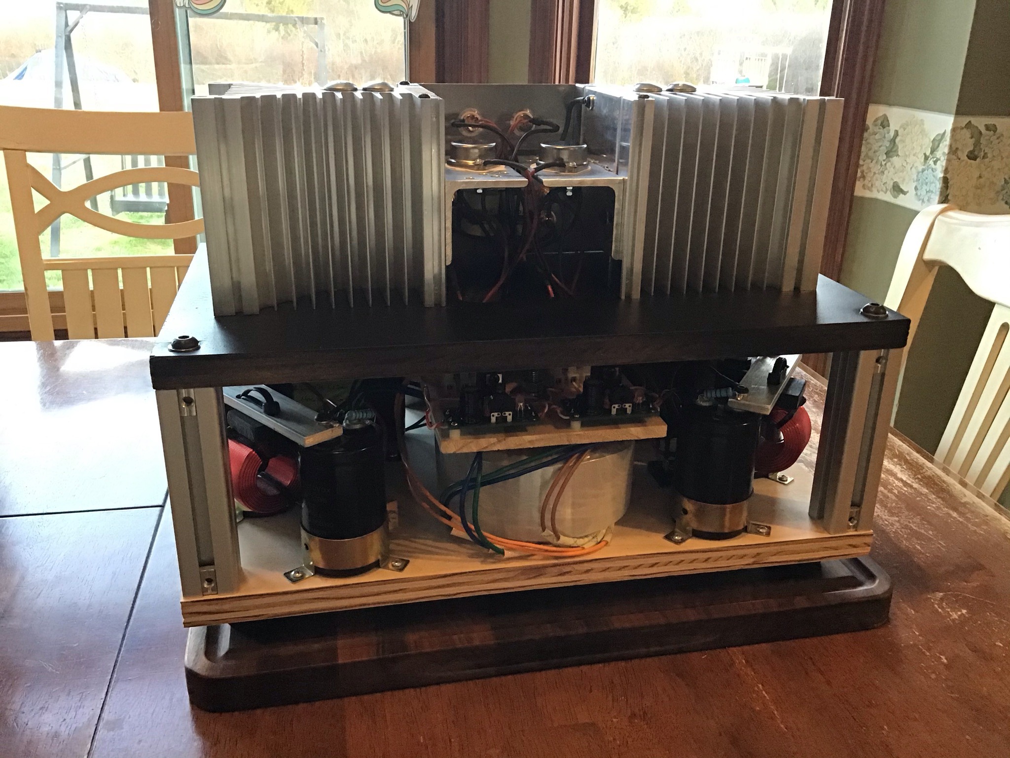

here is my 2sk180 choke loaded follower. I probably have less than $50 into the enclosure.. Heat sink was the most expensive part. Wood is easy to work with. I am going to cover it with wood. You can find heatsinks with the t-03 holes in them. I know it looks ugly but I love the sound.Most of my chassis have come from Aliexpress either direct or via ebay; freight costs from China are fierce, but you can occasionally find end-of-line/warehouse clearance items at attractive prices. As Zen Mod has mentioned more than once, if you place your output devices carefully or mount them on a bracket you can use long bolts in between the heatsink fins, which makes tapping threads unnecessary. I've read of people re-purposing the chassis from a dead commercial amp but never managed to find anything suitable myself. Don't give up - my VFET is my favorite amp by far.

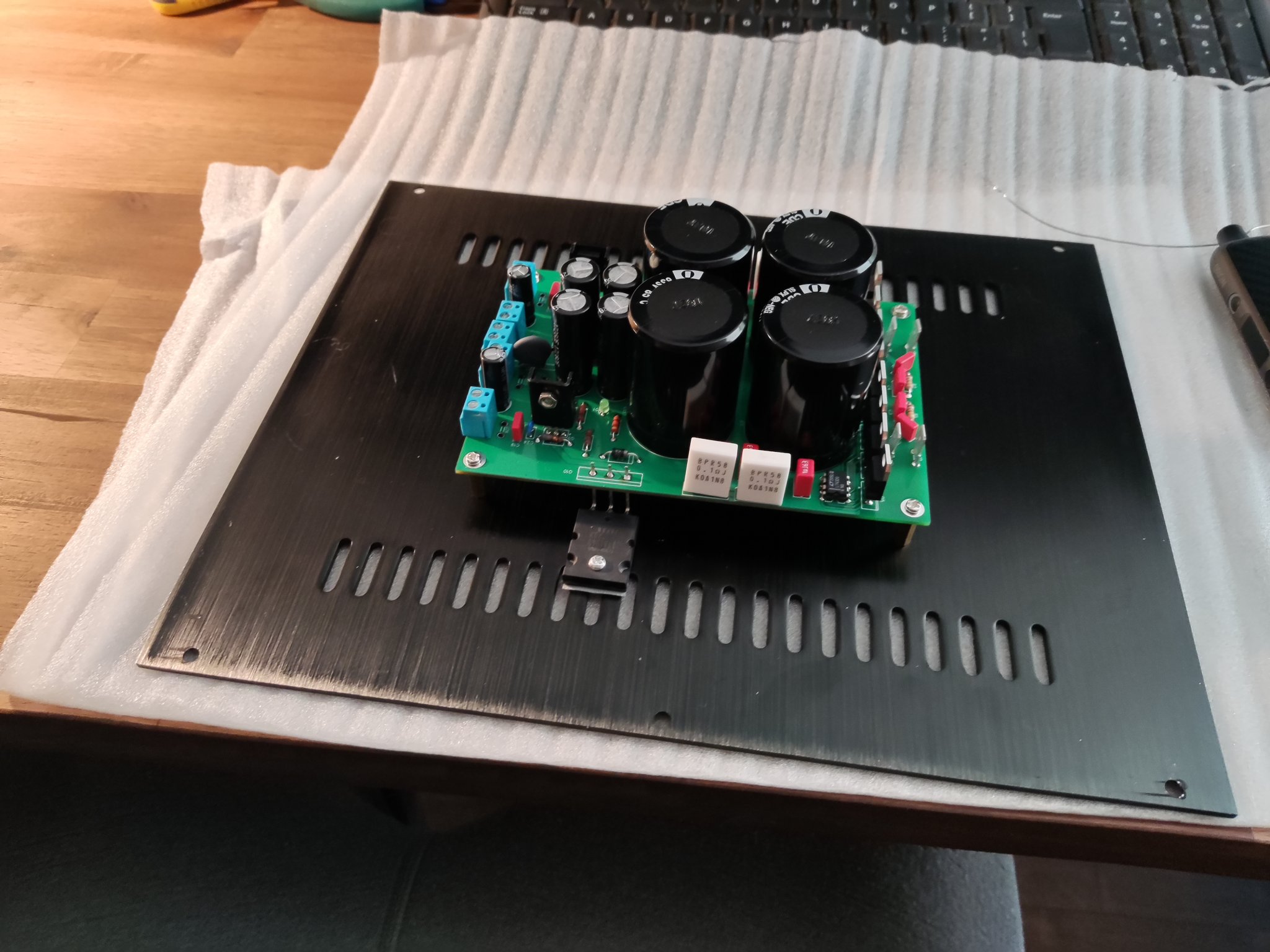

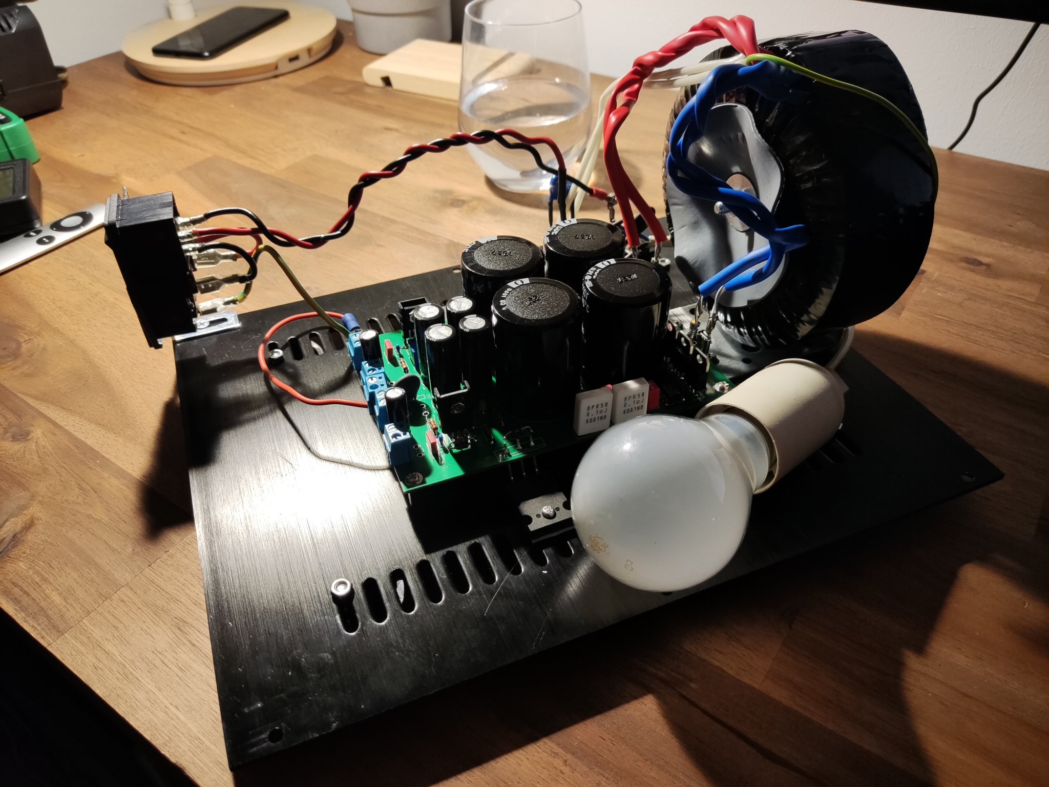

I am using the same heatsinks for SissySIT and that works fine. The narrower chassis does make for a tighter fit with a transformer and in my case SLB psu. If you are using T-brackets, only an external PSU (smps or linear) would work, as I don't see how one would mount the transformer.

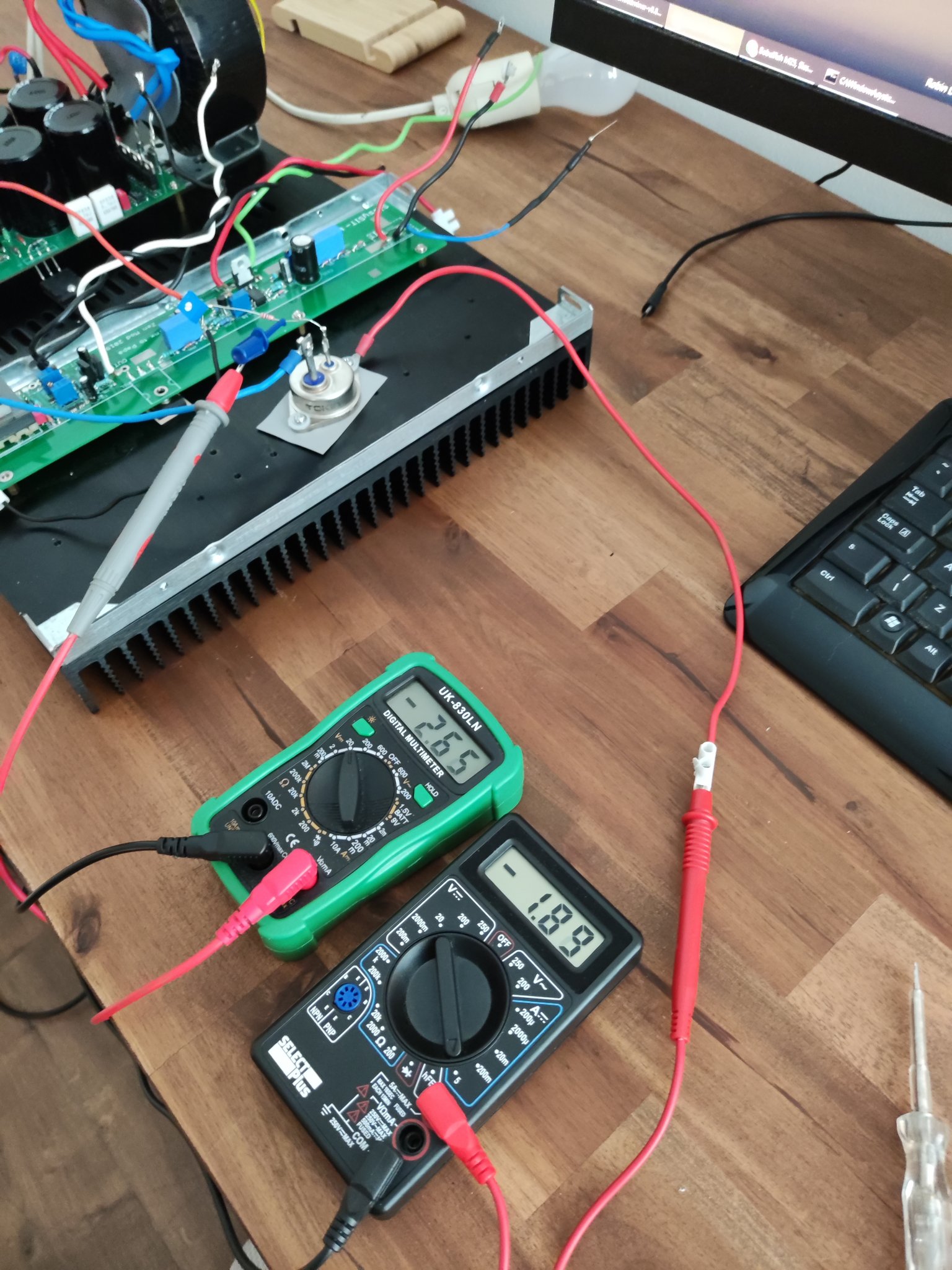

I believe I left it at 160mv so 1A6. Soon to test with new MOSFETs as I screwed up massively when moving to the smaller footprint chassis (install flying lead resistor without jumpering it's position on board). The width is 2cm wider as the Modushop VFET chassis.Haven’t seen your layout (or more likely I forgot) 😀
