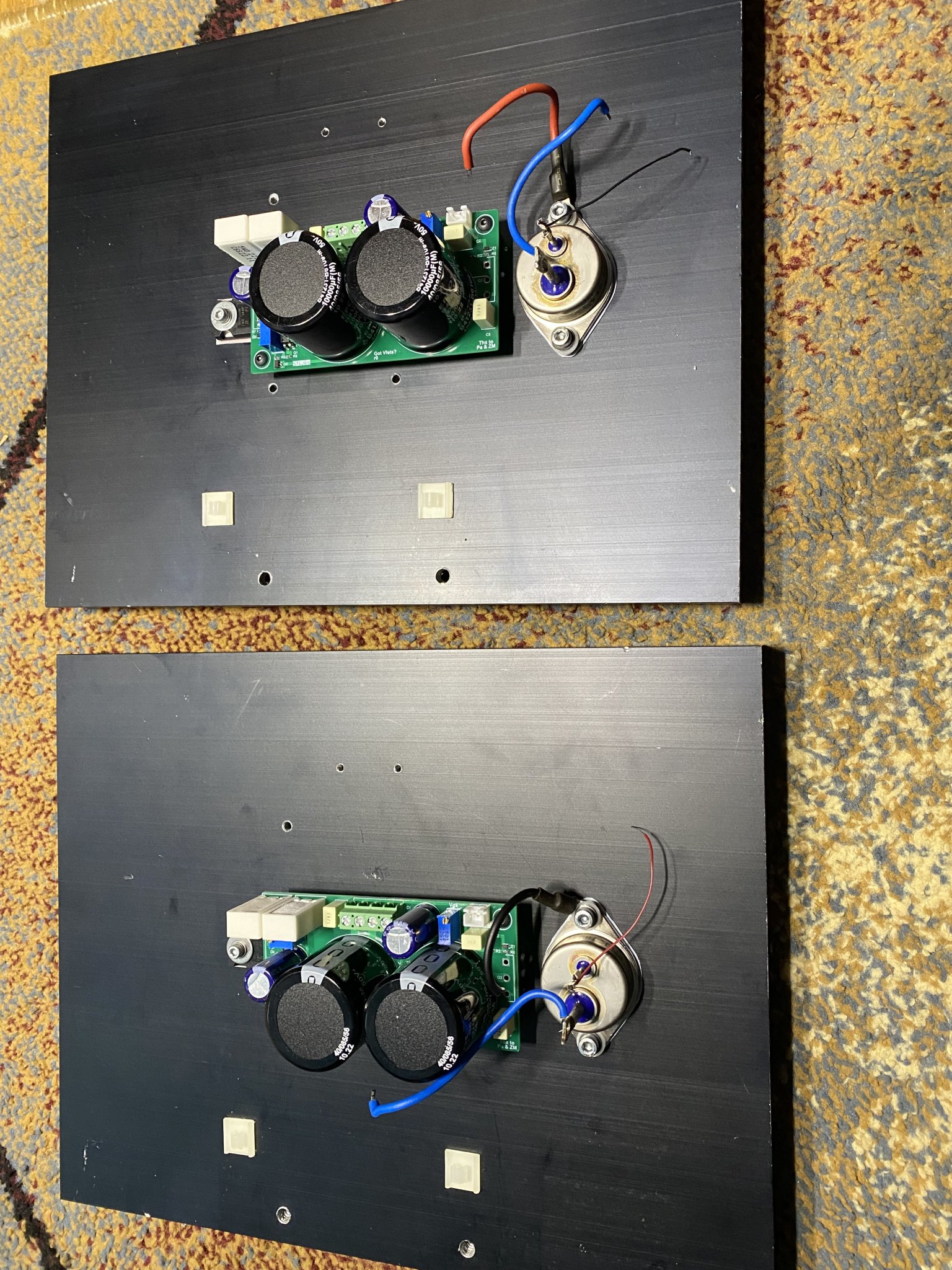

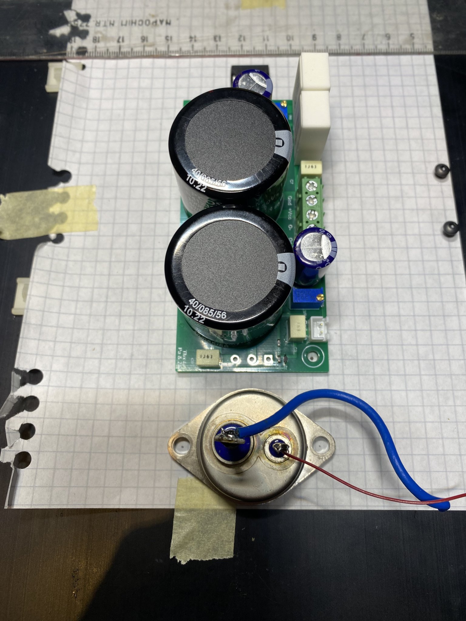

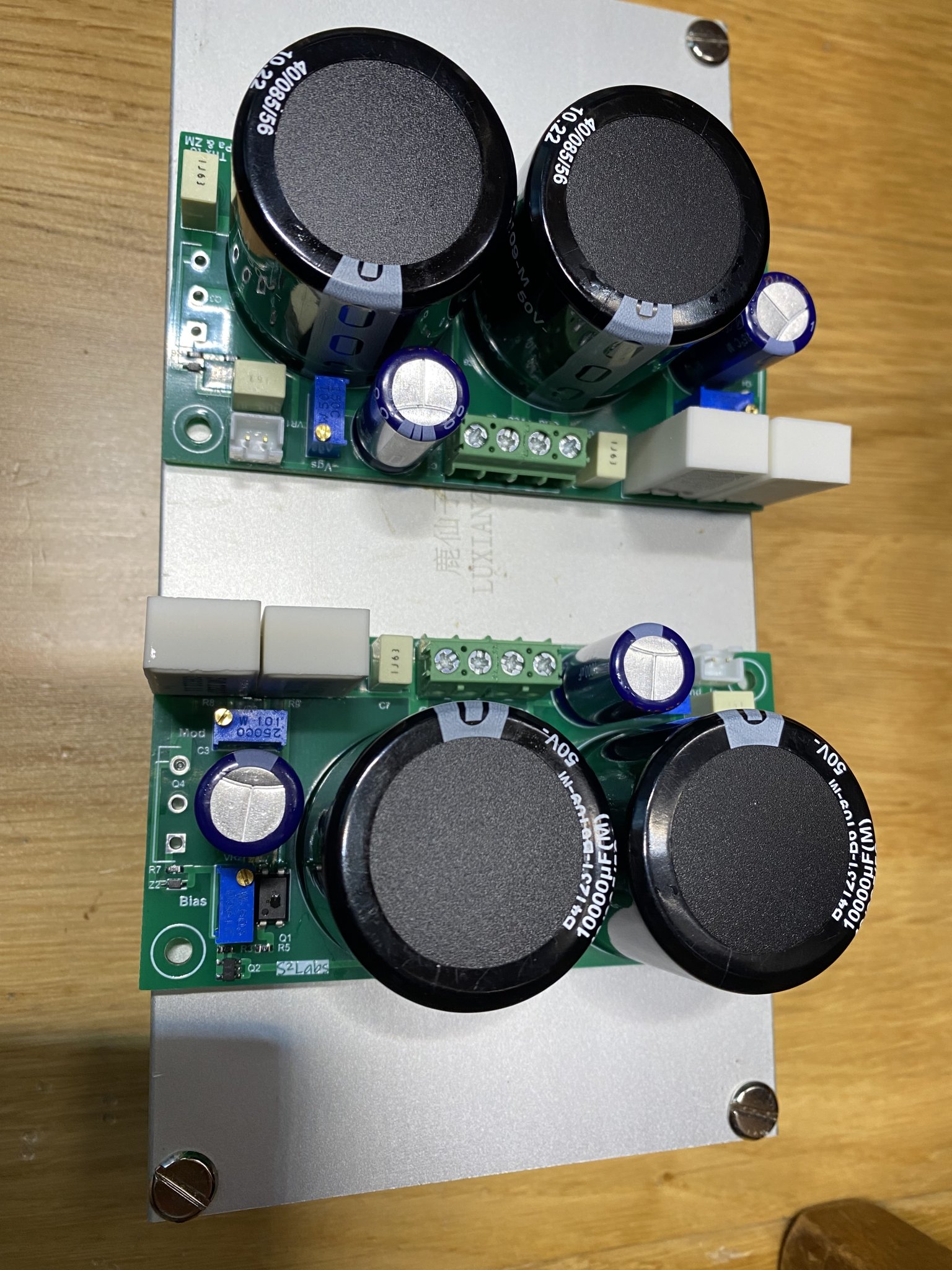

DIY SONY VFETS pt 3 - Got VFETs?

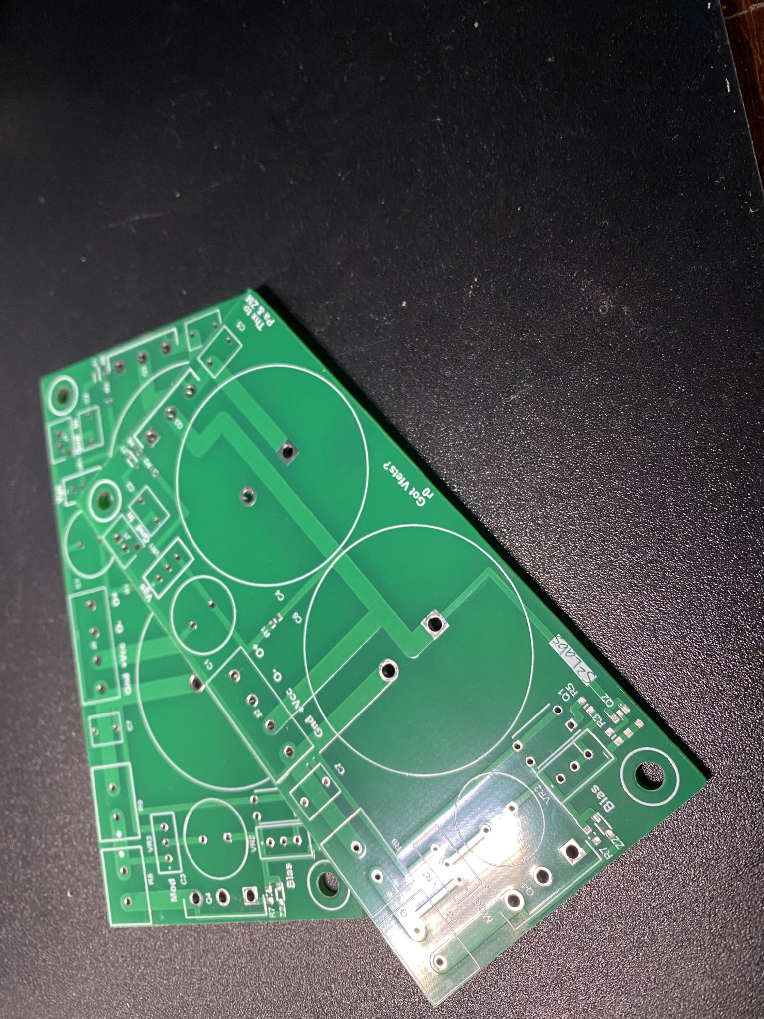

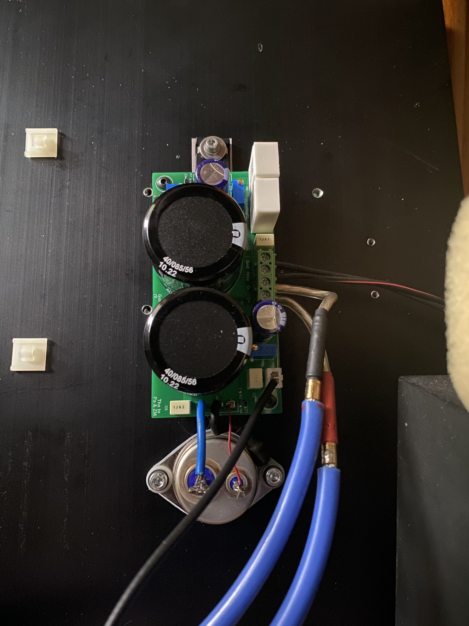

Now it’s time to replace the prototype with the final pcb obviously after drilling and tapping the final holes 🕳️
Once all is working I will share the gerbers for those that don’t mind soldering a few smd parts.

I had an AJ for 10 years. I liked it’s sound very much but in the end I decided to replace it with the excuse that for nowadays electricity prices it was drawing too much current.(the aleph was drawing 200w/channel)
So for one year I played with the output stage of the xa252 and then built the complete amp.
Not long after finishing the xa252 I wanted to hear how those vfets sound that I stashed for years.
Well… even if they give higher thd compared to the xa252, since I built the vfet follower the xa252 was turned on a few times and not for long. I use it only when high power is needed but it seems it’s never needed. For my listening levels 5w it’s already very loud.
One thing that I like about the vfet amp is that when driven to high levels and it starts to clip it does it very softly compared to the xa252.

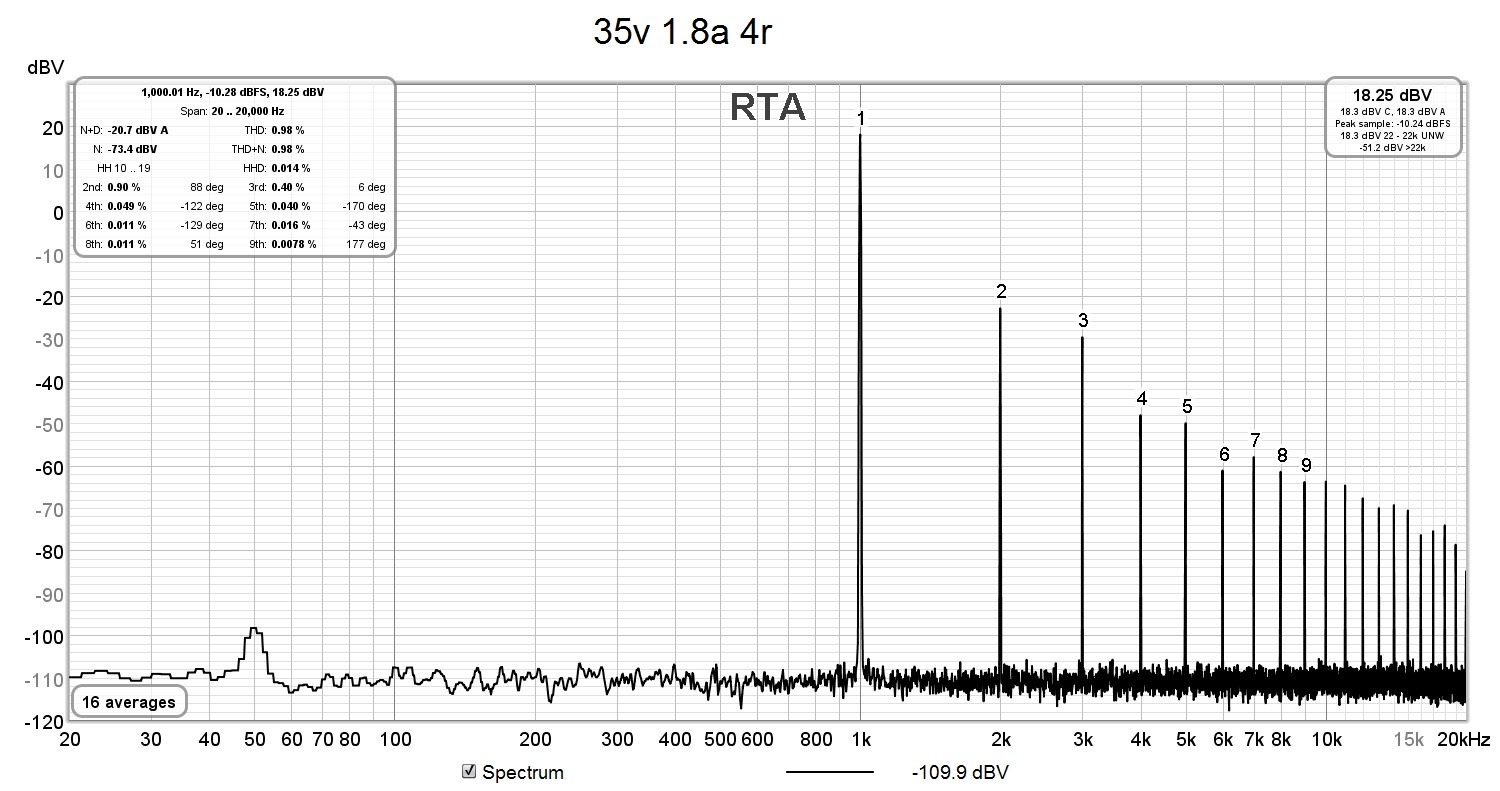

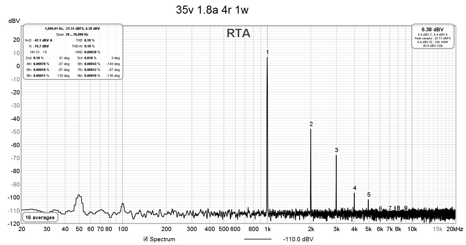

Another thing that I like is that I can set its power supply voltage depending on how loud I plan to listen and also depending on how much thd I want. For example at 17v it gives 1% thd into 1w/4r, for 24v it goes to 3w/4r and 1%, for 30v it gives 1% at 6w/4r the values being close into 8r too.

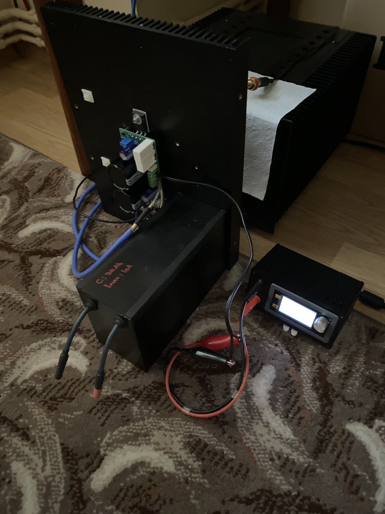

I am using a buck boost converter to power up each channel.
Except the vfets the rest of the amp is cheap to build so if you have them it’s a shame not to build it.
But wait… the pcb supports also a mosfet or a jfet(sjep120r100) in place of the vfet, you could try it with any of these and then compare what is best for you. Or you could biamp with mosfet/jfet on the low and vfet/jfet on the highs or as you wish.
To go cheap you can start with the mosfet version first.
Now you have an excuse less not to try it.

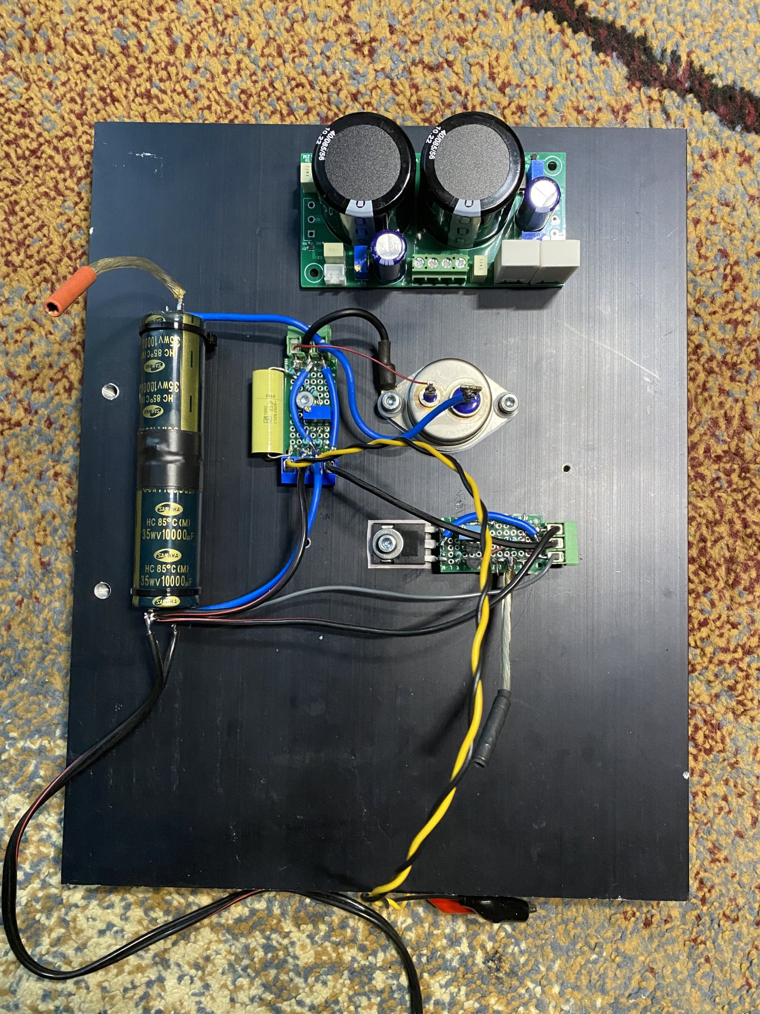

Ps. The 12v battery was used on the first prototype, now it serves only to hold the amp heatsink in place. Probably one day will try to power it with 36v comming from batteries.

This buck boost goes only to 36v so that was the highest. If you use 50v rated caps you could go to 45v rails but do you really need it? You will need also a pretty big heatsink.
There is a thing you must account for when increasing rail voltage and sit vds.
As you increase the vds of the sit the 2nd hd will go down(cancel) much more than the 3rd. So it will become 3rd dominant at least at high power levels.
To have it 2nd dominant on the entire power bandwidth you have to increase the bias proportionally to vds.
With 1.8a you are good(2nd dominant)up to 36v and 15w/4r.
Right now the phase of the 2nd is positive so I reversed the terminals on my speakers.
It is possible that above 36v the phase will become negative.
Beside the sit vgs and bias adjustments I added an adjustment(with ZM’s help 🙂 ) that selects how much the ccs contributes to the output current or said with Pa’s words an adjustment that tricks the vfet to think he powers a higher load.
