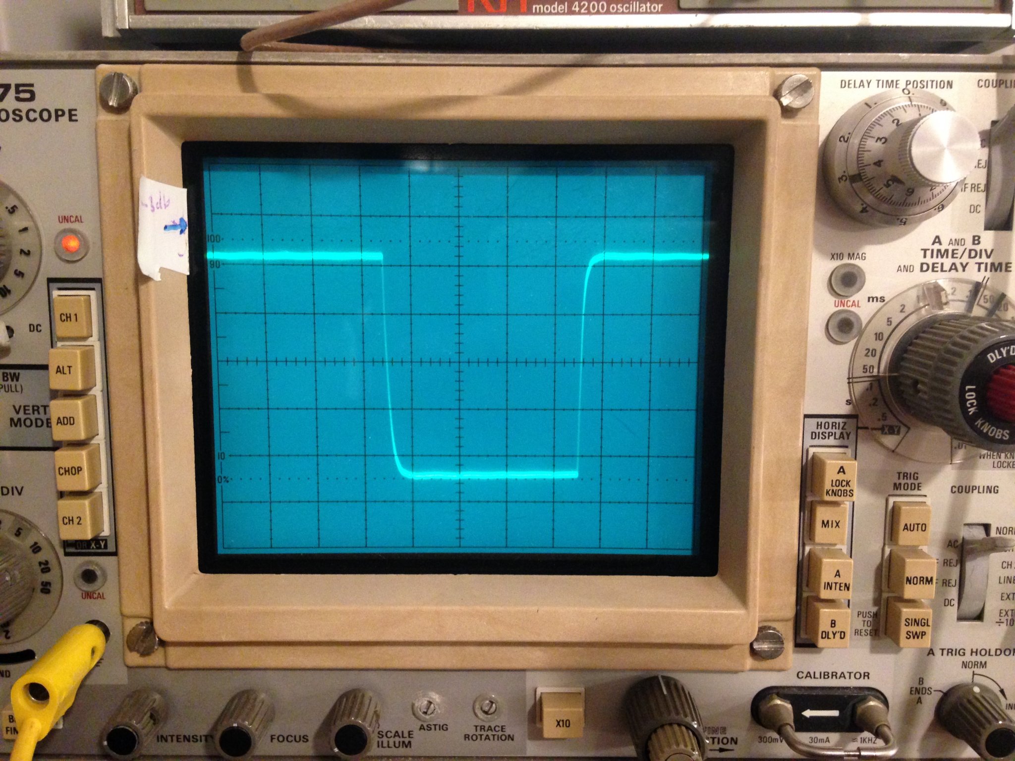

Below a 100mV 3kHz square wave in 8Ω. So this looks good.

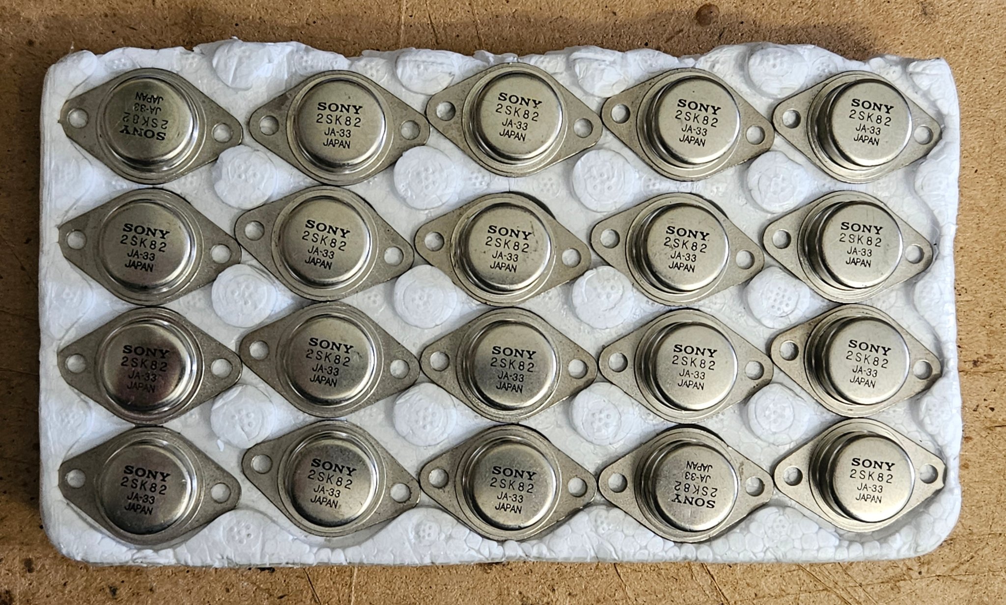

Looking for Sony VFETs / SITs? Curve-matched parts are available here: 2SK82 and 2SJ28 with curve traces

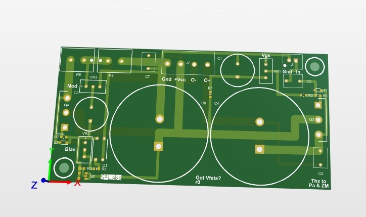

Having some vfets around I decided to build this amp on some proto pcbs. I was impressed about the sound so I decided to draw a pcb for it.

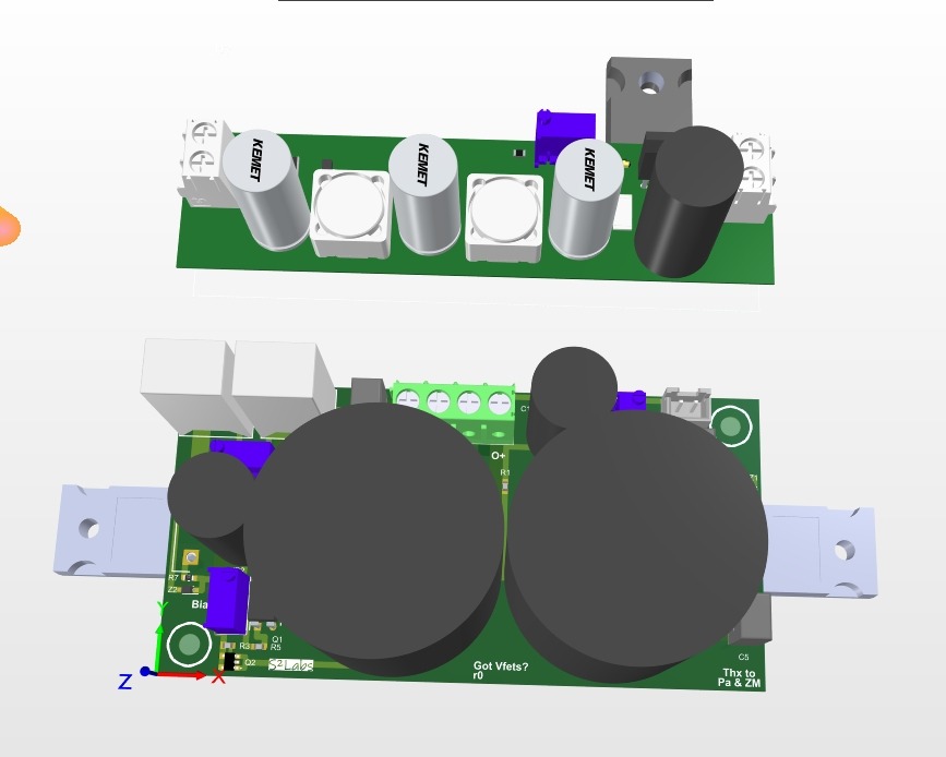

In the meantime Mark designed the AmyAlice filter for which I drew a pcb too. I added a extra cap multiplier to make it suit my needs.
I will have the pcbs in a few weeks so the rest of the fun still has to come.
A big thanks to Pa, ZM and Mark!
