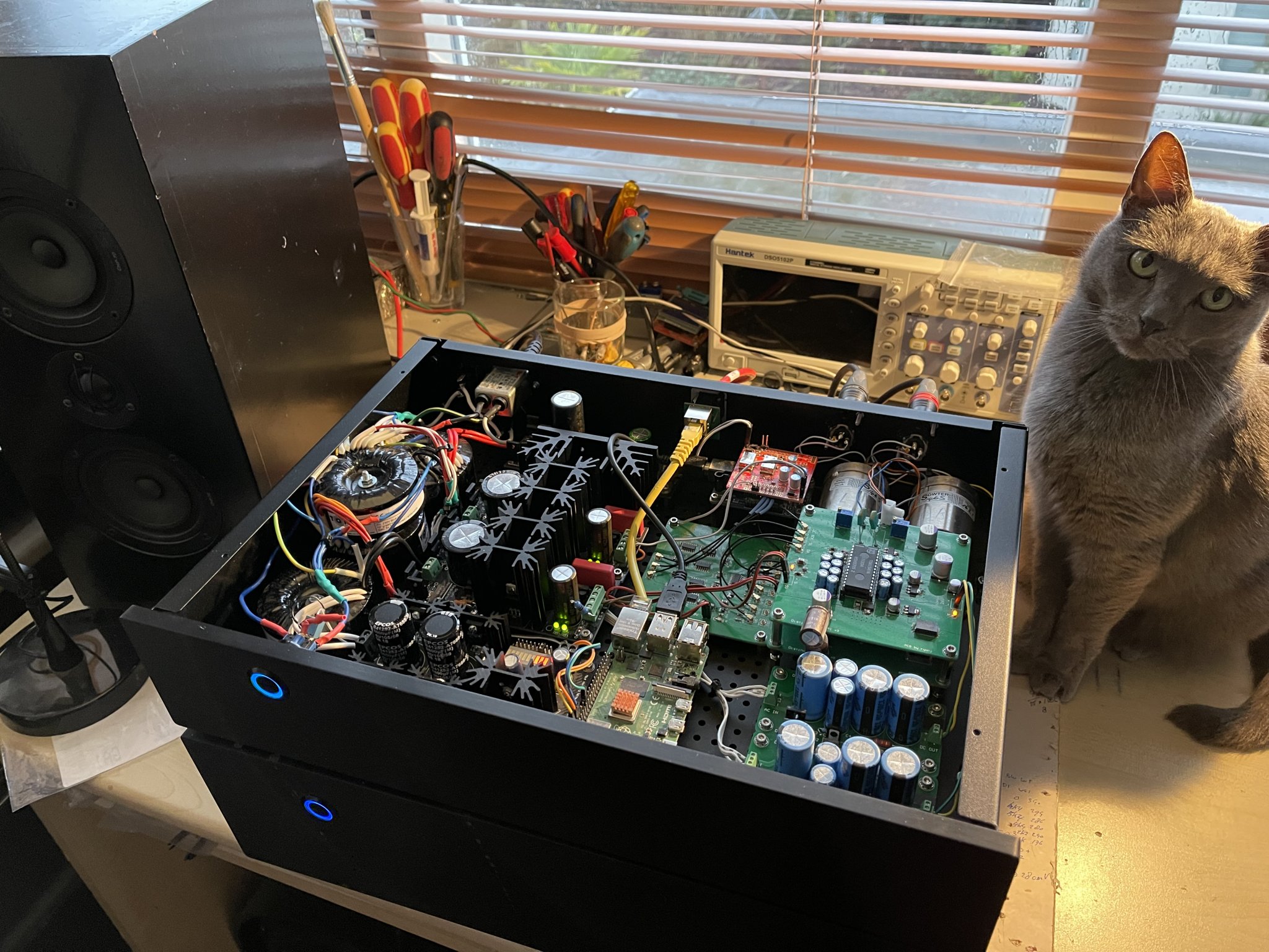

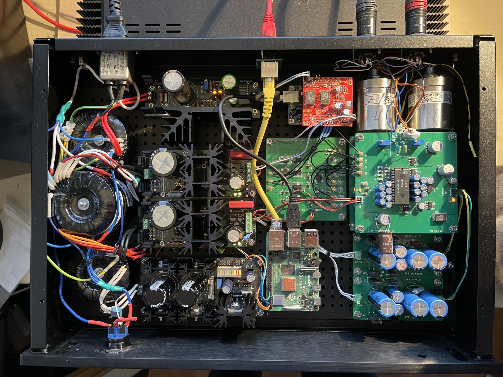

I finally found time to finish my dual D3 setup, RPi4b/moode audio/jlsounds/i2s sim V2/D3/30R rhopoint iv resistors/sowter 1465 trafo
Sounds very fine but I need a preamp with max 6…12db gain for my Pass J2 clone.

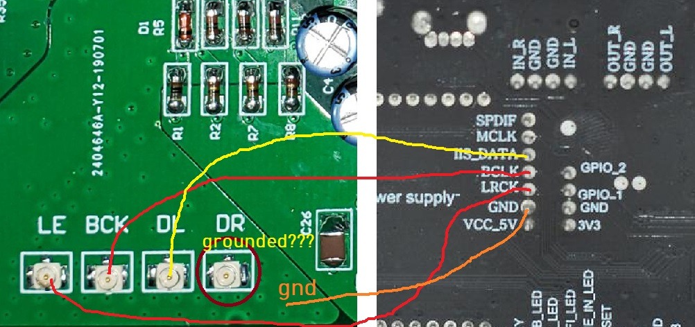

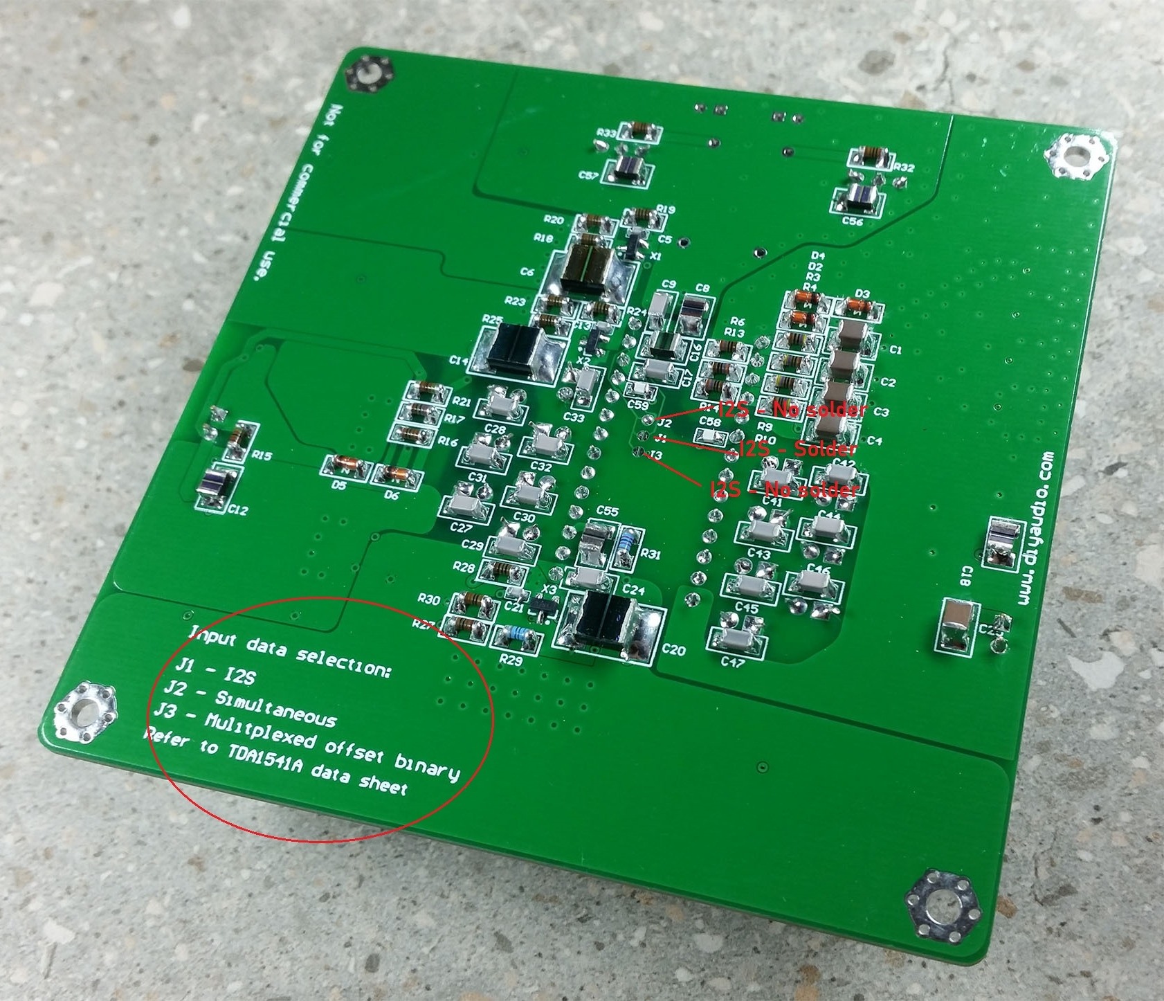

Connections look correct.
For TDA1541A and I2S input, DR is left open. If your chip is a non-A TDA1541, then DR (pin 4) needs to be connected to pin 2.
For I2S input, the I2S mode needs to be selected. On the D3 that is done on the underside of the board:
