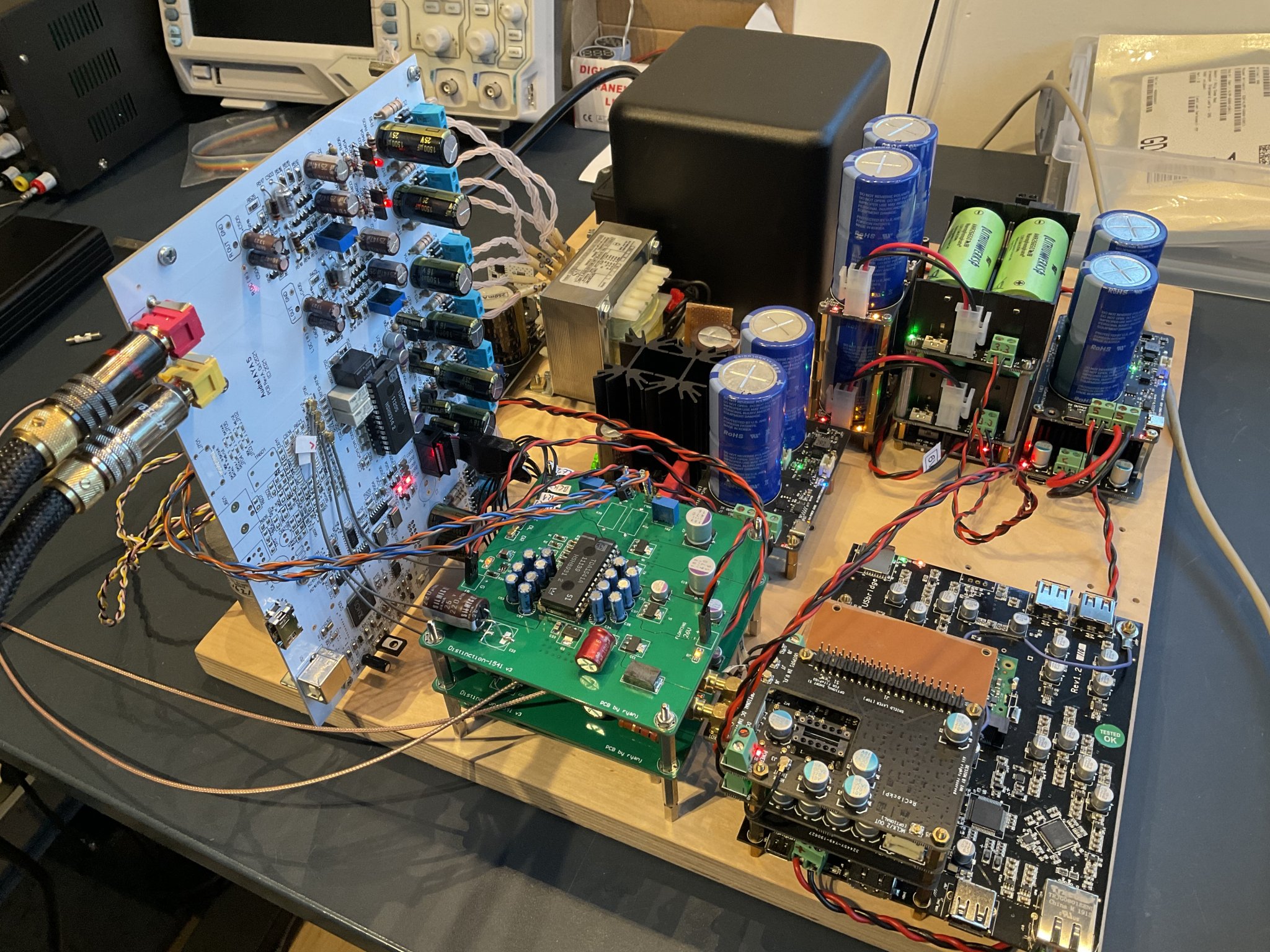

As I mentioned in the other thread, I am having a positive experience with parallel LTO batteries and Maxwell Ultracapacitors powering my TDA1541a.
The Maxwells are either 310F/2 (2 5V supplies) or 350F/6 (-15V supply)
So, a net capacitance of 155F for +/- 5V and 58.33F for -15V… substantially more than the 1.5F you are using.
So, it’s great to know there’s a much lower threshold of Farads for a positive difference than I might have suspected otherwise.

They are 2.7V. The BCAP0350 Maxwells are rated max ESR of 3.2 milliohms each, so not so bad even in a series of 6.
The BCAP0310’s are even better at 2.2 milliohms.
Here’s a pdf comparison chart on the 2 from Maxwell. I think at least the 350F is discontinued now but readily available from eBay.
I’ve been using Ultracapacitors in some form or the other for a year or two now (time flies?) but getting this size Ultracapacitor out from behind relays to directly connect to the load is new.
Some of the larger LTO batteries have extremely low ESR as well and I have a couple to experiment with.
As some others seem to, I suspect there is more going on than a reduction in ESR with the results we hear with supercapacitors, though.

Hi Walter,Likely a stress test for Q1 & Q2. Maybe Ryan has an idea what will happen. Charging a large cap sucks some power for 2 mins.
I couldn't get the simulation working with such a large capacitance so im not totally sure how it will behave. But no matter what the CCS in the path of the zener string will always stay constant at 135mA. So if anything while the caps charge up CC1 will have a higher voltage drop across it so will have to dissipate more power during startup. Might be enough to put a heat sink on CC1. (Try at your own risk.)
I have 25 D3 PCBs left.
Thanks Ryan. Perhaps some brave soul will try (with spare parts ready). I suspect 317 has some built in protection. It will take a while to come up to speed, so it only makes sense if you leave it under constant power. Iancanada's Uconditioner is another option as it preloads the supercap and the power supply only keeps it charged up if I understand correctly.
This article says the key point is to never let the voltage difference on 317 input to output exceed 30v. So should be ok. https://electronics.stackexchange.com/questions/148340/how-to-protect-lm317-from-output-short
These are pretty nice. I also suspect you're right its not related to ESR. I might experiment with this as well now just to see if something can be gained...hello @Makone

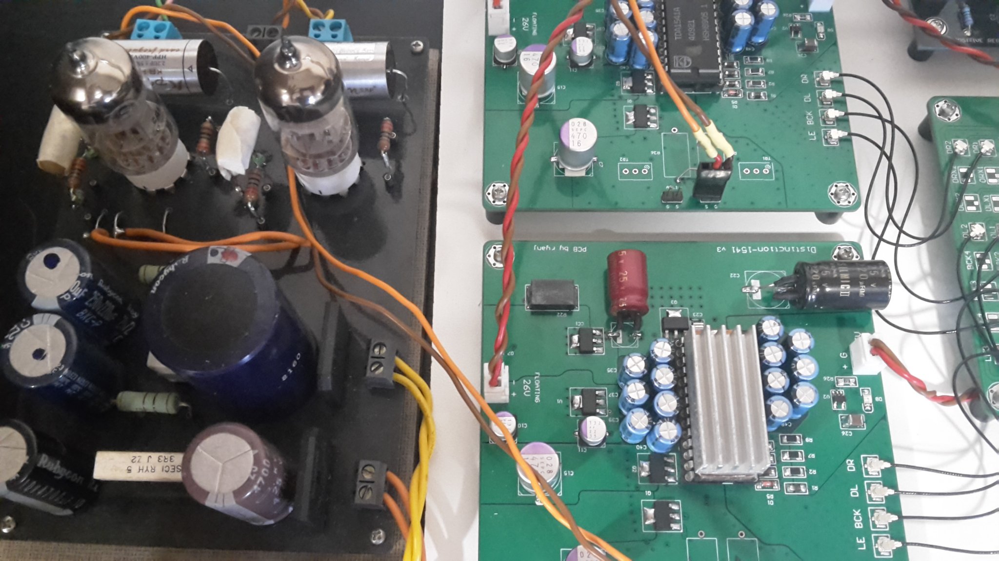

I did a comparison between the D3 in balanced mode with Sowter opt’s, and the Aya5 dac board.
I made a “Quasimodo” setup with the Aya5 board perched vertically next to the D3 and connected with the simultaneous output of the I2S-SIM pcb. In this way the streamer is exactly the same and I can easily change between the two DACs.
The Aya5 has been running in for about 10 days on my work bench before testing and I used an S1 dac chip (not on the picture) for fair comparison.
When I started listening, the difference was immediately very clear; the Aya5 is not up to the level of a balanced D3. The difference is big and this puzzled me.
The Aya5 is less open, more congested, the highs are much less clear and detailed. On the other hand, the low frequencies have a bit more power and drive; this is most probably due to the low output impedance of the IV stage (and higher gain) compared to the opt. Note that the dacs are directly feeding a volume transformer and these are sensitive for high output impedance, so it does matter here.
The overall sound of the Aya5 is a bit dark.
The D3 has a much more 3d presentation with lots of space between the instuments, all instruments can easily be followed even if with crescendo passages. The decay and harmonic structure of the instruments is much better. The dynamics are better.
I did not expect such a big difference, I still think the Aya5 is good value for the asking price but a balanced D3 is clearly quite a step higher!
When I have the time I want to do some modifications to the Aya5, there is some improvement possible on the power supply lines and I need to check what else I can identify as a weak spot.

I was also surprised of the outcome. I have not done any modifications to the Aya5 board yet.Thanks for the report Supersurfer.
I'm surprised by your findings, I thought it would have been a close contest. I wouldn't have though such an obvious difference. Maybe the Aya needs some fine tuning. What DEM frequency is the Aya running at?
The capacitor between pin 16-17 is 470pf and 100nf decoupling on DEM pins.
The board can also be executed with active DEM clocking but I hesitate if I would do all the effort if the difference is this big.
