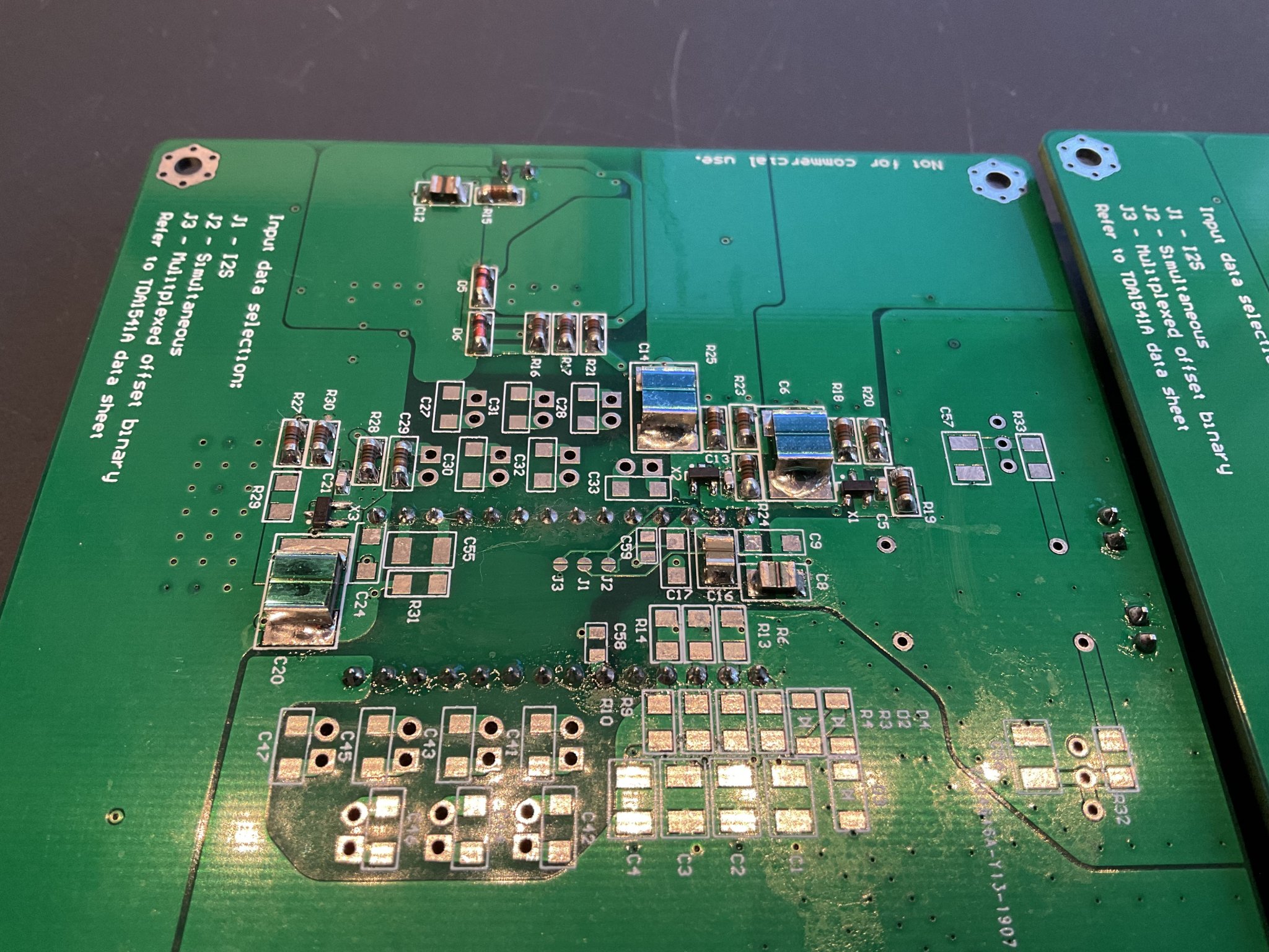

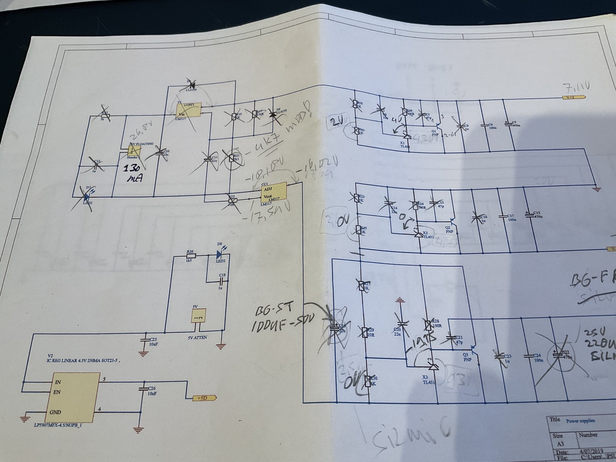

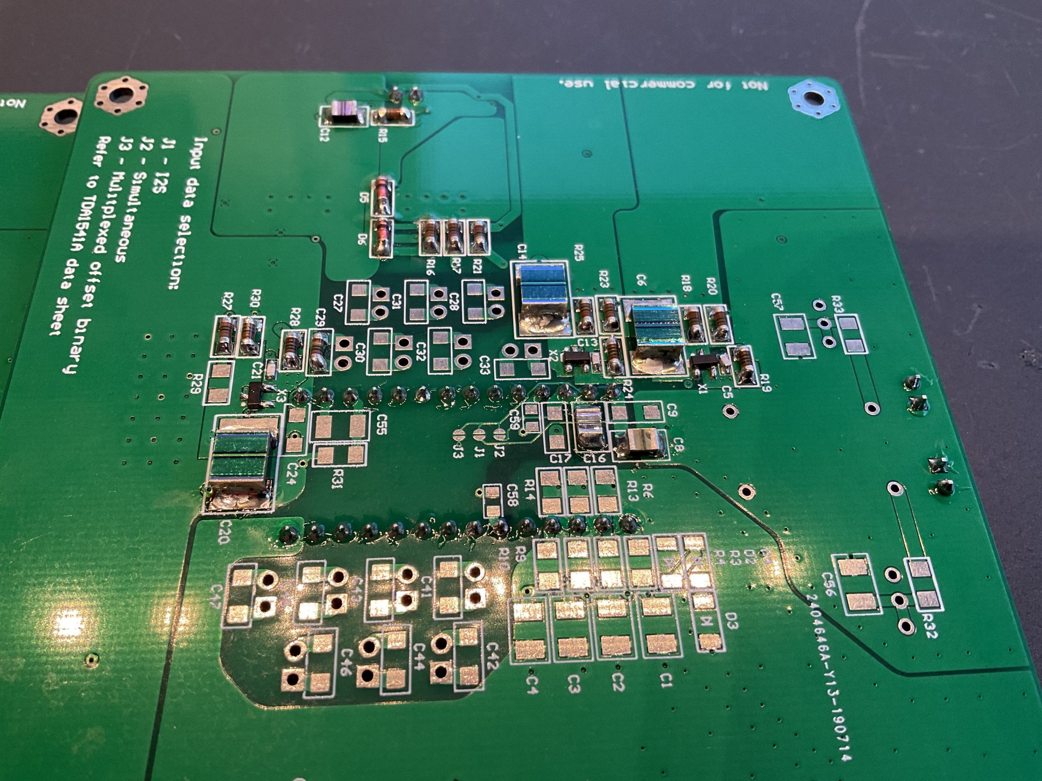

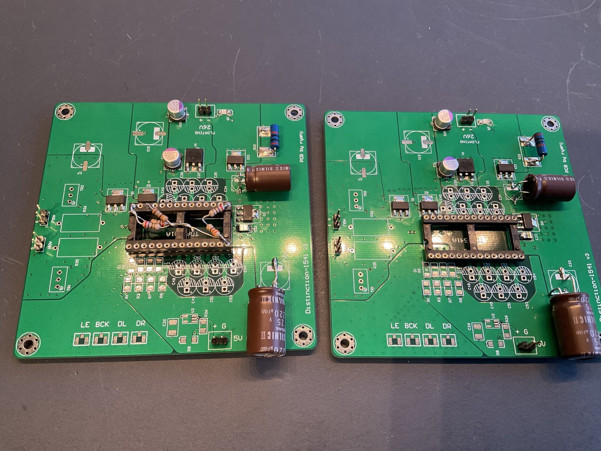

Hi @ryanj,
I have finally found some time to build 2 extra D3 boards. And I am running into a power supply issue (again).
I have soldered the power supply components as in the manual from @ggetzoff and measured the following voltages:
at pin 26=0V
at pin 28=+4V
at pin 15=-19V
I measure 0V over X2 (see picture), -19V over X3, 4V over x1.
I measure exactly the same on both boards. My idea is that x2 must be defective so I replaced them together with c14 on both boards but the issue remains.
Just to be sure I also soldered in most of the other power supply components but the issue remains.
Can you or anybody else help me out here?

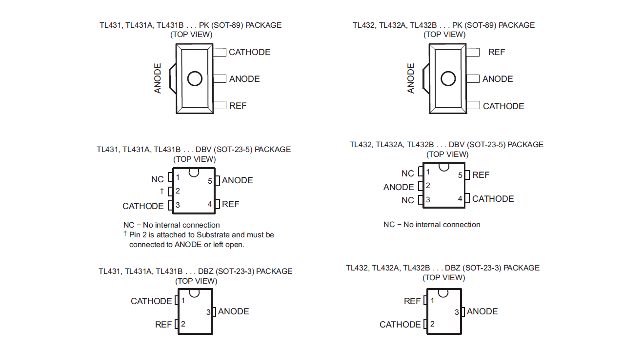

It's a very good chance that the TL431, X2 and X3 are not working. They can be damaged by too much heat during soldering. A quick way to test them is to measure their Vref which should be 2.5V if they are functioning properly. Vref is measured between the Ref pin and Anode.
