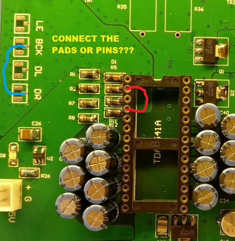

Connections look correct.
For TDA1541A and I2S input, DR is left open. If your chip is a non-A TDA1541, then DR (pin 4) needs to be connected to pin 2.
For I2S input, the I2S mode needs to be selected. On the D3 that is done on the underside of the board:
hello Ben Mah,
thanks for the info, yes i've connected the jumper into i2s mode.
the chip is tda1541 non A, so i should connect the Data/R pin4 with BCK pin2,
connect from the pads or the chip pins?
thanks.
Peter
Your choice.
Safest would be to do it at the underside of the board. It would need to be undone if you use an A chip.
A bit riskier would be to do it on the chip pins, above the socket. But it is feasible if you have a steady hand and small tip on your iron. Advantage is no need to undo the connection on the bottom of the board if you use an A chip.
i mean the question is about, the connection should be done before the attenuator or after,Your choice.
but i think its before the attenuator, so connect pin2&4 directly from the chip pins. (not from the pads / ufl connector)
so with A or non A, pin 2&4 connected when in i2s mode.Correction: Pin 2 to 4 connection may be left in place if A chip is used in I2S. Pin 2 to 4 connection needs to be removed if simultaneous mode is used.
ok understood.
thanks.
Peter
ok great, thanks.The pin 2 to 4 connection is at the chip. It can be done directly on the chip or at the underside of the board at the chip pins.
okThe D3 board is "slave" as it does not have its own clock.
thanks BenMah
