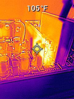

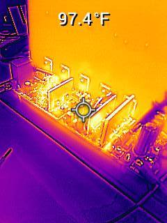

It runs about as warm as you would expect from an amp making excellent power. A lot of thermal imaging was done to verify that the components were operating within expectations. I have pushed the amp very hard during load tests and the output heat sink only got to 40C. With a fan I could run hard for as long as I wanted without it getting hot. The same can be said for the board components. The heat sinks are sized appropriately and have proven to do the job well. Here's some images....

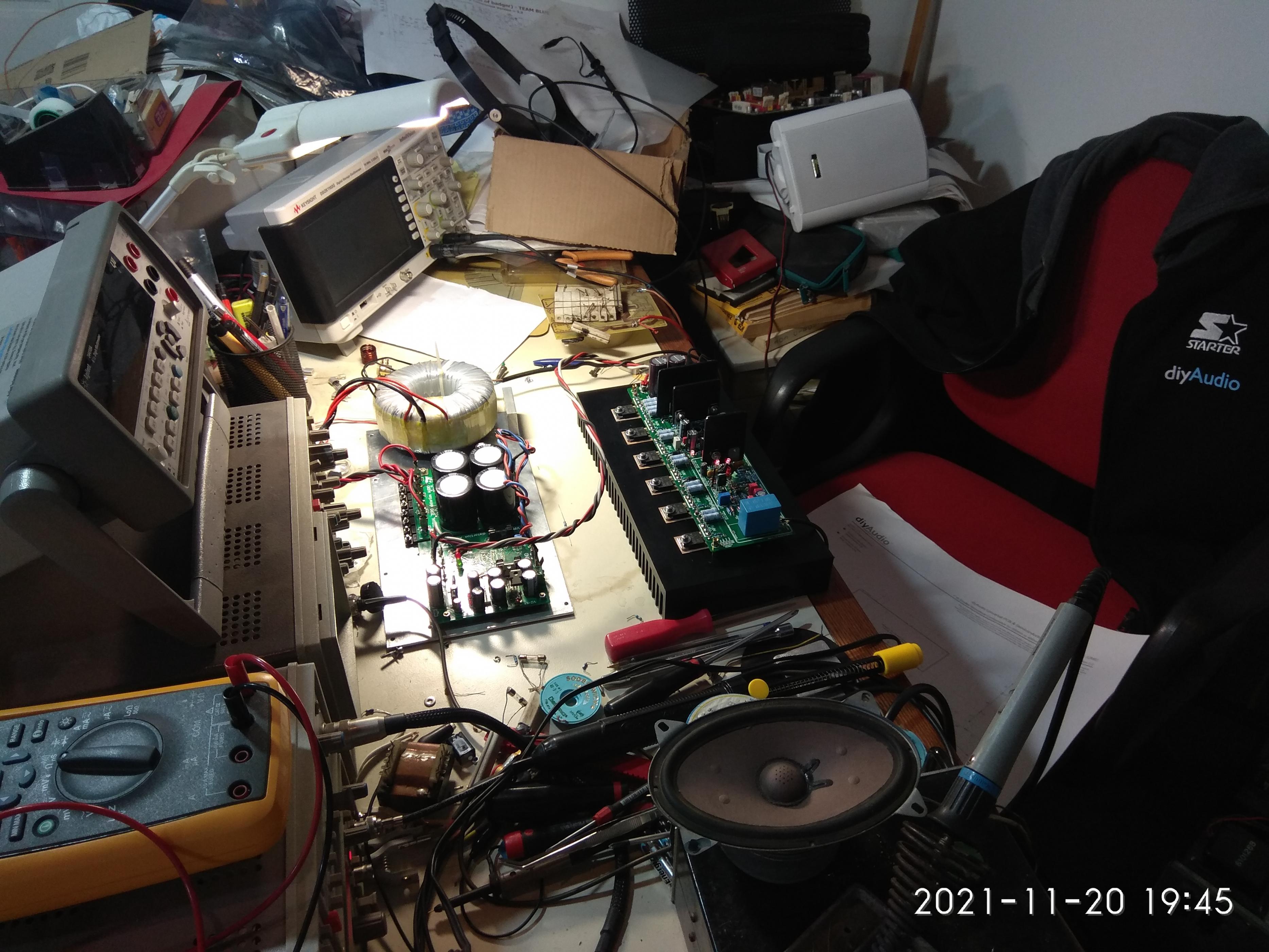

Hi All,
I just wanted to update everyone who is subscribed to this thread on the progress of the wolverine son of badger project. Over the past few months the team has been very busy testing the prototype 2 PCB.
We currently have 6 working boards and each one of them has had slightly different components installed. This has enabled us to test, refine and measure many different combinations of components.
At this stage the whole team is very happy with the results of this details testing process. I would personally like to thank the Team members (Keantoken, Jeremy, Harry, Neil, Thimios, JT, John and Brett who have been working on this project basically every day and put in many, many hours to make this amplifier as best that it can be.
If the initial THD numbers are anything to go off, the project is certainly meeting its original design goals.
Taking all that we have learnt, Prototype 3 has been completed and we are currently in the process of checking it before we will have a small number manufactured. Once those boards arrive and we find time to once again build and test a few to ensure they are Final we will ask the other forum members for an expression of interest so we can get some numbers together for an initial run of PCB’s for fellow members.

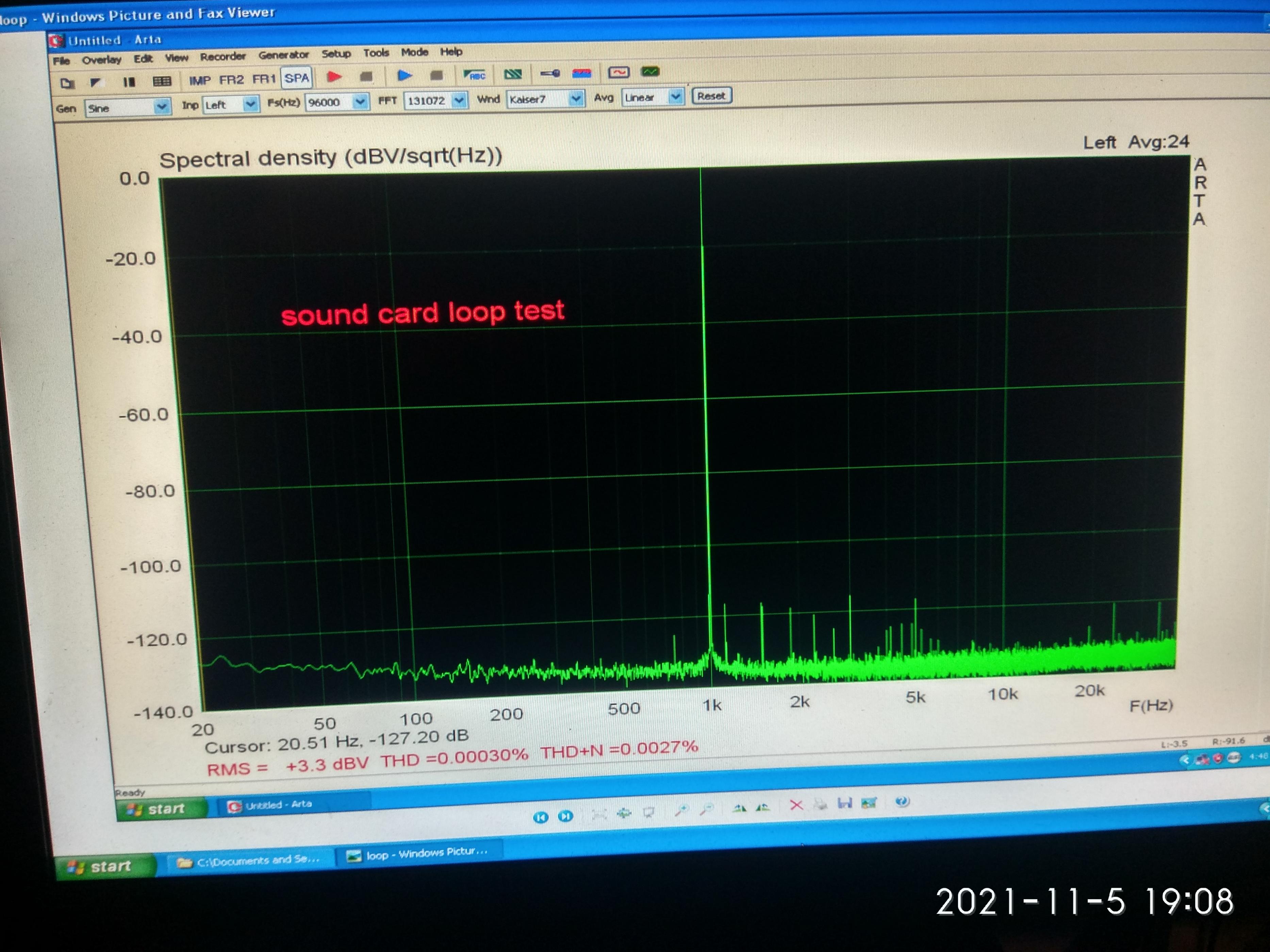

From the prototyping prossedure.
Picture No.2 Sound card loop test.

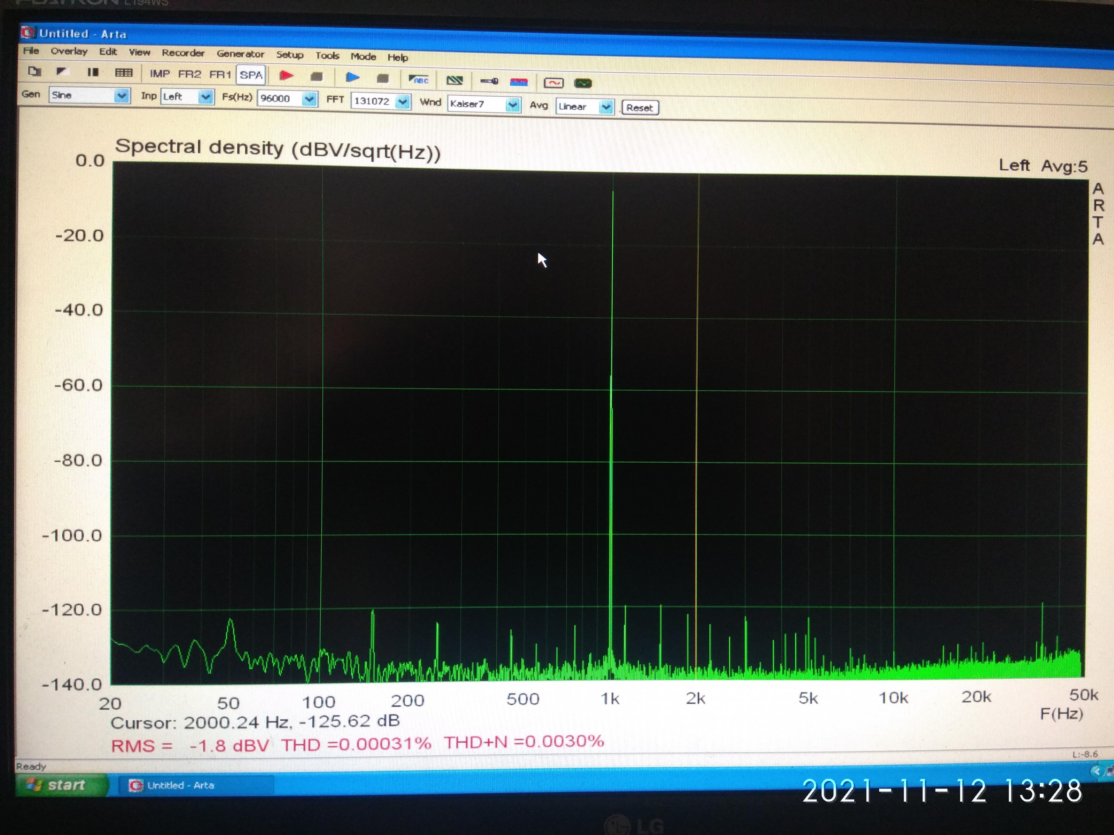

Picture No.3 Amplifier THD at 28v RMS under 8ohm dummy load.
