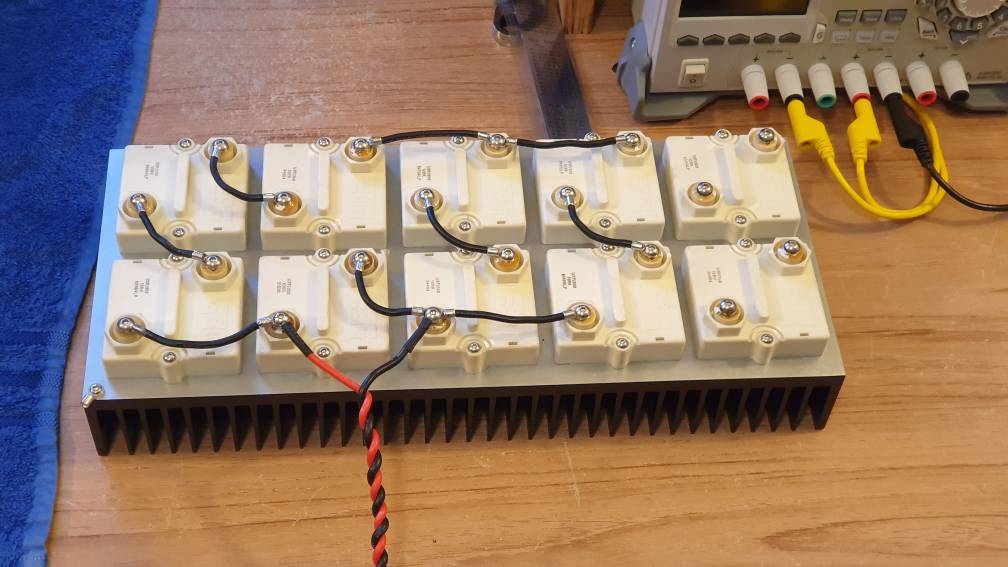

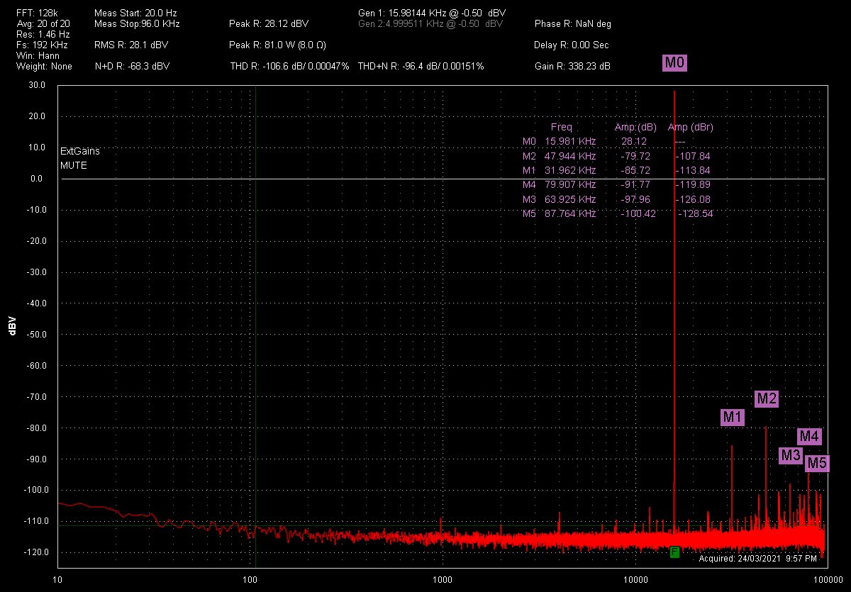

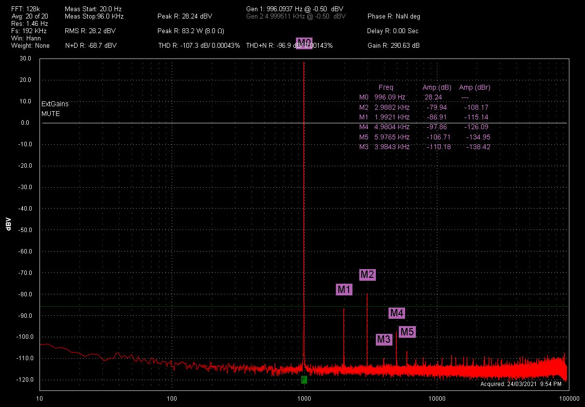

If you would like me to make comment. Please make a test with the same parameters as I'm using.Thanks brother!
What do you think of those numbers so far?
See images 2 & 3
Look at the top for the numbers.
Output level should be -0.5dBv this will give you an output of about 80watts RMS. Also you need to long click on the THD button and set the range to 20hz to 96khz
Then post me your results.

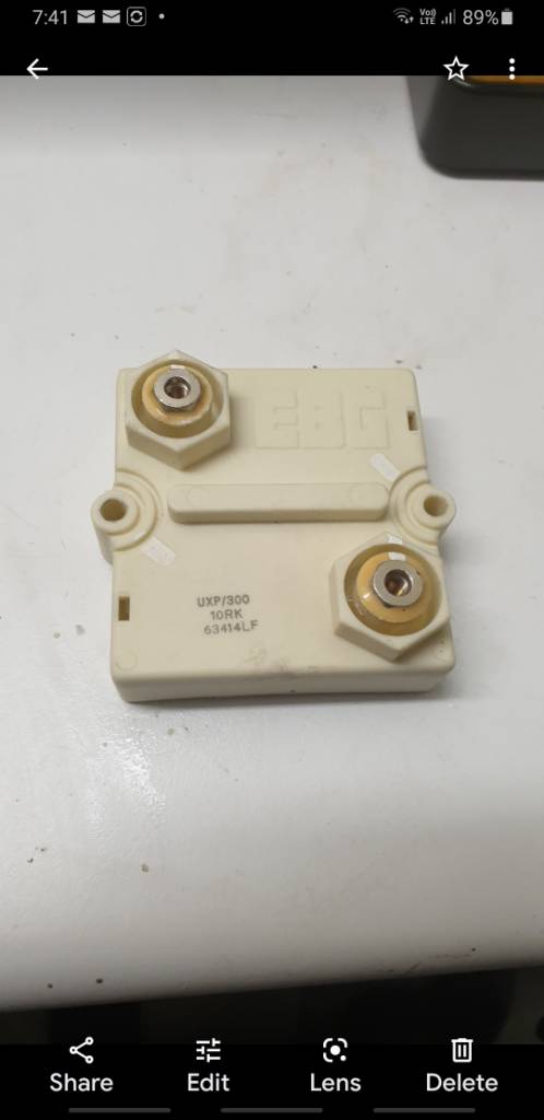

Something else to note. I know that you using the quantasylum load resistor. I was using an ebay load resistors that turned out to be inductive. It completely messed up my readings. Spent nearly a year trying to work out why my 16khz numbers were so bad. It was the load resistor. So to be honest unless you can verify your load resistors is not causing distortion its difficult to give comment on your plots.
Please read my posts and keantokens posts between post 2378 to post 2445 to get a better understanding.

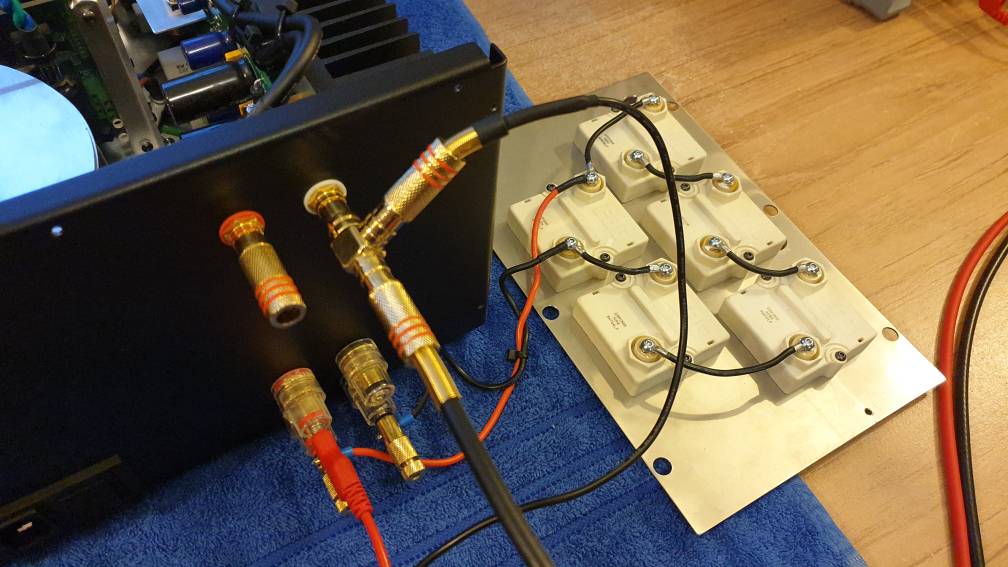

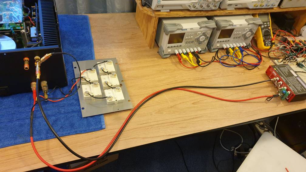

You need to enter 95999.9999999I can't do the numbers you have as it will clip the input before I get there. I pulled the 451 out and am using 8ohm from same as you were using in the picture below.
Also, can not do 96k on the THD it shows invalid.
Or something similar. Do you have the latest QA401 software?

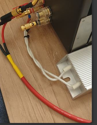

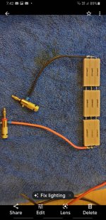

Those are the problem resistors. Do bother using them.
You need these ones.
Even a 3x3 array is better for a quick test than that ebay one.
All the notes are in my past posts

No worries glad I could help.I can go back to using the QA451, but I also have some other load resistors which should work too. I will look into that and the others from the thread.
Yes latest 1.924 for the 401.
I appreciate you help and will let you move on... thanks
If you have trouble with getting the attenuator PCB's I could mail you some as I have spares.
Getting this measurement setup right is a pain and does take time but your getting there and now have the foundation knowledge of what's involved
Good point. I forgot to add that.To check whether the resistor is the problem, measure THD at the feedback resistors rather than the output point.
