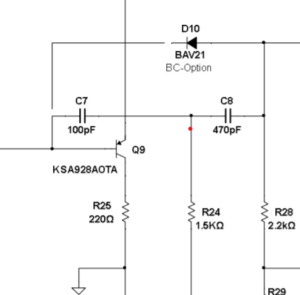

i pulled a bone head move when doing some testing... I hit the QA testing for a pulse and instead it stayed on steady input. I was moving some leads around and R25 went up like a smoke grenade.
Dumbazz move on my part, but I know if R25 smoked there was a reason, so just replacing that is unlikely to fix the issue.
What all should I test before firing this thing up again?

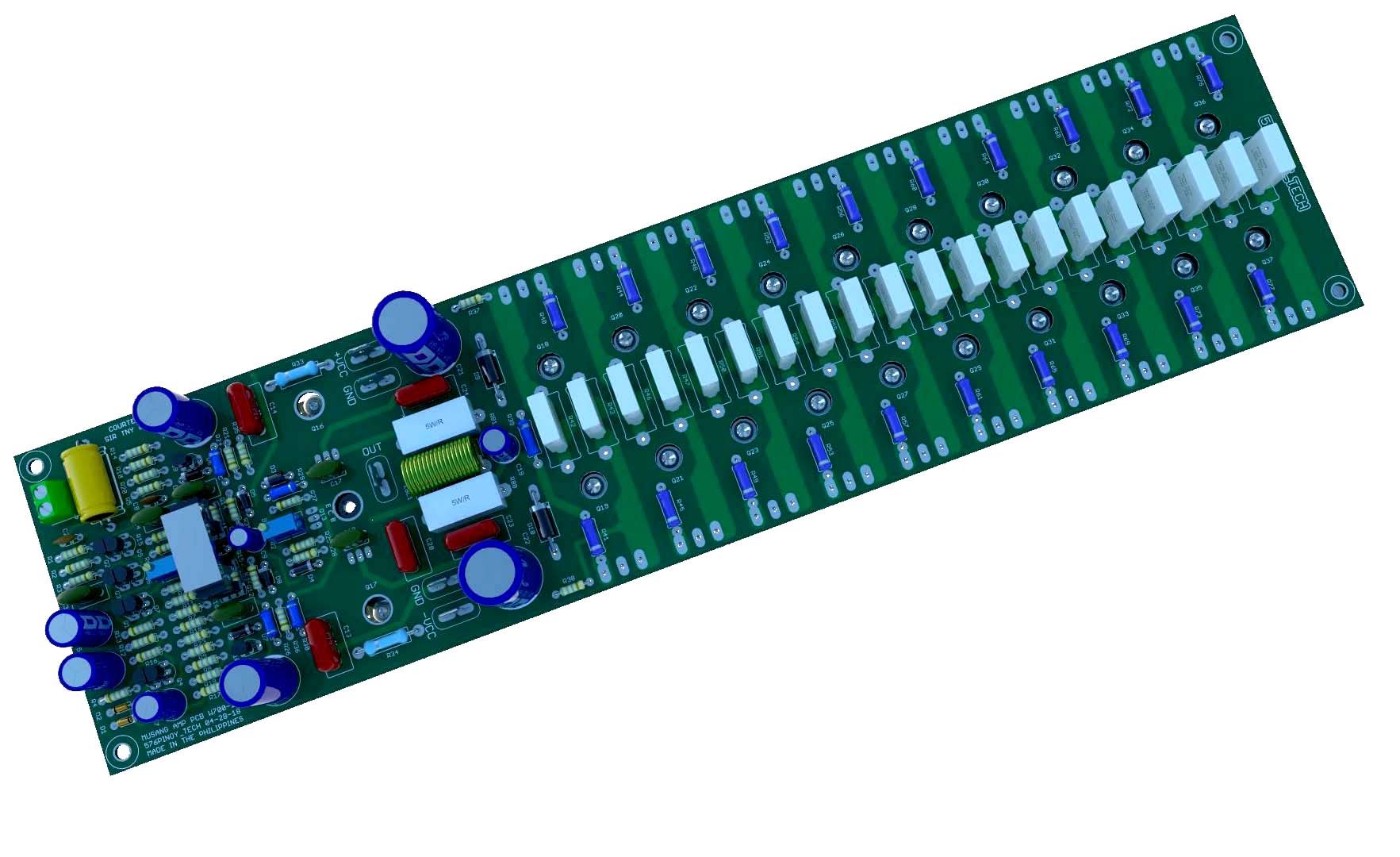

You're using the Honeybadger frontend to drive ten pairs of output devices? What's your intended rail voltage?
Best regards!
this is a 9pair output in a triple Darlington configuration, +-85 volt rails..

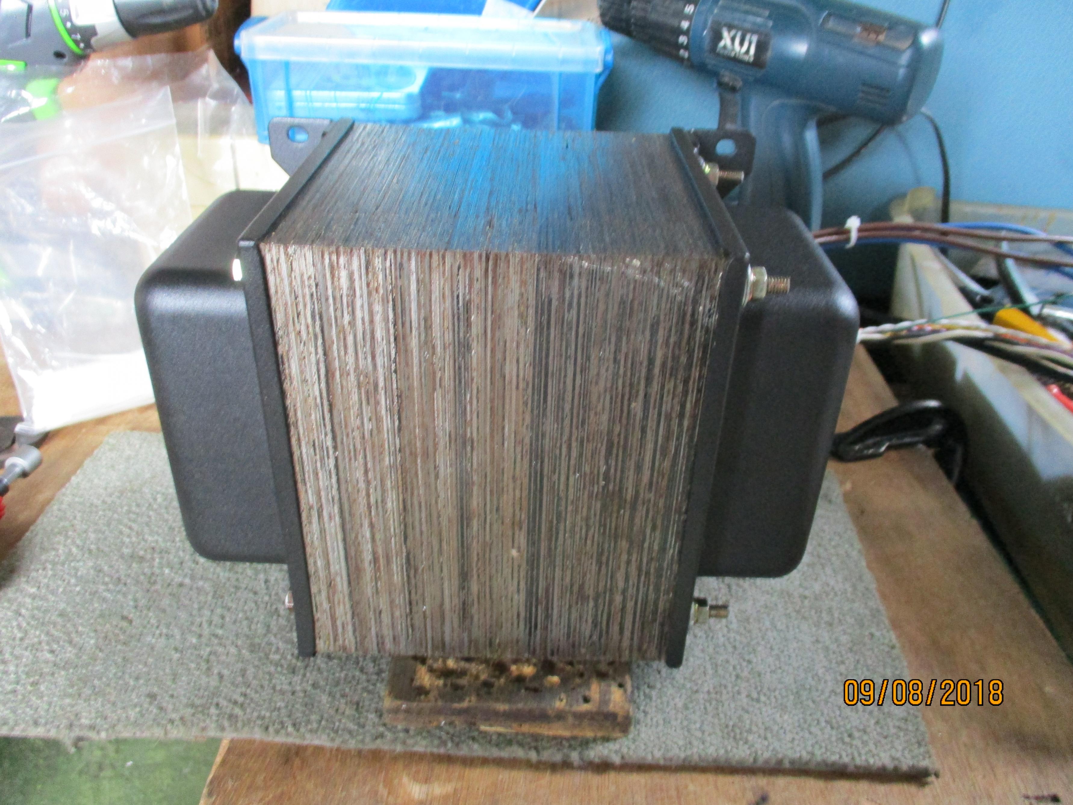

this is where i am using my monster power traffo that i made....
i have four 68mf/100vdc cans from ApexJr for psu duties...

So far Q9 was toast and replaced as well as the R25 and R14 took a lot of heat from R25. It measured okay, but I'm there so might as well be safe. Going forward and back testing looking for more. By some readings I'm getting there are more transistor issues.

i pulled a bone head move when doing some testing... I hit the QA testing for a pulse and instead it stayed on steady input. I was moving some leads around and R25 went up like a smoke grenade.Dumbazz move on my part, but I know if R25 smoked there was a reason, so just replacing that is unlikely to fix the issue.
with the aid of a dim bulb tester, two steps, first is output offset dco or dc output adjustments, + -100 millivolt is acceptable, but of course closest to zero is what we aim for, the desiderata …..
second is standing output current adjustments, you may notice your dim bulb getting brighter if you over do your bias adjustments...when you are satisfied that there is no crossover distortion at the 1 watt/8 ohm levels then you are done...actually if the dim bulb tester does not turn full bright, you got a viable amp now....and can wean the amp off it for the crossover distortion testing with a scope...
when all okey, you can then proceed to listening tests....
now to your question on r25, it smoked when there was excess voltage across it, the base of the q9 was pulled to ground when poking around....so i will replace q9 and r25 and maybe the VAS itself...then proceed over..
