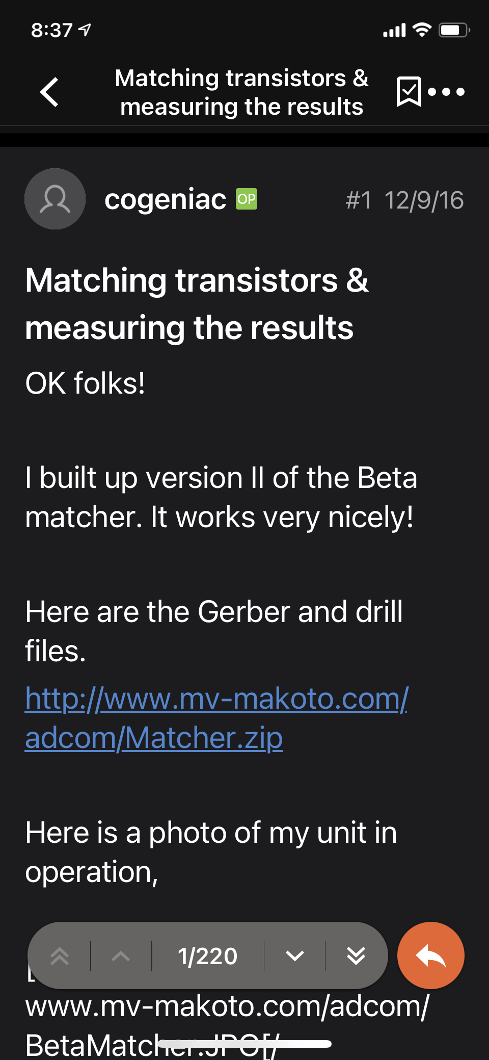

Do me a favor and build the transistor matcher I designed. It isn't expensive and makes a good project. Its in one of the Adcom GFA-565 threads near the end. Many people have built it and there were at least two boards designed for it.
sorry but i do not recall those, any links or documentations you can pass to me?

see if this gets you what you need Tony. Had to go down the rabbit hole to find these, apparently they were posted to a long since closed Dropbox and luckily got reposted.
Hi bullittstang,
Perfect! Thank you for finding that project. Chris's board works well. He sent me a few boards, and I gave them to people that could use them, so I know his board works.
I designed mine decades ago and still have the worn out perf board one. Then I designed a PCB and have that . Use it all the time. I am more than willing to answer questions on it along with build details.
For the collector and base resistors I used Dale 0.1% resistors. This jig will allow you to get matches within 1% fairly easily. The test points can be reduced to the collectors and supply voltages. That means three per polarity.
When you buy the sockets, use quality units bought from the normal sources. I tried several samples from Ebay and Ali, they made using the jig very difficult and frustrating to use, so do not skimp here. There are four positions that allow you to test all the base configurations, Pro-Electron, JEDEC and the Japanese standard - forgot the acronym.
Stick the pair together, cover with close fitting foam, and cover it with a box. Transistors are very temperature sensitive and air currents will cause the readings to drift. I find that a 3 mA tail current settles quickly compared to lower settings. The tail currents are adjustable so you can test at your design current (handy). You do have to wait until the temperatures equalize.
I presort the transistors using something like what Tony uses now, or a multi-meter with transistor test. Then once you begin running the parts through you will see how far they are apart even though you matched them. It is sobering to see.
Tightly matched LPTs will reduce distortion and cause the DC offset to be very stable. You can ignore DC servos, or use the old style of injecting a current with a trim pot. Either tends to sound better than some servos. Filtering the output ofa servo sounds better than the normal practice of running the output into the feedback network through a resistor. Actually, sifting the predrive DC level sounds the best because you are balancing the LPT instead of forcing an imbalance.
Anyway, tight matching is worthwhile and allows the circuit to perform to its best. There are other tricks, but this is the big one.
As I said, I will happily answer questions on it.

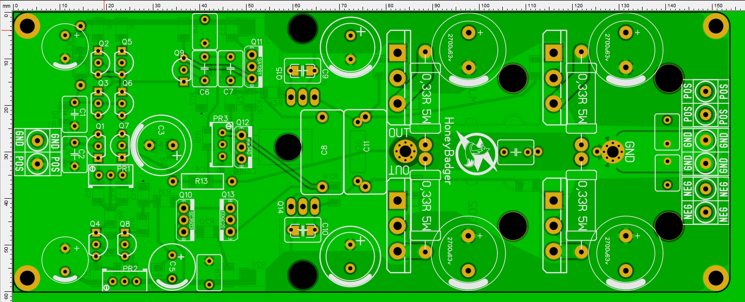

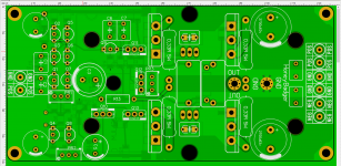

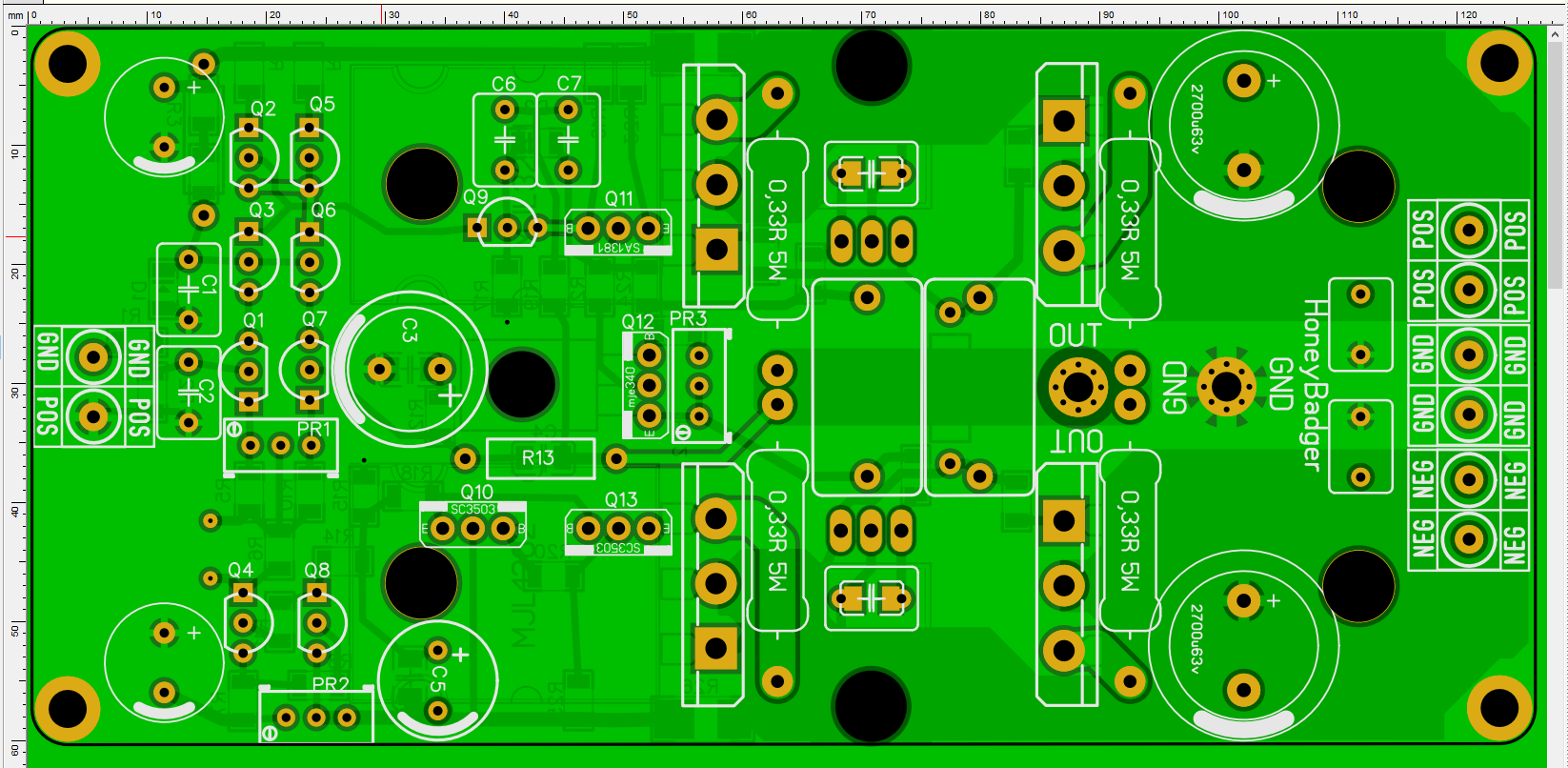

What do you think, which type of amplifier board is preferable? It was possible to rotate the output transistors vertically, but then the width of 6 cm does not enter -(
nice, second version for me too..
