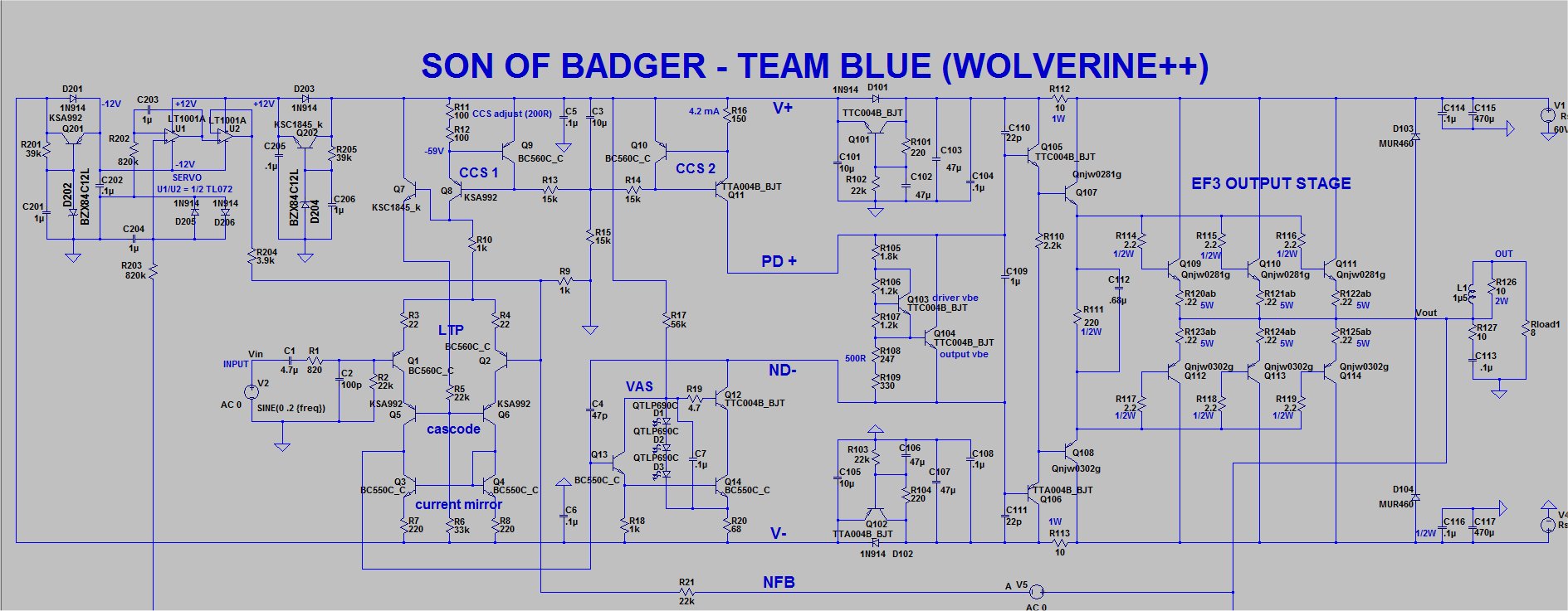

The design of the new Wolverine (Son of badger is complete)
Just waiting for OS'S final review.
Many improvements in this design over the HB.
DIYA store "Wolverine" (Son of Badger) .... suggestions ??

That schematic is completely out of date.i have always liked pnp input stages and npn VAS.....
if i were to redesign the old honeybadger that is how i will do it, again Ostripper hit it good...
