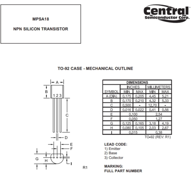

Thanks guys. This data sheet confused me. Looked as if it was showing rounded side facing out.
