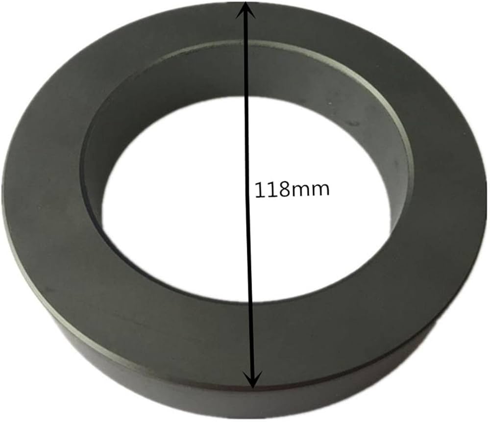

I had one "buzz". I did not know what was inside (the windings) ? It got quiet if I pushed on it or changed it's position.
I saw after unwinding it , it was a roll of flat steel stock without much varnish. I was expecting something like a EI with lots of varnish.
I saved the windings but noticed the flat stock was pretty loosely wound.
I assumed the loose steel was the cause of the "buzz".
(below) I watch people wind toroids on youtube , some use a nice cast ferrite core instead of rolled steel.
Wonder if Antec uses ferrite ? Never had one of those make any noise at all.

Jwilhelm,
I called Antek today and talked with John. He patiently worked with me, had me send a photo and decided he will send me a new unit and a return label so I can return this one to him.
So we will see. More will be revealed.

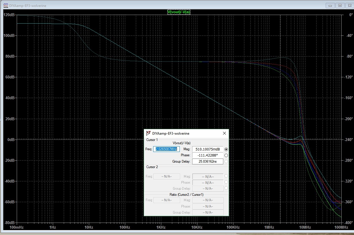

Well, I have searched and not found clarification for the LC cap. I am reading that the default choice is a 2pF cap. What is the power rating I should target for a 2pF mica cap? Can I go with 300V. That appears to be the lowest I can find currently. Reading the BOM this way:
2pF = 3V
10pf = 500V
Am I thinking about this correctly?
Thanks,
LC = lead compensation.... While this was added to most of my "blameless" designs (badger/wolverine).
"Lead compensation sacrifices the bandwidth between the 1/RFC breakpoint and the forward gain curve".
It (Clead) , is not really needed if you use reasonable values for the main TMC compensation. I added it for some who wanted to push
the amp to it's limit.
(Below) is a compensation plot with a .2 - 5pF Clead , note the change in phase as the value is stepped upward.
On a square waveform , increasing Clead will damp "ringing" on the resulting waveform.
Going in the other direction , I've used this type design to run subwoofers .... Just a single main 100pF cap at VAS - no lead or TMC.
Your ears might not hear these changes , but 20Khz THD would increase.
Read - https://www.rcet.org.in/uploads/academics/rohini_28552497983.pdf
