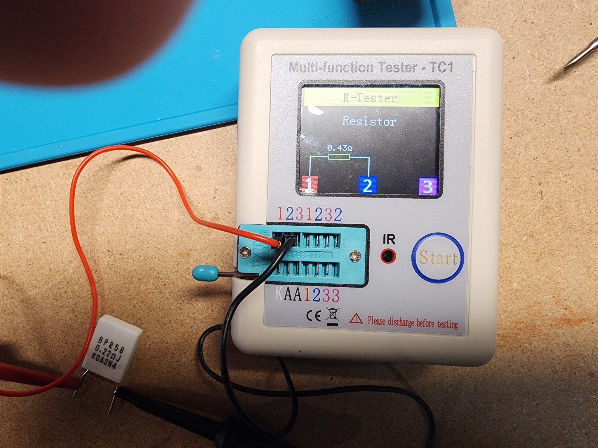

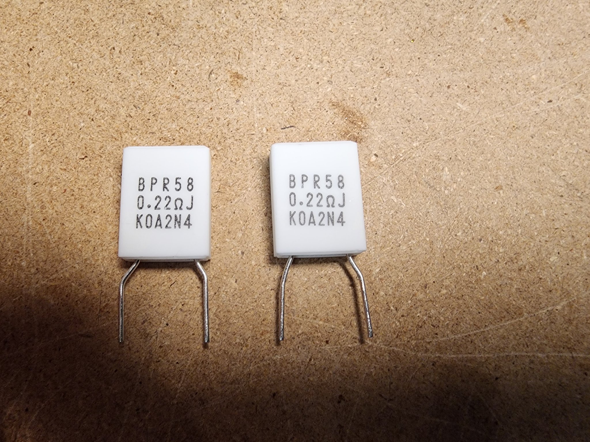

Hello Forum Members
I am currently assembling the first of my two Honey Badger amplifier boards. As is good practice, I test every component that I'm able to test before placement. I'm currently placing the resistors R43-R48. I am using 0.22 ohm KOA Speer resistors with a tolerance of 5%. The first resistor I measured had a value of 0.44ohms. The second, as seen in the attached picture measured 0.43 ohms. Granted, I'm fairly new to this but do those readings seem a bit high?
Or, am I missing something so obvious that I will soon be learning something new about this craft? Thanks in advance for any feedback.

If you don't have a meter that you trust for low resistance measurements you can always use ohms law to help you.
You could place your DMM in series with the resistor to measure current and then using a lab power supply output say, 600mV then measure the current through the resistor. For 0.22 ohms you should see about 2.73A
I = V ÷ R
This is approximately 1.6 watts so your 5 watt resistors can handle it.
