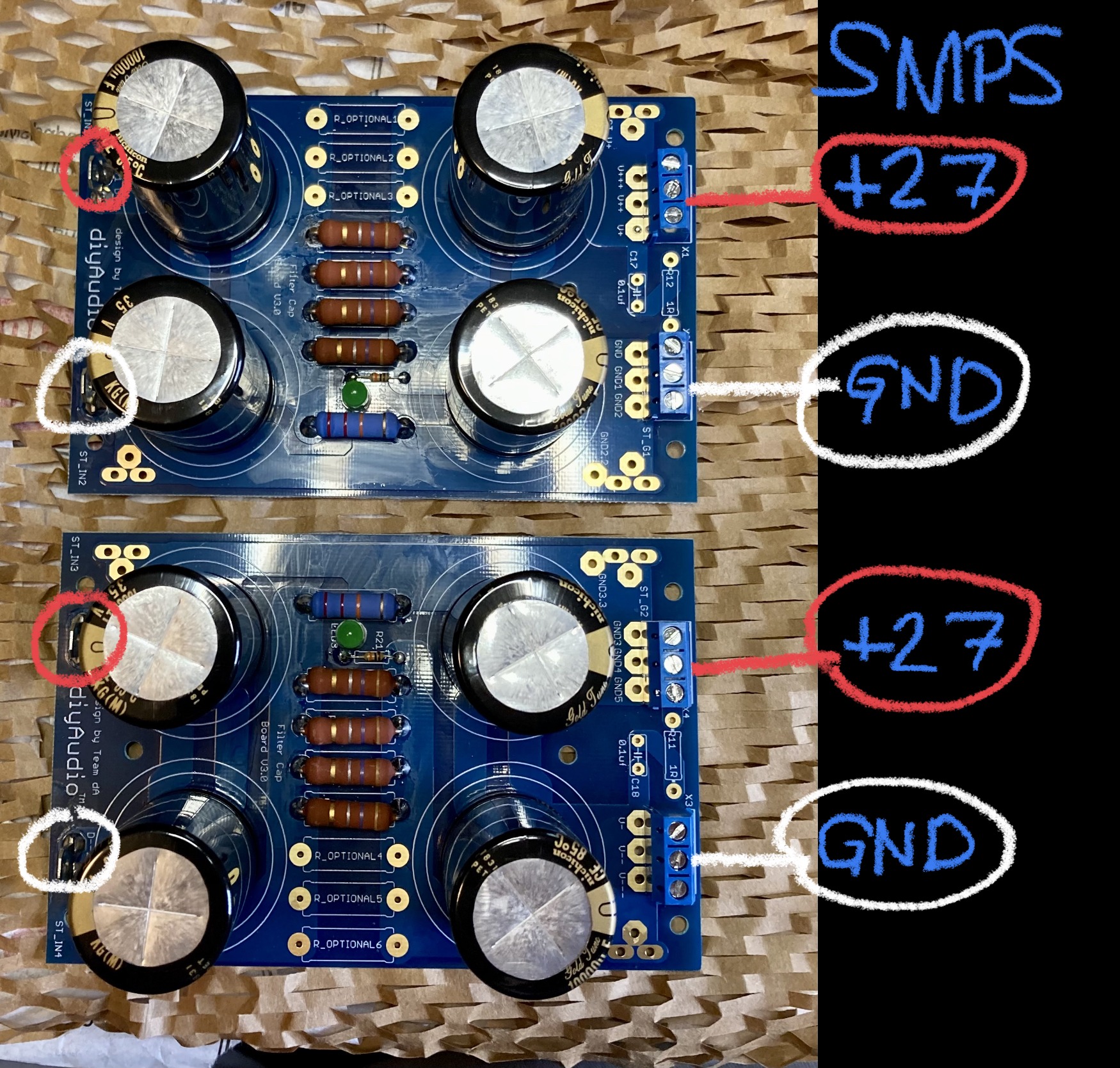

Logic check on my PSUv3 boards. I will be using one single rail smps per channel (LuFo). Does the attached pic make sense? Don’t want to blow up my newly arrived caps!

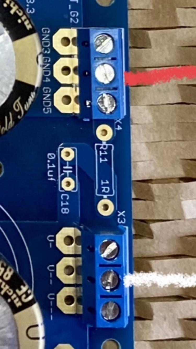

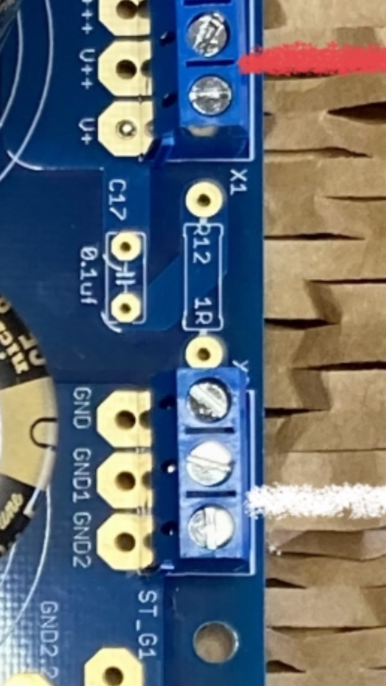

The critical connections to not blow up your caps are from your rectifiers to the filter board. I can't quite see how they're marked on the boards, and I don't have a set in front of me. Your notes for output are correct based on the board markings.
If I recall correctly, each half is identical, and I think you've got it correct. Just to be sure, another pic from top down with the input side of the filter board would be helpful. Someone may just remember the layout and be able to tell you from the existing pic. Either that, or just be sure to hook up + to + and - to - for the input to the filter boards just as they're marked. No reversing on the input.

Thank you. See attached for detail from my previous picture. Top right and bottom right for inputs.
My logic followed the + and - areas for the big caps on the board, so it made sense to me (but I’m an electrical simpleton). I’ll test with my 2 meanwelll SMPS to see if things power up appropriately.
