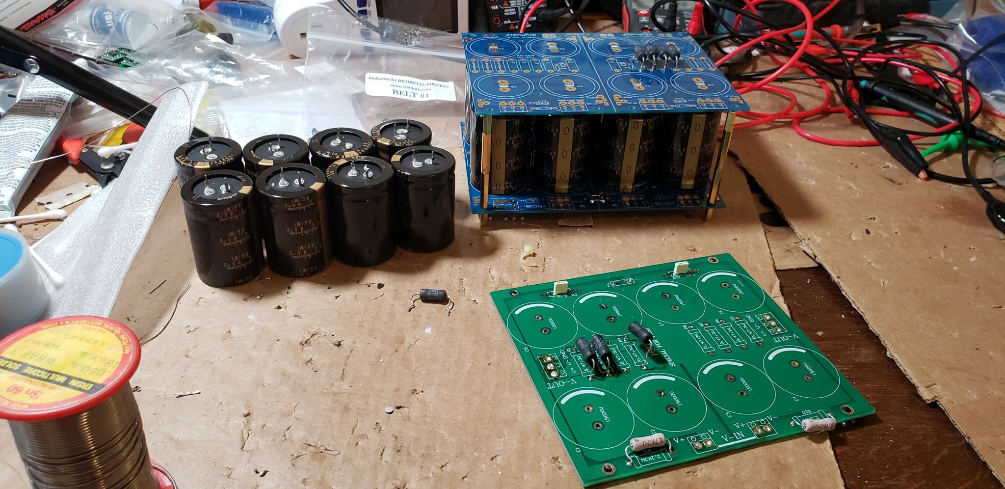

I have been searching this thread (whew, it's a long one!) looking for info on stacking these boards. I want to stack two fully populated boards for 120k uF per a rail. My question is, how do I connect the vias for this? I'd like them to be in parallel and want to do it right rather than chase my tail.
I've stuffed two with 15k uF filters, 4x 0.47 resistors, 4.7k bleeders, plus the LED. I've ignored the snubbing. Do I need to connect side to side grounding on the top board? I'd guess yes, plus the bottom to top jumpers, give me a parallel cap bank like I expect with no ground loops or magic smoke.
This will be running an F5Tv2. Originally I was using a Chinese diy board (yeah I know, not the best idea) but it was noisy and wouldn't stop. There was no great spot to star ground either, a feature I look forward to on these main boards. It's a great sounding amp once it's over the noise floor, I'd love to get it working with no hum!
Thanks in advance.
Thanks in advance.

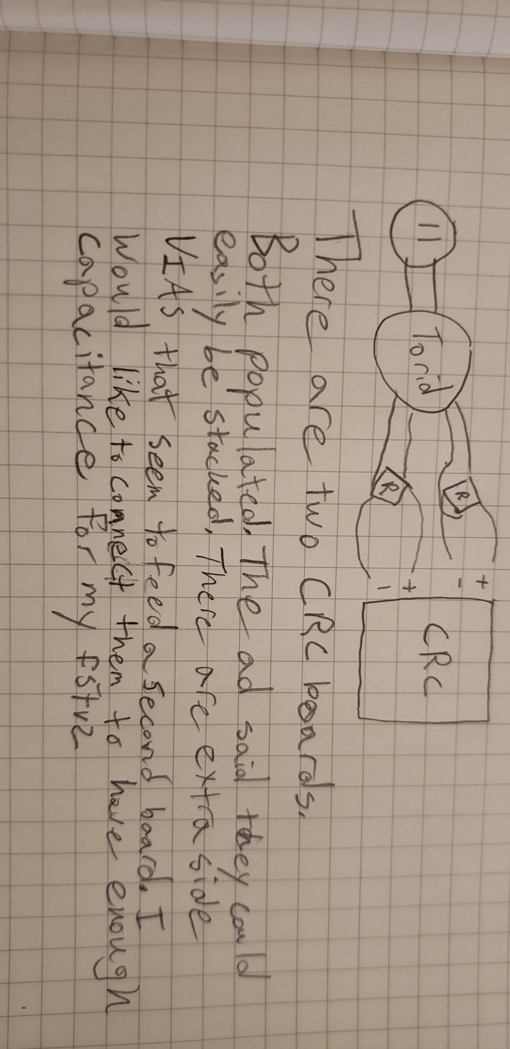

Here is my cruddy drawing and an explanation.Can you sketch up a quick schematic of what you're trying to accomplish? Perhaps start with the the schematic for the board and modify it to illustrate. Maybe a bit of the "why" behind it would be useful also.

Basically I want to combine the capacitance of two boards, as a single board will not power the F5Tv2 without very large (and expensive) capacitors.
If this config is not possible, I will have to order larger caps and try again. I can always use the other caps in a different project.
Also I would like the power evenly spread. I don't see a reason to put it on one side here. This is not a dual mono. I intend to use one power supply for both channels.
I can't find 30k uF snap caps that fit. They're all screw type and I don't want to deal with that really.
Also, the diyaudio store said this was possible, or so I took it. I could be quite wrong and they meant stack for dual mono.
From what I understand, it wouldn't be good to power both boards from a single pair of rectifiers, but I could be wrong. I'm still learning, only been at this a year with no EE training.

You didn't answer the question re: monoblocks / dual mono or standard stereo build.
Were I in your shoes.... I would use each board that you already have, with the caps and parts you already have and build it dual mono. Is that practical for you? The example PSU that Nelson Pass presents in the F5 Turbo article is 40kuF => R => 40kuF for each rail. (page 11)
https://firstwatt.com/pdf/art_f5_turbo.pdf
You'll have 30kuF => R => 30kuF for each rail on each board. If you go dual mono, that (IMO) is potentially better and would be sufficient. However, another opinion or two would not hurt.
If you can't do that, then it does look like the boards can be "stacked" for a parallel cap bank if you want.
See schematic attached. Tie V+ to V+; V- to V-; GND to GND; D+ to D+; D- to D-; etc. etc. What I am unsure of is based on the board layout where exactly the R would fall in the ultimate CRC configuration once paralleled. Someone that knows this better than I would need to help you out re: whether it's most advantageous to populate the resistors on one board or the other or on both boards and/or if any other jumpers would be needed.

It's a standard build. Dual mono would fit if I bought two new transformers (trying to avoid that) and drill a few new holes to mount them.You didn't answer the question re: monoblocks / dual mono or standard stereo build.

Dual mono would be ideal, but I did not plan my first build well.
I had the same issue reading the schematic. It does seem your soldering advice is correct. The resistors also confuse me a bit. They may just need a jumper, but I'd think the resistors would be needed for the second board, with this schematic.

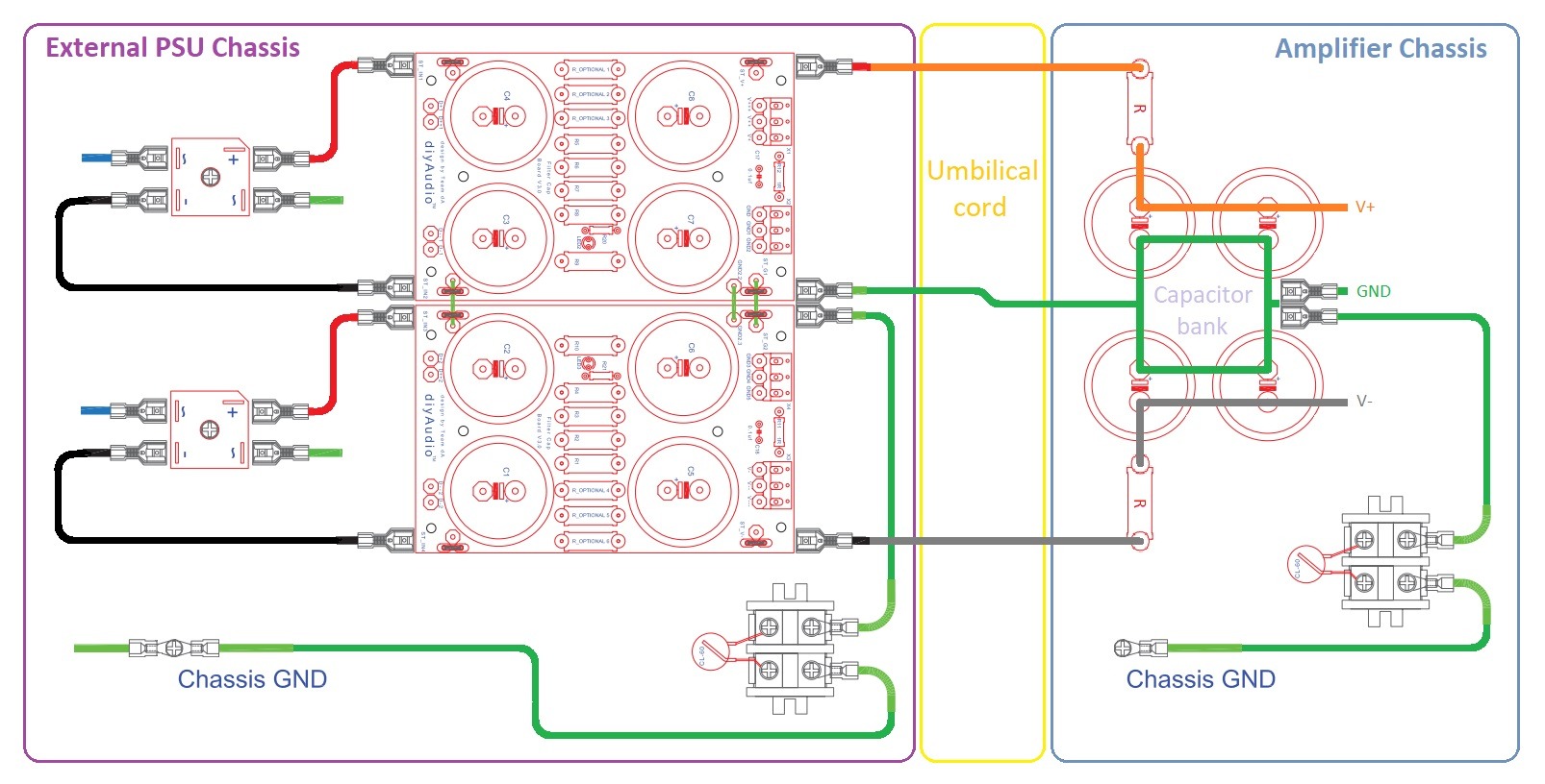

Hi guys,
I'm planning to build an external power supply for my future FW and ZM amplifiers. From what I understand, an external PSU requires the installation of an extra capacitor bank in the amplifier chassis.
Since I'm not absolutely sure how to make the wiring/electrical connections between the two 'sections' of the PSU, I have made a sketch (depicting only one channel) that shows my blueprint for these connections.
I would appreciate any corrections or comments to my sketch.
My external PSU will have 120000uF per channel (CRC - 60mF/0.1Ω/60mF). Will 20000uF per channel be enough in the extra capacitor bank inside the amplifier chassis (RC - 0.1Ω/20mF)?
Or, should I go higher? 40mF? 60mF?

One of my goals for having an external power supply is to use it with multiple amplifiers which saves money on transformers and capacitors. If I were to put the PSU filter board in the main chassis, I would be largely defeating that purpose since I would have to buy all the PSU capacitors for each of the amplifiers.
I am no expert, so I cannot give you a proper technical explanation, but we have extremely knowledgeable members who can explain this to you.
However, I think it is intended to eliminate any noise picked up by the umbilical, as well as to achieve low inductance and resistance supplies.
Furthermore, it seems to be generally agreed that the power transistors should be as close to the reservoirs as possible.

@Analogico if it were me, I'd add a 4th wire to the umbilical for chassis ground and tie the two chassis directly together (ie: no ground-lift back to the capacitor bank in the amp chassis).
Also, there's no need for 4 caps in the amp; 2 will do (assuming you can get enough uF with 2). I have no idea how much uF you need.
