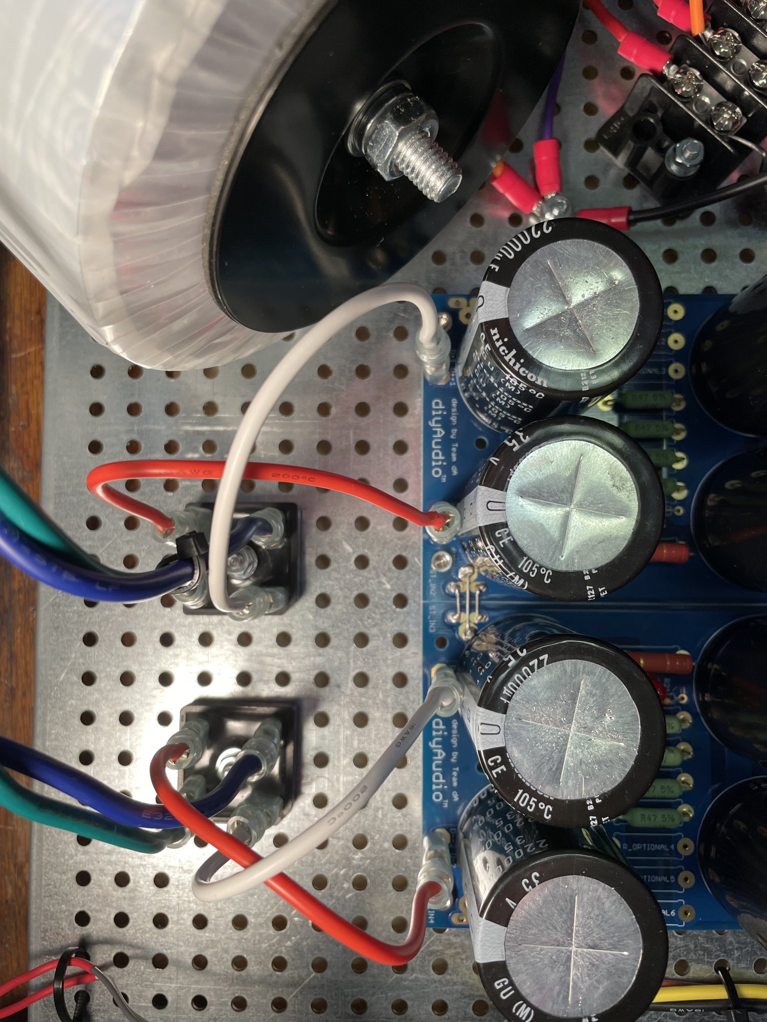

I must be using my multimeter incorrectly. I plugged the amp back in to take another measurement and both sides showed a positive 25.57. I pulled the probes out of multimeter sockets and reconnected them, and both sides were both negative again.
I'm measuring as indicated in the photo tutorial for the Aleph J, from the ground eruoblock to a V- slot on the negative side, and from a ground to a V+ on the positive side.
I'd think that if I really was switching polarity like that my capacitors would be leaking. But what do I really know?

If everything is correct, measuring the voltage across V+ to V- (red to black) should be on the order of 50VDC.
The rectifier wiring looks correct unless I'm missing something.
