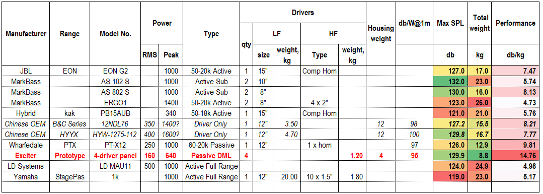

SPL/kg is what I'm chasing!

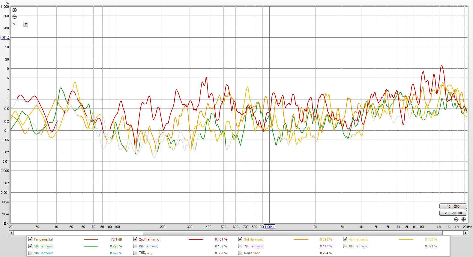

Here are all the distortion curves for the 'blue' panel.
I have not plotted the curves that are below the noise floor (6th - 9th harmonics.) The curves here are masked where they drop below the background noise. I have also not plotted the THD since that is on a previous post.
I'm not totally happy with these distortion curves though. The drivers I'm using (Tectonic TEAX32C30) have had to be raped in order to get rid of the protective rubber shrouds buzzing. I've also had to reinforce the feet that attach to the metal springs. And they're still buzzing a bit.
I'll use Daytons next, possibly the DAEX32EP-4.
Thanks Baldin,
Yes, I did suspect that the 100mm polycarb disc was acting like a piston. But I have measured off-axis responses and they're still better than any dedicated tweeter I've ever used. This implies that the disc itself is still acting like a DML panel. My theory is that the weight of that disc is a lot lower than the whole panel, and will therefore perform better at HF.

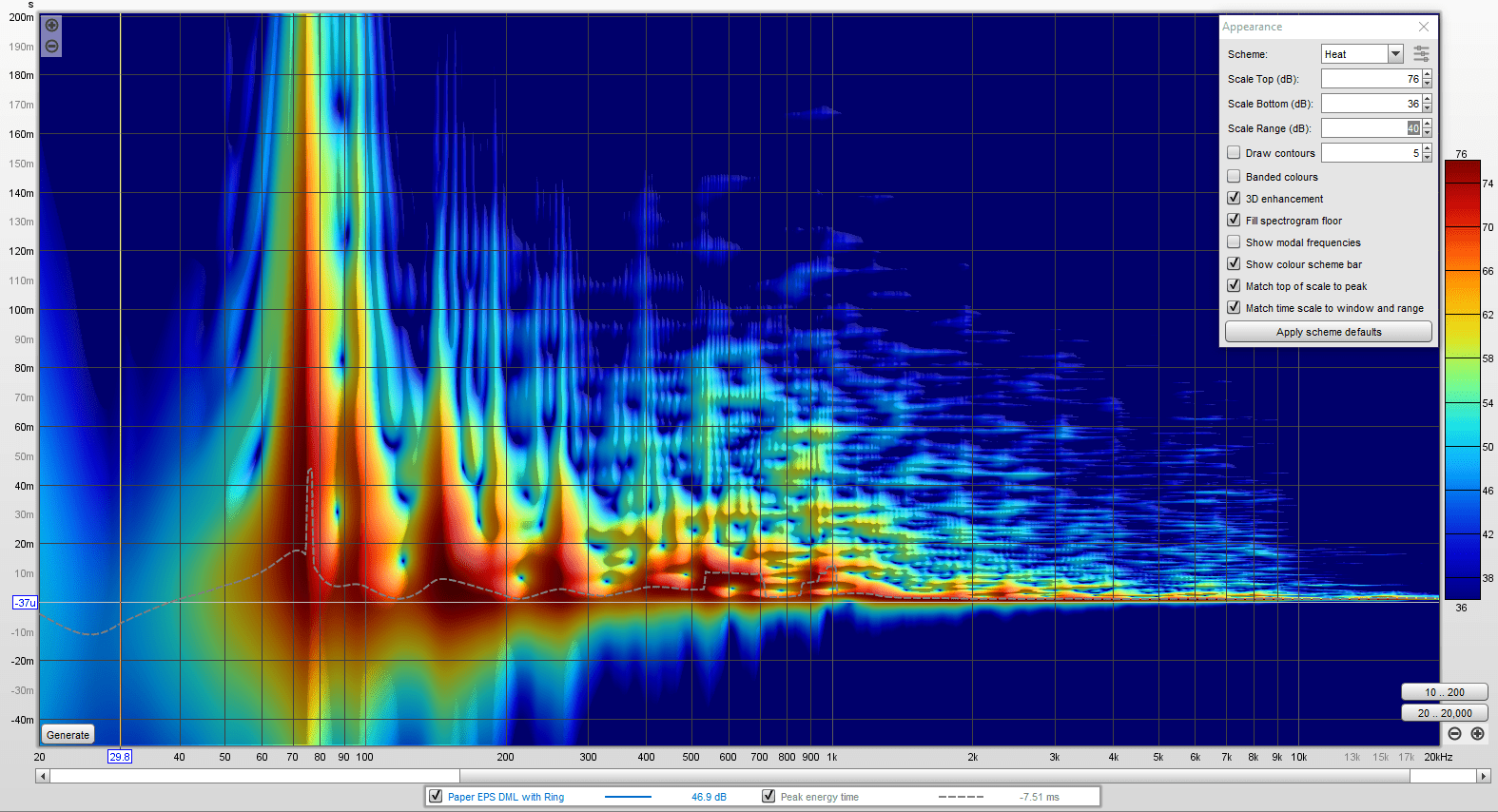

  • This spectrogram is 1/12th Oct.

What is remarkable in the FR of your panel is there is no areas where we can say this is the panel, this the disc. Like if both blend perfectly (blend, is it the right word... some limitations in English...); I see few chance that by luck, the 2 areas match perfectly... Like if we can have a good chance to associate a mid-range and a tweeter choosing them almost randomly.

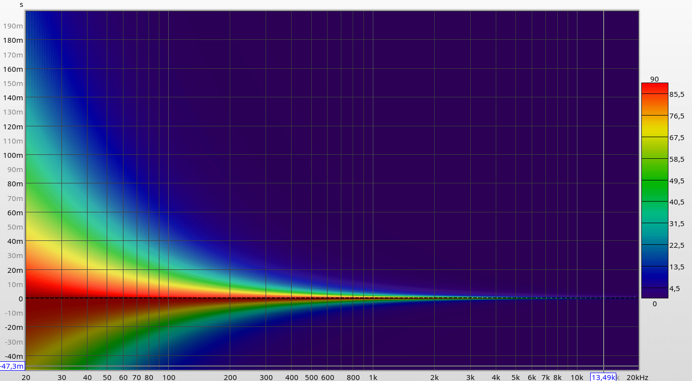

Thank you for the spectrogram.
Here is below the spectrogram of a perfect IR (flat FR). Probably no speaker will give that. It is just to see in comparison the "ringing" frequencies which is typical of DML. We see clearly in your spectrogram that the low frequency modes remain a long time. In this other thread there are some exchanges about the possible consequences (audibility) of such "long tail". Some EQ or LF filtering might change that (if needed...)

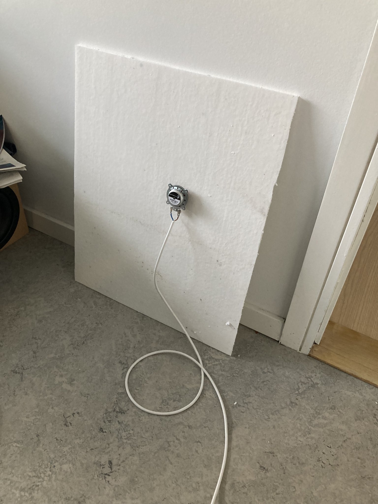

Did the first trial with DML myself.
Plates 48x60 cm, exciter places on 2/5 both ways.
The panels are 10mm EPS with thin wall fiberglass on both sides, and glued with wall glue which is predominantly PVA.
Putting the two thin laminates on the panel made them quite stiff.
Put them into mu listening room and played them in stead of my main speakers.
First experience:
Very efficient, so a lot of sound.
Sound quite thin, meaning a lot of mid frequencies ... consistent with all the measurements I have seen.
I measured the impedance and the panels with the exciter have a lower resonance at 40 Hz
I crossed over to a sub for most of the listening.
I'm sure the freq response can be eq'ed to ruler fit and this would of course have a tremendous impact on the sound.
But what really strikes me is the "stereo perspective or sound stage" .... it just sounds strange!!
I have watched a lot of videos and got the exact same feeling, but really wanted it to be down to recording, but I have a feeling it is inherent in the DML principle.
In a way it sounds like the channels are out of phase ... this strange feeling you get if you play swap the phase on near field speakers (have tried it with my PC speakers as this is super easy as they use DSP.
It's a bit like that.
Or like the sound comes through a tunnel .... but not really the sound you get through a smaller tube (which results in comb filter effect)
And yes I have checked the phase of the panels ... they are correctly connected 😉
Does anyone else have the same experience??
PS. the picture is taken in my office, just for showing the buildup. In the listening room they where also on the floor on a carpet and resting up the wall with a sock in between to make for a compliant coupling
First experience:
Yes they will sound a little thin and 'phasey' when placed against a wall. Give them some breathing room, and then you will hear that there's no pistonic speaker that can match them for dynamics, transient response or sound stage.
There's also the lack of sweet spot. Since they are almost omni-directional, everywhere in the room becomes a sweet spot.
Have fun!
