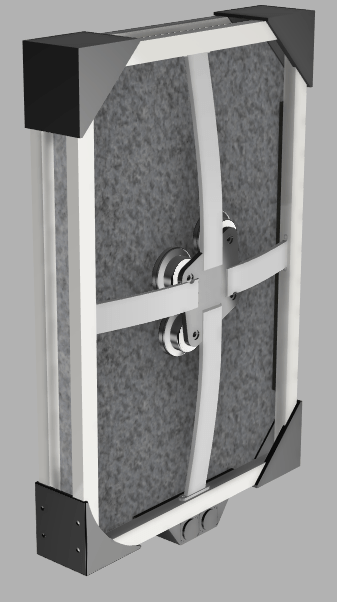

I just got around to designing a suspension system for the exciters, and I tested out the updated plates on a small birthday party this weekend. The subs used was a pair of RCF 9004, and I tested with a single plate per 18" sub using an amp channel with 900w.
I used a 12 dB LR filter at 100hz for the plates, and even when pushing the amp hard they didn't start to heat up nor distort.
So I still haven't found the limit when it comes to power handling, and need bigger amp or test a single 40w exciter with the 900w amp I guess
However after an hour or so playing them at full blast I noticed one plate started distorting. One of the exciters had broken off from the plate, taking a little bit of the GPS with it. So it seems like it is too soft to attach the exciter directly to and can tear up at high enough levels.
Now I used a superglue with a spray on hardener, that has been really nice to use, but it could be that the hardener softens the EPS and it would be better to use a usual two component. I'm hoping that it will be enough to enforce the exciter area a bit. Possibly with a thicker layer of shellac or some epoxy, but worry it will affect the sensitivity. Perhaps a thin sheet over the exciter area of a less dampening material, like balsa, would be better.
Or it might indeed be the case that a CF composite is what is necessary to keep up with the stress.
Otherwise I'm quite happy with the design now. They are still stackable and the suspension offers some protection for the exciters.
It would be nice to add grills for a bit of protection...might print out something for that as well.
Will do some pics and graphs later.
So I just touched on this in previous post, but at least if you gonna hit them with far over the rated power, adhesion seems to become very important as the forces can become very strong. A good epoxy or superglue is probably best, and making sure that you enforce the exciter area a bit if you are using EPS/GPS to spread out the force. The included adhesive or very thin double sided tape will probably hold up well, but think it can affect treble response a bit being a lot softer than a synthetic resin glue.according to what is the best way to stably attack the exciters? I was thinking of using the resin or maybe continuing with the adhesive but sooner or later it loses its adhesion. I would also like to make a case on a kind of frame with back support to hold the exciters. Some idea?
I designed 3d printed parts to hold the exciters in place and with channels to pull cables through neatly, and added an extension at the bottom for speakon connectors. Will post actual pictures later as promised, but here is a rendering of the design for now.
I will be happy to share design files, and might even considering offering printed parts or assembled speakers in the future if I get really happy with the result and there seems to be interest.

Not sure I understand the question. Are you asking about how to create a frame for suspending your carbon-nomex plates in?
My solution does use wood and is still quite light. I could replace the wood with something like glass fiber and make them a bit lighter, but not worth the cost and extra work IMO. They feel both light and sturdy as they are.
But would consider alternatives if doing series production or for a certain look.
I initially thought that the frame had to be a lot more solid, but was surprised how little rigidity seems to matter and how little the frame vibrates. Thin strips of regular wood is more than enough, it just needs to clamp the plate slightly for dampening.
