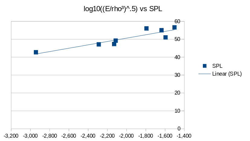

Hello André,
I made some archeology thanks to the advanced search function. See :
- #5449 which introduce the D/µ³ (link to papers)
- #4664 with this very nice graph from my test (more posts in this one : #4201, 4203, 4256)
The graph is SPL@2m for different panels I tested according to log10(E/rho³).
Single point on the left : acrylic
3 mid points : different plywood
4 on the right : EPS/XPS
By the way, this graph is not listed in the history file... I am going to correct that.

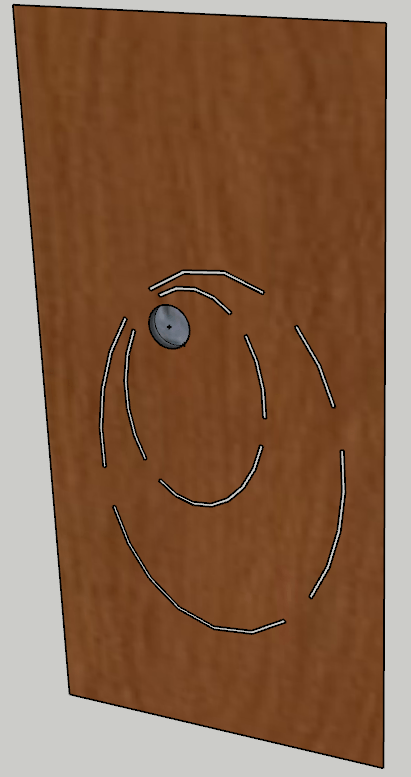

I have tried a quasi-"three-way" panel running from a single driver as per attached pic, but that needs a helluva lot more work. I didn't spend enough time on it.
Is it a CAD picture or have you done some tests? Any FR?Indeed. I'm using a single driver but which seems to be working in different bands because of different mechanical impedances presented to it. The fascinating thing about it is that there seems to be no loss of efficiency between the different systems at play on the panel.
Yes that is a CAD sketch of the panel that I eventually made out of EPS. But the FR was so bad I did not bother going further.Is it a CAD picture or have you done some tests? Any FR?
I tried something similar with Correx. Same problem: The FR is atrocious. Besides, Correx is way too heavy to be efficient.
The principle behind the offset ovals is that, in a baffle with a pistonic tweeter, the edge diffraction is almost completely neutralized if you put the tweeter in the correct position.
But it absolutely does not seem to work on DML panels.
