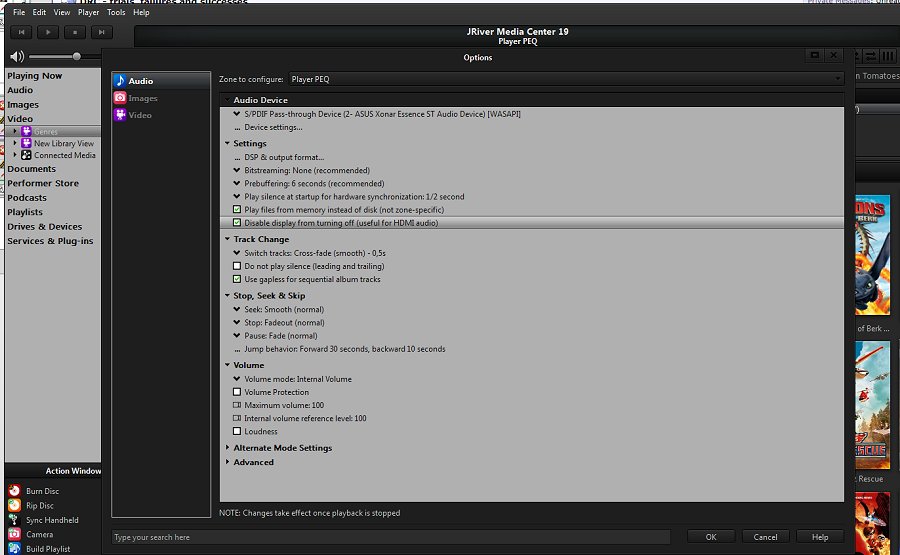

How do you get the convolved signal recorded? What devices do you use in REW and JRiver?
I'll tell you how I do it. I run REW with my Asus soundcard for playback and recording. No speaker is hooked up to that card. Only the microphone on the "microphone in" is connected. The Asus card is set as the default audio playback device in Windows. (very important!)
In JRiver I have my separate Musical Fidelity DAC setup as the playback device. That one has the amplifier hooked up and powers the speakers. To get sound from REW trough JRiver I choose "File" -> "Open Live" in JRiver and choose:
"WASAPI Loopback"
Note the text under that option: "play the audio going to the default Windows soundcard trough the JRiver engine"
That's the routing I use, for both the pre convolve stage and to check the convolution after generating the files.
When I run the REW sweep, REW powers the Asus card and JRiver picks up that signal, runs it trough it's DSP engine and out to the sound device chosen in JRiver.
Without the two separate sound devices I cannot see what the convolution stage is doing at all.
You need to make the soundcard that REW is using the same as the default Windows sound device and JRiver needs to be setup with a different output sound device. Only that way you can steer the sound trough JRiver's DSP engine.

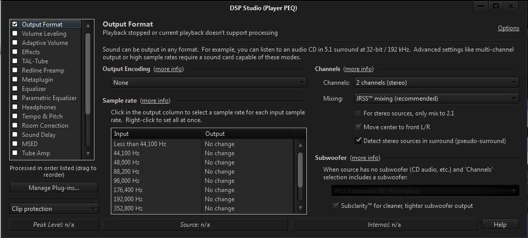

To run without convolution I just remove the [v] in front of Convolution in the DSP engine in JRiver.
Do you have it setup like that? An on board sound card can be used as output in REW (and set as the default Windows device for playback). It does not do anything, it's just a transport for JRiver to pick up with it's loopback feature.

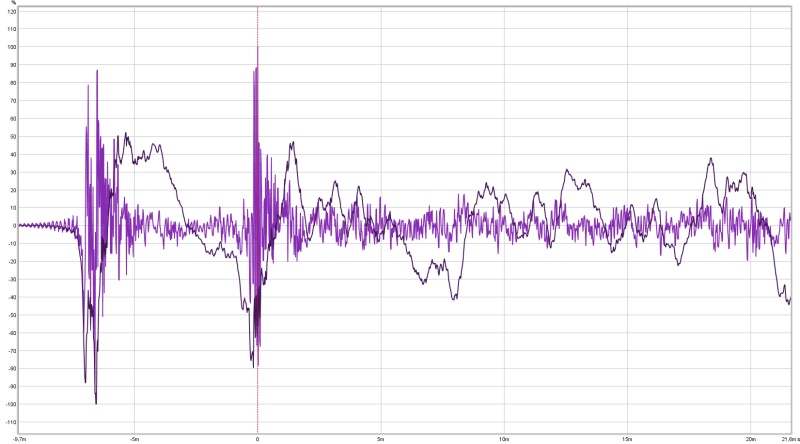

Your impulse looks like this when routed trough JRiver with convolver set to on:
That second peak at "0" shouldn't have been there. You can see by the wavy start of the impulse that convolution is on. This looks like a stereo measurement due to the 2 peaks at -6.93 ms and -6.52 ms. But where is that later peak coming from? The one that REW tried to center?

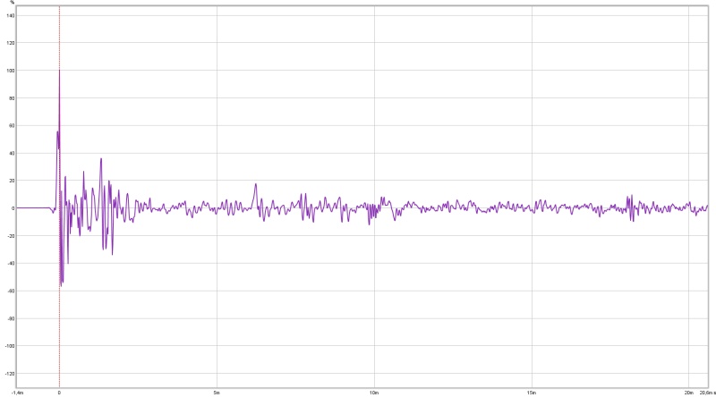

The roughest impulse from one channel in my setup looked like this:
![right%20impulse%20with%20eq.jpg](https://www.rsr-concepts.com/diyma/right%20impulse%20with%20eq.jpg)
It's more zoomed out than yours making it prettier but still, a large difference.
After convolution it looked like this:
![right%20impulse%20with%20eq%20and%20convolver.jpg](https://www.rsr-concepts.com/diyma/right%20impulse%20with%20eq%20and%20convolver.jpg)

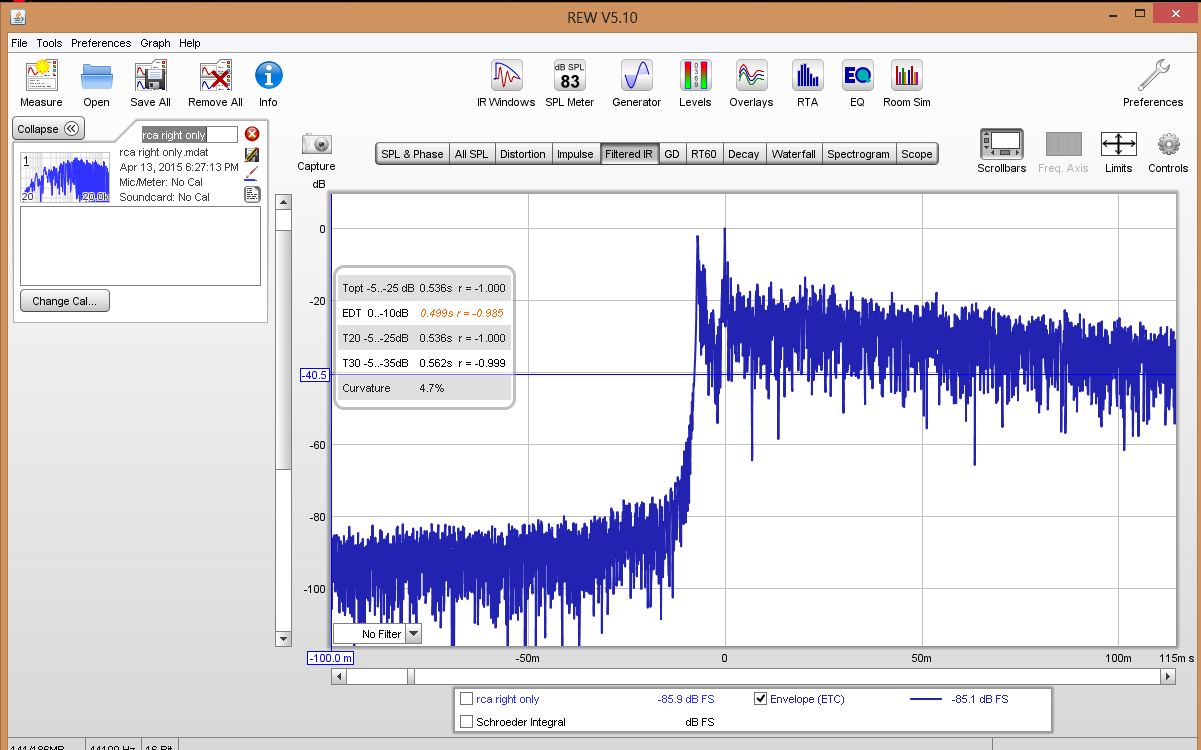

One more question I haven't seen answered. Is the output device in JRiver the AudioBox Asio driver? Somewhere within all this is a repeat of the signal. We need to find out where it's coming from. Once we solve that part we can move on trying to correct something.
Just another thing, don't get hung up on my posted impulses. You have a totally different kind of speaker that has a whizzer cone. It's likely to be a bit rougher and not a clean single spike like I get.
The one impulse I found while googling your driver looked similar to the right channel impulse from your first set of measurements.
The one that looked like this:
(your original right channel measurement)
We need that result or close to it, but routed trough JRiver. Only one channel at the time is fine for now, just to be sure we don't get added information when routing trough JRiver. Once we have that we can move on.

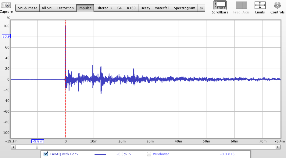

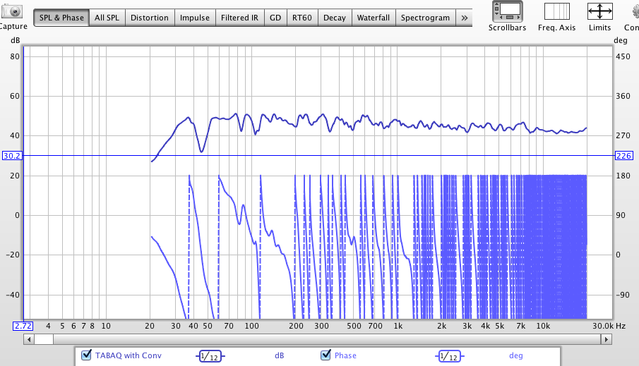

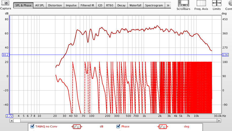

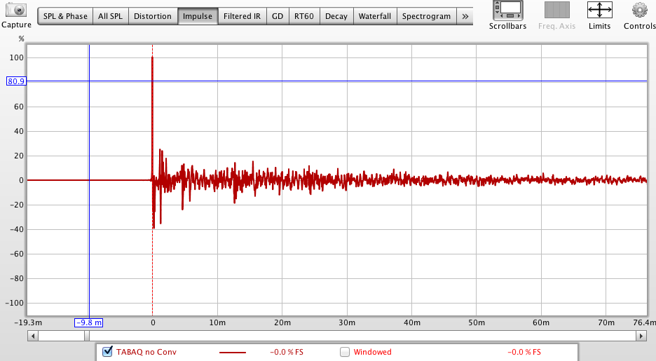

Thanks for the pics!
So, I followed the routing above, used only format and room correction in JRiver, then ran a REW sweep for the right speaker only.
Here, you see the impulses... all taken at the same ear level, the first one, the mic is moved to the right side, the second one is at the center and preferred listening position, and the last one is moved to the left of the couch.
I still have that double impulse, but as you cane see, when the mic is at the center, there is a peak before 0, but moving to mic to either the right or left, the first peak is at 0.
https://www.dropbox.com/s/ut84ix68iekf1r7/right only.mdat?dl=0
Okay, not that it helps us find the source of the second peak we are getting yet but there are some strange things to notice. The time differences between peaks changes with the moving of the mic. If JRiver was causing the double peak I would expect the same difference between the peaks. It looks like something else is playing along. Mighty strong signal for being a reflection and as it doesn't show up in your original right channel it has to be something else.

Please answer the following questions:
What is the JRiver Audio device (where mine shows S/PDIF):
What do you have in the Format tab:
(no 5.1 output just yet do you have it set to stereo 2 channel?)
And what's so important on the Room Correction tab that you have that set to on? Can you show us a picture?

I did look up if the mic's Listen to this Device is unchecked, it is. And just to make sure, I sent the Listen to the optical output, which is unused.
So, I'm going through the settings, which were set as you mentioned, but.... I see that the JRiver output went to 5.1 surround... Eh? I swear I didn't change it to 5.1! It's like it's settings didn't stick and when I opened it up again, it reverted to 5.1... very strange.
The Audio Device is the AudioBox Asio driver (Asio). I guess I have to change that to Line out 1/2 (5-Audiobox ) (WASAPI) ?
So, I made those Puss in Boots eyes to my wife and got a 1 min window to do a quick sweep with these settings:
- In Sound control panel, made sure Listen to this Device is unchecked. Output is sent to Realtec Digital Audio
- In JRiver DSP section, Format, selected 2 stereo channels only. Nothing else is checked, no room correction, nothing...
- In JRiver Device Audio, I selected Line out 1/2 (5-Audiobox ) (WASAPI)
- In JRiver, I went to File, Open Live, and selected the WASAPI loopback, clicked ok.
- Physically unhooked all output connections besides the right channel on the Audio Interface (Audiobox)
- In Rew Prefs, Output is to Realtec Digital Audio, Input to the Mic
- In REW, opened Measure, checked levels to be ok, and recorded a sweep.
Lo and Behold!
the double peak is still there....

First, let's start with what I believe is good news.
Here are some graphs of the TABAQs before (in red) and after convolution (in blue).
Is that what convolution looks like?
The filter was far from great, as I just went flat and 20 to 20,000... which the smallish 3" drivers couldn't take that low, I had to lower volume a lot because the drivers were rattling trying to reach 20Hz. I think it is also the reason for the extra peaks on the impulse. A better filter would probably look good.
The bad news...
I moved the Mac downstairs and took measurements.
The double peak is still there.
Since I have a couple of djembes on the same plane as the speakers, I thought maybe they would pick up some sound waves and resonate. So, I carried them out of the room. But that wasn't it. The double peak remained.
I have a couple of other ideas to try, but that will have to wait as it is past midnight here, not a good time to do sweeps!
