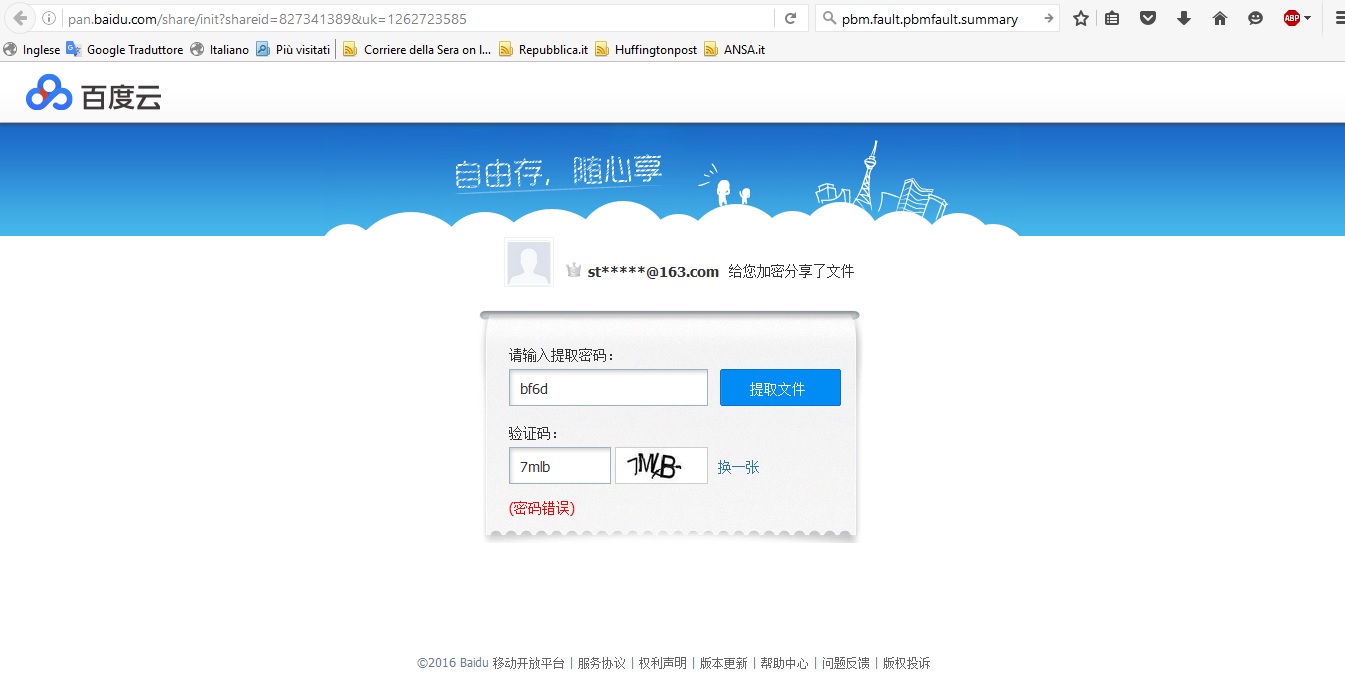

link download driver for Ustar usb http://pan.baidu.com/s/1c20n7yS
password: bf6d

Thanks but it doesn't seem to work.
I'm not able to undestand the error though:

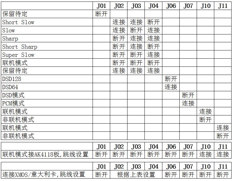

Hi guys , have my AK4137 AND DUAL 4495 board up and running but volume is very low and is louder on the right chn than left.
The only way I get sound is with jumpers 10 and 11 closed.
Jumpers 8 and 9 from the old pin config diagram, for running in dual chn mode are not present on the new dual 4495 board.
Help!
Help!

Use those blue trimmers on position (VR01 and VR02) to adjust output level per each channel...
regarding jumpers, those originally provided where taken from single board so your current pin 10 and 11 should correct to use

Finally got it working by removing 10 and 11 and jumpering 2,3and 4 . I guess it is working in offline mode but at least it is making music now.
I had a further look at using a remote but if you follow the traces from the sensor position there are 3 pairs of smd pads for resistors or capacitors which are not filled so I don't think remote control will work with the AK4137 board. Can you ask the designer if this is the case.
