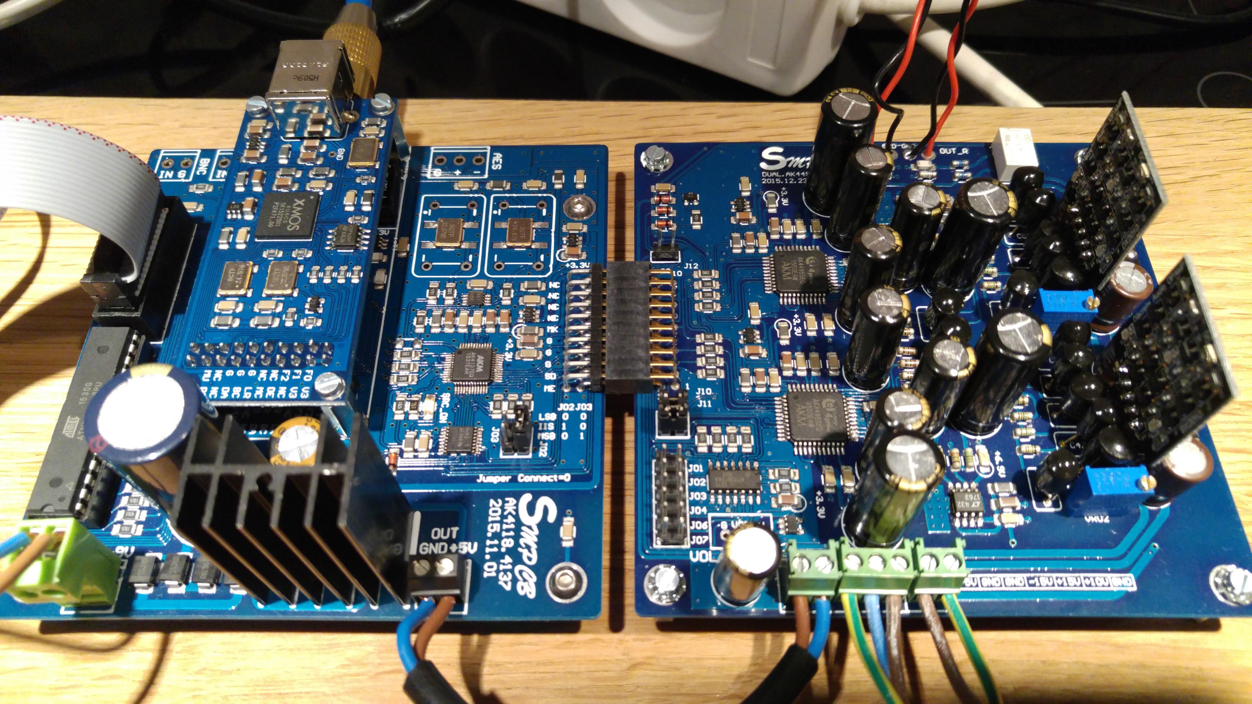

Well that was a bad day. While wiring in a new psu some solder got on to the 4137 board and I didn't notice. On power up the magic smoke came from 2 shorted diodes killing the board and possibly the dac board too.
Now to save up another $300 au to replace the boards :(

Hi
I have finally assembled the dual AK4495 board with Pan. FM caps for dac and Silmic and AMCH caps for the analogue part with a NewclassD discrete opamp.
I have tried the AK4137 seperately and it was working with the another dac but when AK4495 is connected then no sound at all ...independent of output sample rate...
J02 on AK4137 is set and j10 and 11 is set on AK4495...
Any clues to the sound of silence?
