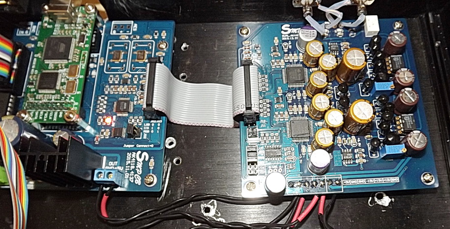

Hi Gordon,
why you have selected MSB instead of II2S on your SRC board? J02 jumper is on right side not left side, make your ribbon cable as short as possible, other than that I don't see any trouble with it, my LCD board contain all smd parts for remote operation, I tried it and it works, did you get your LCD board with 1 or 3 button board? the only command which doesn't work is volume control but I didn't have it connected to my DAC board so it might work only when connected, not sure...

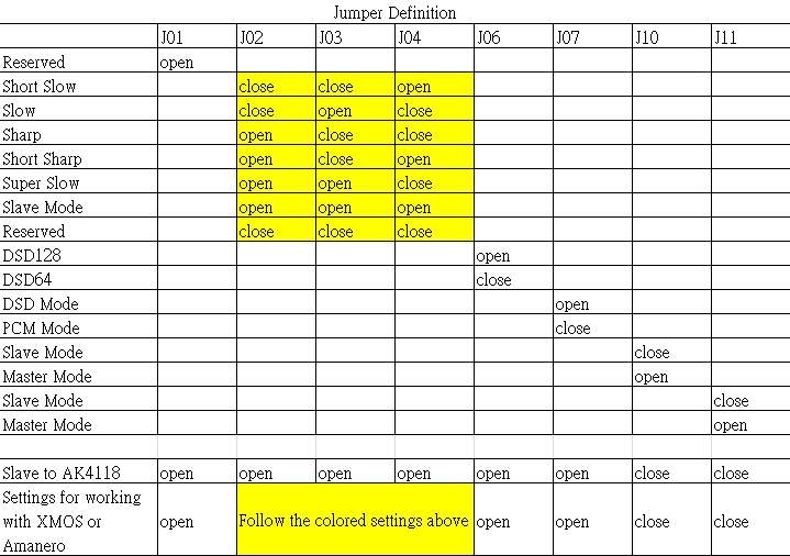

Hi Daniel , the actual jumpers are JO3 on the left and J02 on the right ,, which is the reverse of the legend printed on the board. Legend on the board says 0= connected , so I have J03 connected and JO2 open which is correct for I2s as I read it ?.Hi Gordon,

Made a really short ribbon cable b4 the board arrived but appear to have lost it in the mess that is my office
Lcd board only has one button so I may have bought the wrong 4137 board but don't really need remote on the dac anyway at this stage.
Thanks again for the help.
Got a Bellson 2.5 amp reg to replace the 7805 on the 4137 board and will look into better clocks for the SRC as currently up sampling seems to hamper musical timing/fluidity.
Hi Daniel and Gordon
On my AK4137 board then the legend is J03 on the left...if I look at it a the same angle as Daniel's picture..
I have tried jumper on J02 and feed into a Opus WM8741 set to IIS and there I could select SRC upto 96khz and still getting music out
Setting jumper on J03 and still into a Opus WM8741 then I could only select 44khz...
I don't understand why Opus Dac can't go to 192khz as the dac supports..any clue to that limitation?

It's all a bit confusing what with the strange layout of the jumper legends and the lack of a full translation of the pin config table.Hi Daniel and Gordon
