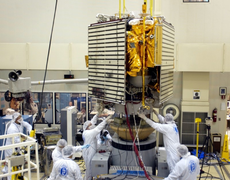

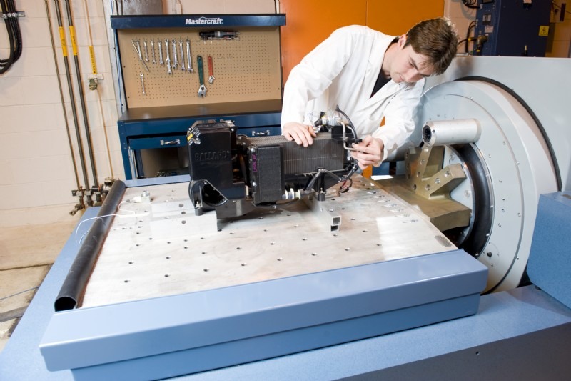

Yeah they are enormous devices. For us, in some cases the 'slip table' is used which is a large plate of aluminum (say 8'x8'x2") bolted to the armature (speaker coil so to speak). It slides on a thin layer of oil sitting on top of a granite plate. The plate is only used in-plane so it is extremely stiff and is almost always a lot heavier than the test article.
In other cases the armature is rotated vertically and the test article is bolted to it directly, no slip table.
In all cases there is a control accelerometer attached as close as possible to where the test article attaches to the armature/table. This provides feedback to the control system to make sure the actual profile is what you specify; it is closed-loop feedback essentially.
This will give an idea of the size of these things for those who have not seen them. They come in large, and larger. Images from Unholtz. The second one is an entire spacecraft sitting on top of the armature/coil assembly (the huge grey cylinder on the floor). The shakers are used to simulate rocket launches which are really hard on the spacecraft and instruments; in most cases it is the #1 thing that drives design strength and stiffness.
The bit that the satellite is sitting on; we had both the round and square top versions. I'd forgotten about the ship table! Even though I'd helped unbolt one at least once.
Those were interesting structures, from the POV that you could see the engineering to make them non-resonant. Push on a small area, translate that to a big area where motion is the same anywhere on its surface. Could that thinking be applied - somehow - to a DML design?
Looking on-line, I see they still - even with all that bracing - have a specified resonance and an upper limit on the frequency they can be used. After which I assume they go modal where - despite the structure - different locations on the surface begin moving differently; like a drum head does. Isnt physics wonderful?
