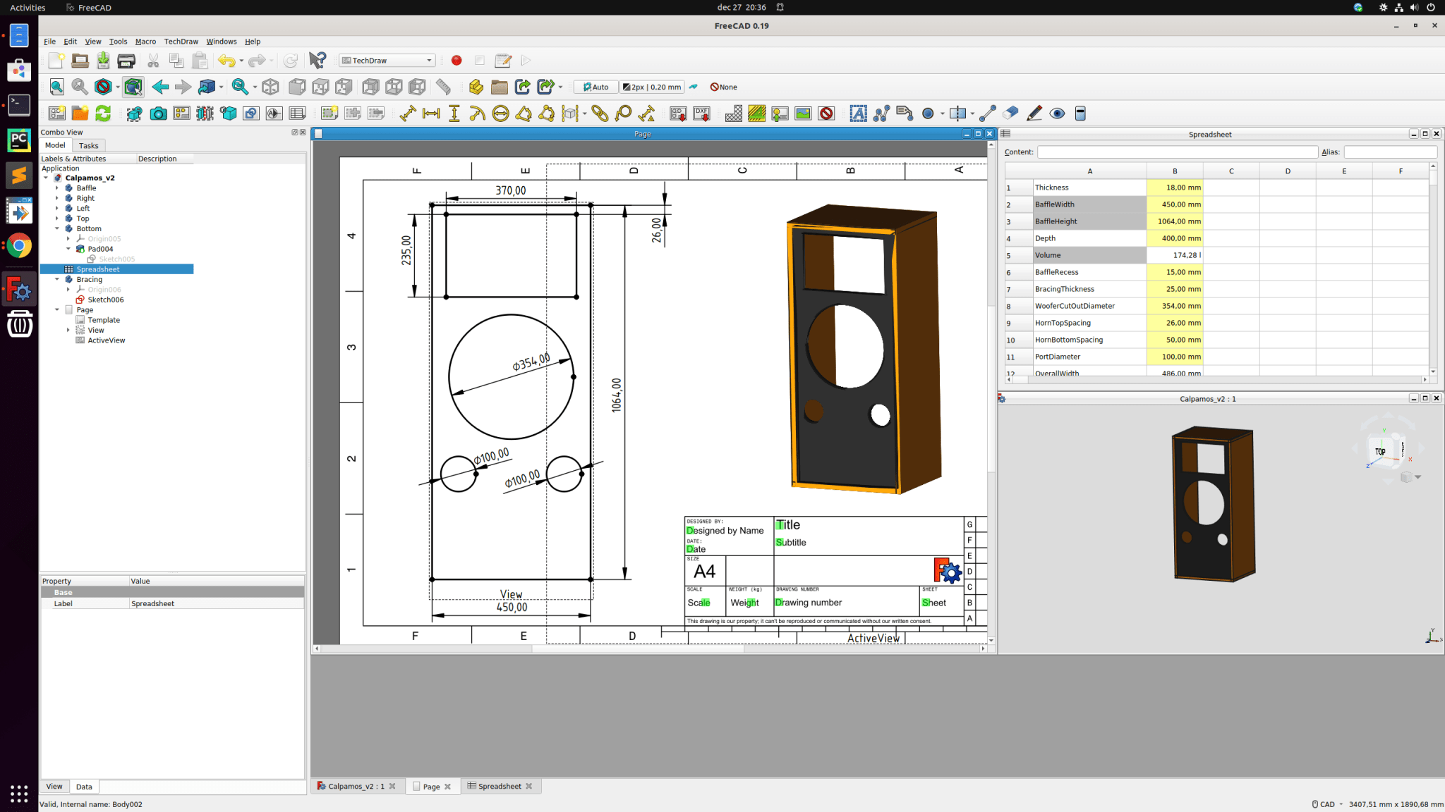

My first adventure into the 3D CAD world:
Learning curve of FreeCAD is quite steep, but I just might start to get it. Enclosure is parameterized. The spreadsheet controls everything. Should allow me to switch between high/deep Calpamos, 12" versions, ...
A friend of mine works for a company that sells woodworking machines. I can use their demo CNC machine (for a six-pack or two I guess).

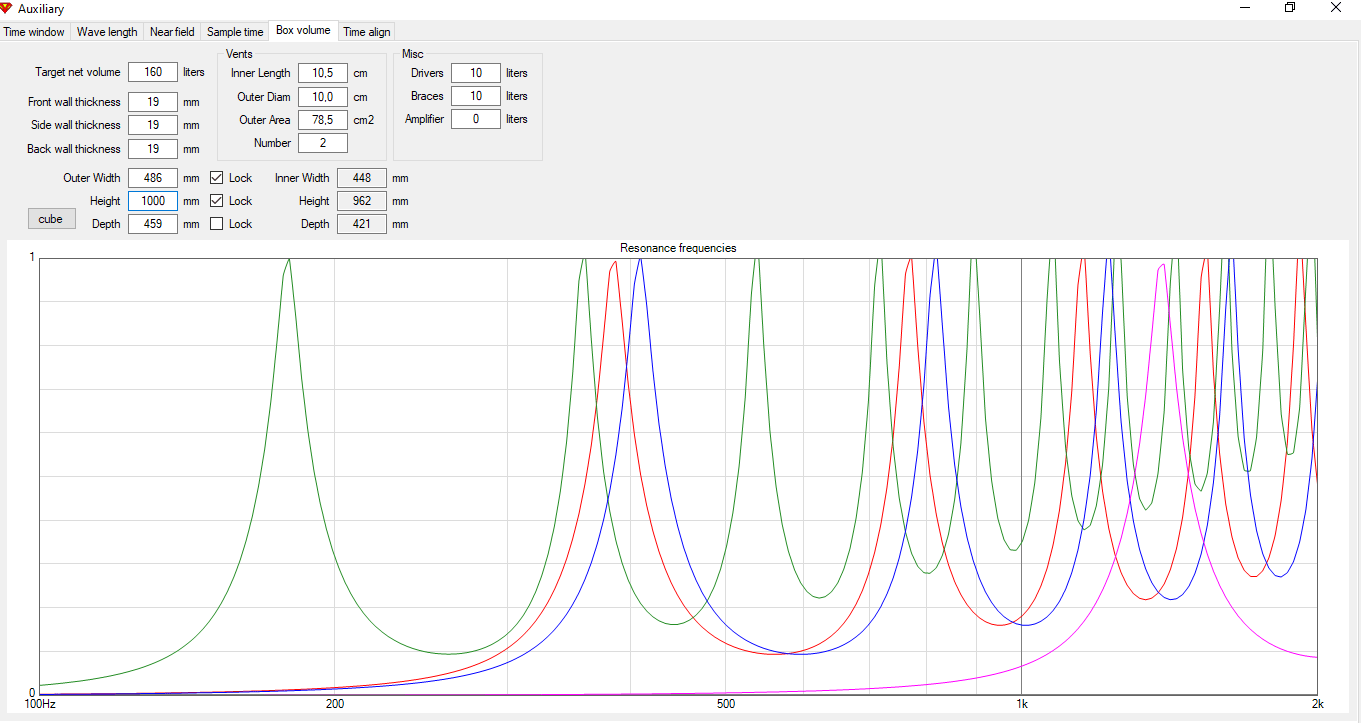

Nice for construction, but for prototyping, I would first have a look at VituixCAD -> Tools -> Auxiliary -> Box volume. There, you will have a peek at standing waves and how they add to one another with certain ratio and internal volume.

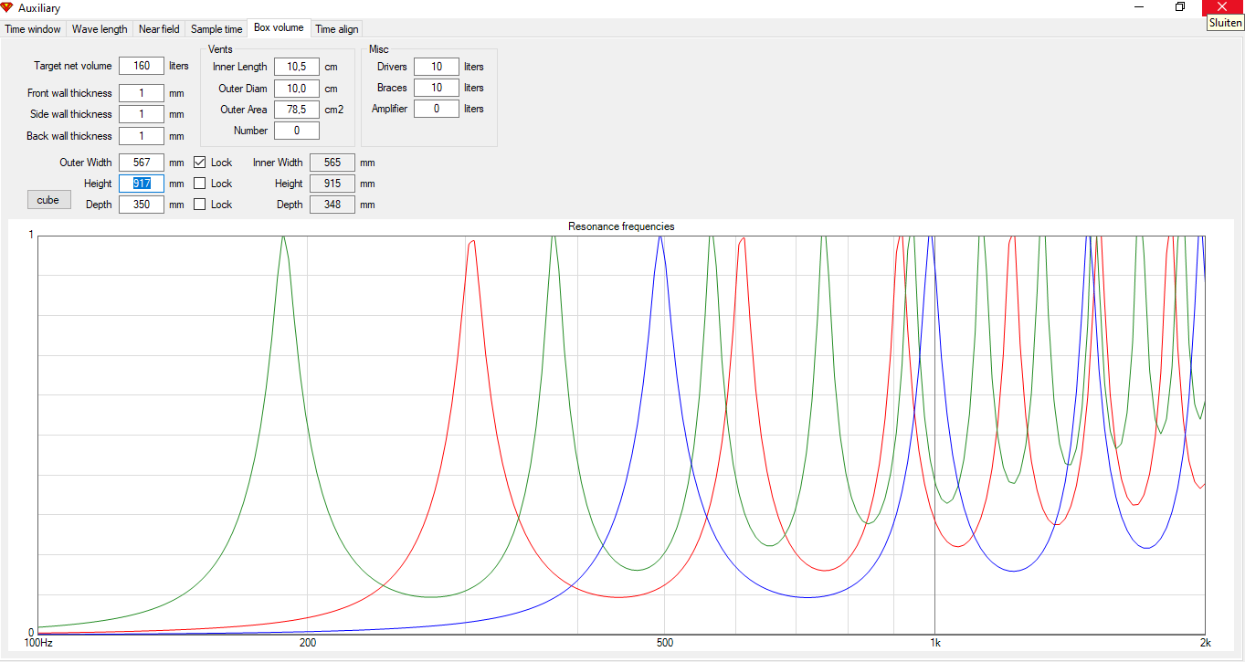

I guess I need to spread the resonances. Something like this?
They don't look that well spread, the height is very close to double the width and depth. What GM says above is correct from an internal perspective.
Diffraction can also be affected strongly from dimensions that are similar to half dimensions being repeated.
The golden ratio of having dimensions 1.618 : 1 can be beneficial in breaking this up if it becomes practical.

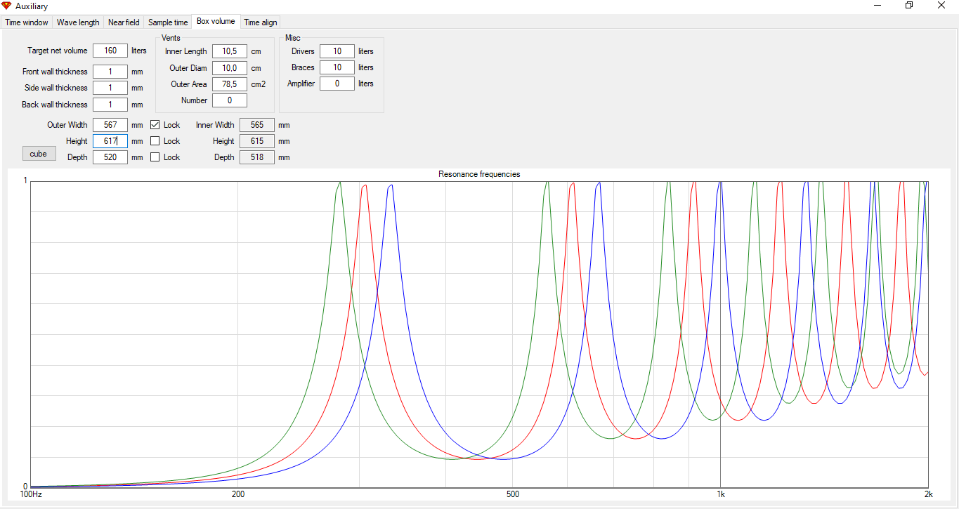

I've written a quick and dirty script that optimizes the ratio in order to have peaks as far away as possible from each other.
Here is the golden ratio:
And here is the optimum that was found (1.088):
Although the lower peaks are more evenly spread for the golden ratio, the 'optimized' variant does better in the region f > 900Hz.
That does the opposite of optimizing as far as I am concerned. As frequency rises the modes will get closer together naturally until there is so many you can't see them any more. It is why above 1k in room the speakers response is the dominant factor. Below that the modes spread out more and more gaining more power. Having three spaced closely together low in frequency will make the combination problematic and harder to absorb due to reinforcement.

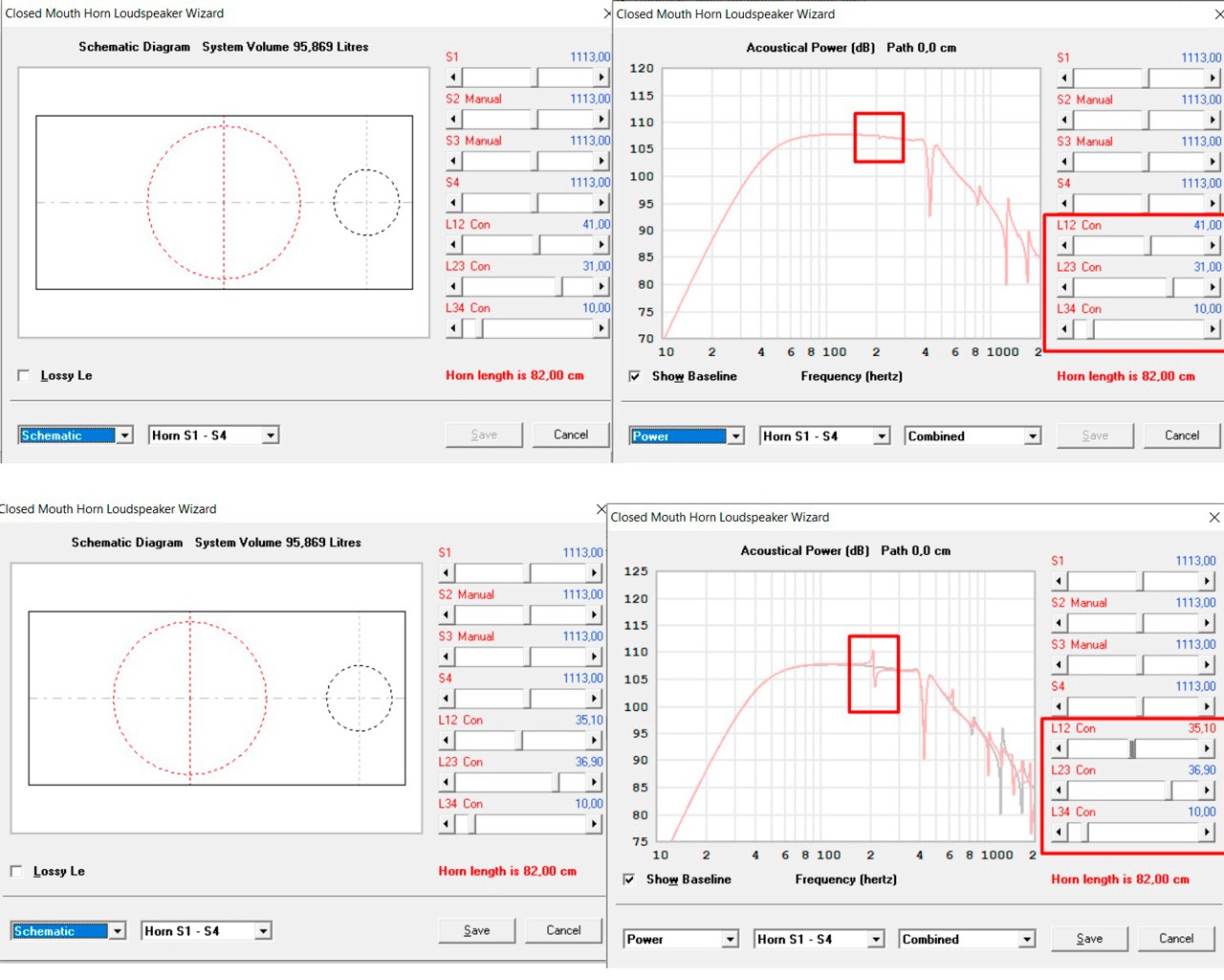

Tom, About box internal modes: the higher modes (say around crossover frequency) dampen easier (more) with damping material than the lower ones, whose wavelength is longer. You should be able to minimize the lowest modes by placing the woofer in the middle of that dimension, at least this is what happens in hornresp models. Put the woofer middle height if at all possible. In reality your horn robs internal height some so perhaps difficult to hit the sweet spot first time. If problem at all.
Prototypes are great. Make a quick one, if there is no measurable and audible issues with the internal modes then there is no problems. If there is you have a chance to do something about it 😉
