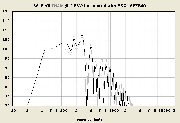

my subs will be having a frequeny curve similar to this:
i will not run it on low power, i will max them out
