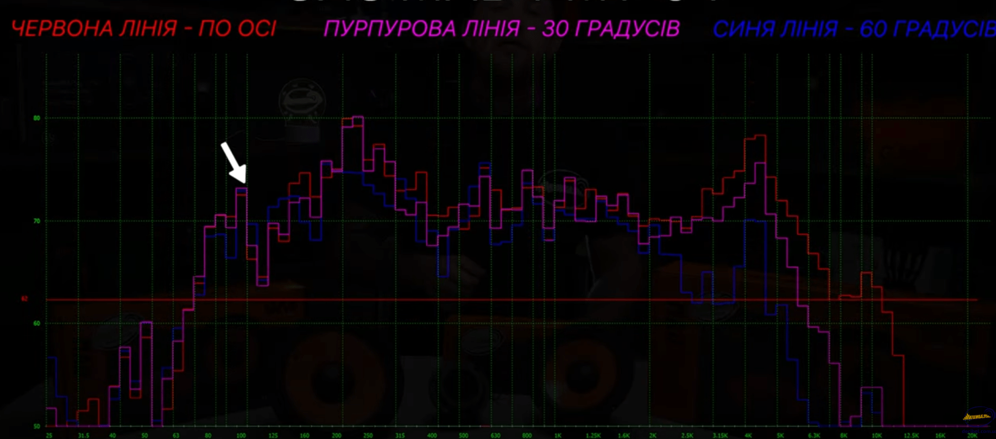

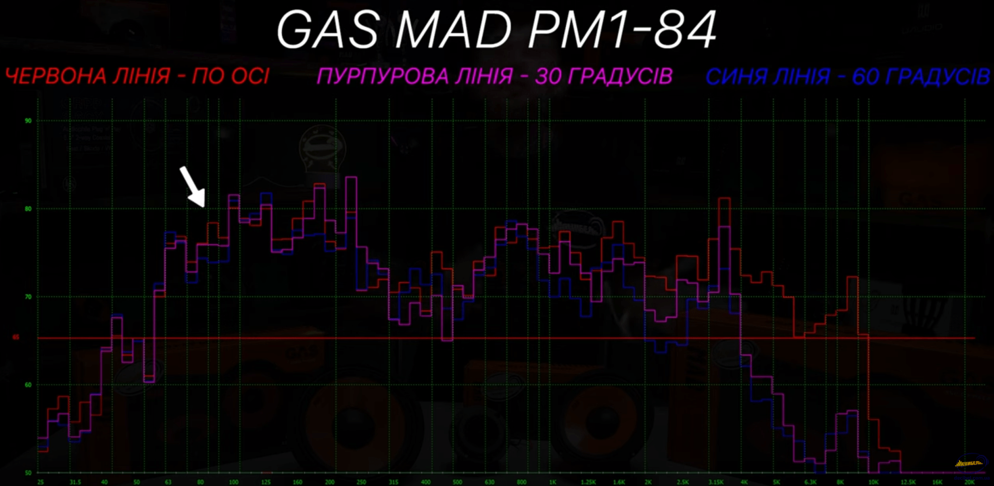

What about 32/64 of these? https://www.brl.se/sv/artiklar/madpm164.html
Very cheap. 10-13 euros/piece in bulk

i also got a quote on these, 32 of them for 350 euro!: https://www.brl.se/sv/artiklar/madpm164.html
honestly, i think 32*6.5" would be loudest, don't you think?

32 of the orange driver would be the loudest and probably have the look you're after. The concern would be how long they can survive playing at max spl on a hot day. Running them all full range will have some bad sound problems but if you just want super loud at the expense of everything else, then it should accomplish that.
