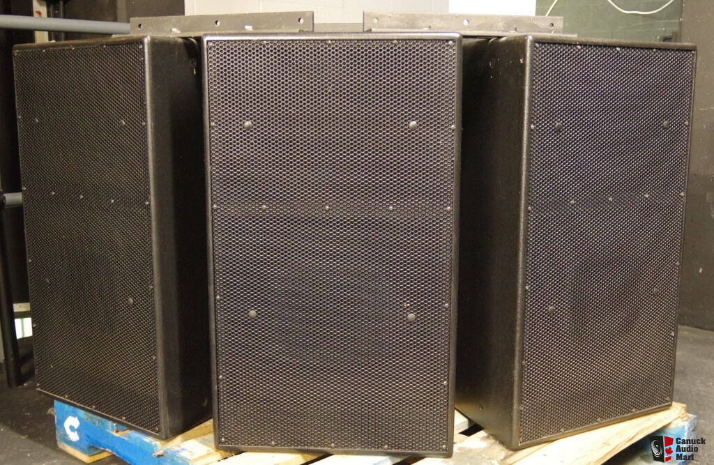

It may be counter intuitive but the wider you make a cluster of driver the narrower the coverage, the ideal driver stack is a single tall line but that type of speaker system is not always the best solution.
A 2" exit CD might be a step too far for what you want to do, I don't see a compatible horn for it anyway.
Power handling for most compression drivers is irrelevent so don't get hung up on that, nobody puts hundreds of watts into one unless they are building a weapon.
Those 8's are somewhat interesting, they look like beasts but have low sensitivity so not a great choice.

If I were you I would sell the out of production bass you have and buy one more of the other still in production and build a pair of small top from what you have then with the two then same type of basses and the tweeters I’m sure they will work fine for the application in mind, 40l should be enough.
Yes, those drivers with a pair of 12's in cabs like these... https://www.speakerplans.com/index.php?id=x12but sticking to these would be fine? https://www.brl.se/sv/artiklar/ds18-pro-dr1pk44-1tums-driver-med-horn.html

Optimal deployment of boxes side by side looks something like this, that is he splay I menioned earlier. Trapazoid shaped enclosures are better for this but it can be done with rectangular boxes too.
Yes a passive 2-way crossover will make these easier to use, I suggest you zero in on the best settings with the DSP first and try to replicate that with the passive filters.
