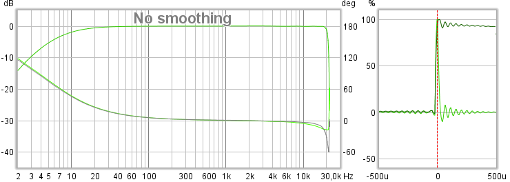

Maybe below stuff have interest here, until few days ago only owned their simplest DAC chip ES9023 in form of a HifiMeDiy SABRE USB DAC UAE23 without asynchronous USB buzz, it has been a pleasure having it because musical performance was top notch used as dedicated headphone listening setup. That chain was a Win7 notebook with 64bit JRiver set to using WASAPI and do R128 algorithm tracks leveling plus Equal loudness ISO 226-2003, then a headphone amp HP-1 (tomchr design) loaded with HD650 cans. Upgraded lately to a Zoorloo ZuperDAC-S with real ES9018 not ES9018K2M including asynchronous USB buzz and was disappointed because yes expected more analytic sound but at same it was so non musical. After some comparison measurements into REW it revealed phase domain looked weird not being minimum phase so after using REW's math tools to get me a difference from minimum phase curve it was possible create a pure phase correction filter over in Rephase loaded into JRiver convolution container, and wow that filter helped a lot on natural foot tapping and musicality for this case : )
ES9023 benched at 44kHz, looks okay in that grey trace show theoretical minimum phase curve that belong to that green amplitude curve is in coherence to green phase:

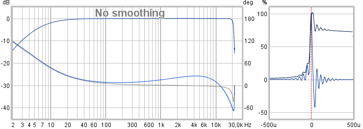

ES9018 benched at 44kHz, show a weird phase domain far from grey trace that is the theoretical phase that belongs to that blue amplitude response:

Very interesting.
How did you get the plot? Which software?
Good weekend.
Ian
Thanks wishes for weekend and same to you and readers, agree its interesting but also irritating why its looks so if its true direct sound by nature are more or less mostly of minimum phase behavior, why should a reproduce product then change cycles of time domain inside audio band and manipulate with original harmonics of recording.
Benchmark/plot software is free REW its old site is here (LINK: REW - Room EQ Wizard Room Acoustics Software) but latest versions and support forum recently moved to AV NIRVANA and needs user to register there (LINK REW downloads: Downloads | AV NIRVANA) (LINK REW support forum: Official REW (Room EQ Wizard) Support Forum | AV NIRVANA).
Software used for linear or minimum phase filtering corrections are free Rephase (LINK: http://www.diyaudio.com/forums/mult...zation-eq-fir-filtering-tool.html#post3199084).

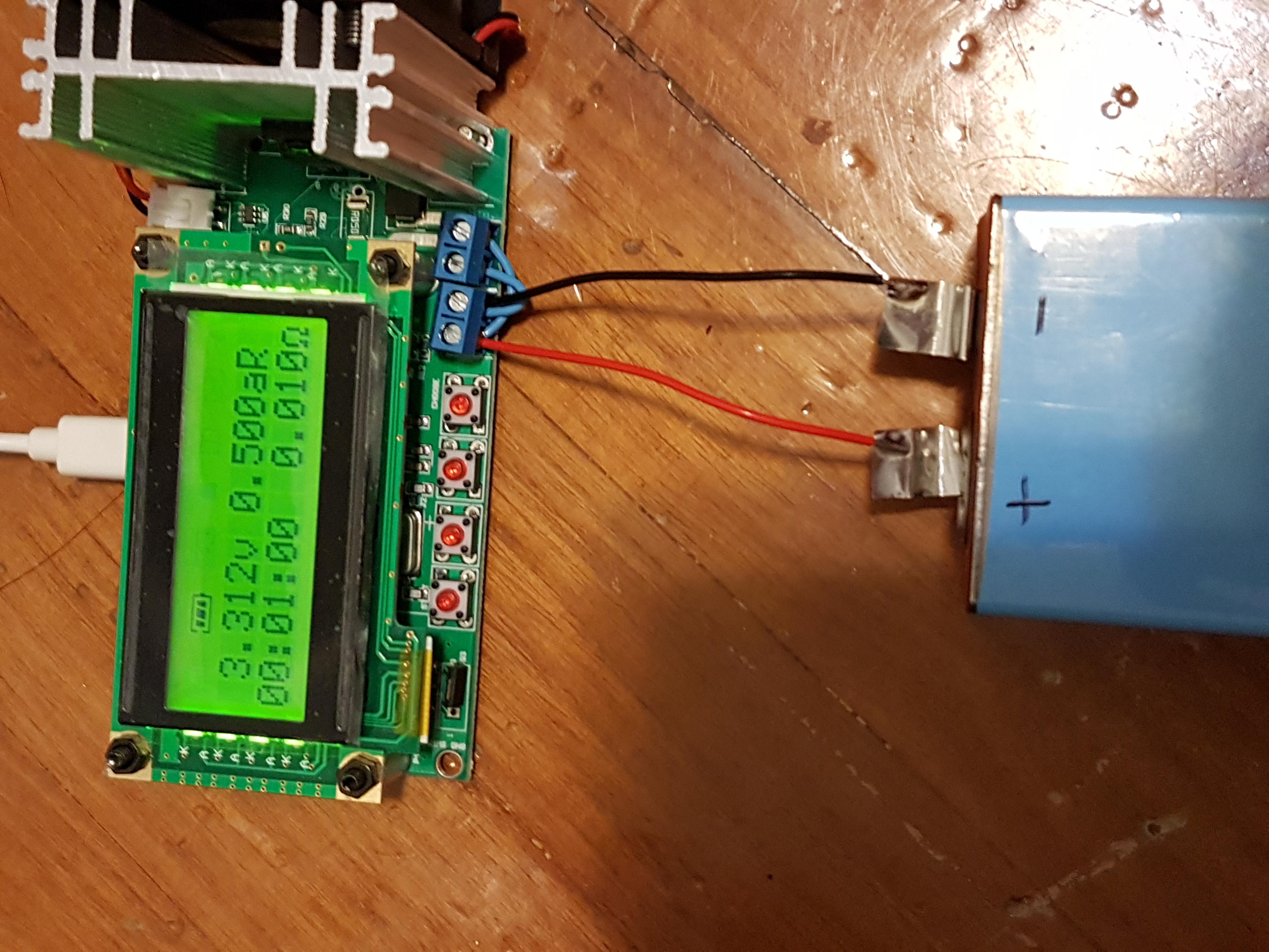

I have tested some industrial type lifepo4 (around 5AH) and they are around 10mOhm. If u get a higher AH like 30AH they can go down to 2mOhm, but it will be huge and weight around 0.7kg.
Even with 5AH, the battery can last a long time and post a simpler solution than the ultracap.
