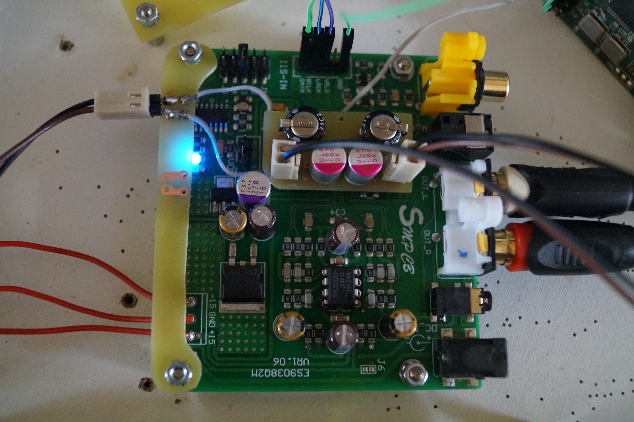

@Greg, @Alex
I'm quite excited about the sound quality of ultarcapacitor power supply.
I spent a whole day on weekend listening music with my ESS DAC HAT and the two 350F ultracapacitors. They make me discovering more from the music that I've listened for hundreds of times.
I designed a small ultracapacitor power supply board for RPi. A pair of Maxwell 350F, or 325F can be used as main 3.3V or 5V DC power. Hopefully I'll receive the prototype PCB next week. Maybe I can share some of the PCBs with you guys if you are also interested in trying this new option.
I'll do more test with this ultracapacitor power supply. I'll include it into this project if I'm happy with the result.
Have a good weekend
Ian

Ian you can do some photo of your ultracapacitor power supply board for RPi prototype please,
I'll post some pictures of my RPi ultracapacitor power supply for sure right after I get the PCB samples.
Ian
