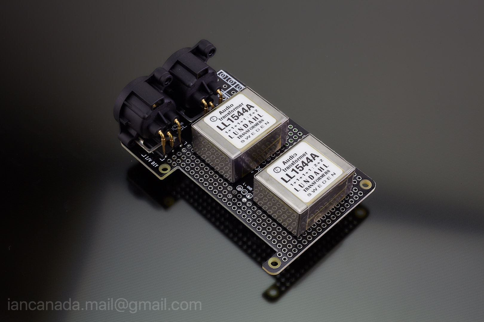

I built this LL1544A I/V stage on my "hole board". Much compact than the previous LL1674 transformer I/V, looks more suitable for RPi audio application.
It follows madds1's configuration.
http://www.diyaudio.com/forums/pc-b...i2s-dac-hats-raspberry-pi-15.html#post5369598
Please see the attached schematics for details.
Both LL1544A and LL1674 are amorphous core transformer and configured at same input/output ratio, hopefully it has similar sound quality as LL1674.
I'll get LL1544A I/V board compared with other I/V stage HAT very soon. I'll post update after I have test result. If it is promising, I'll design a true adapter PCB. I really like the size and the prices.

Stunning picture 👍

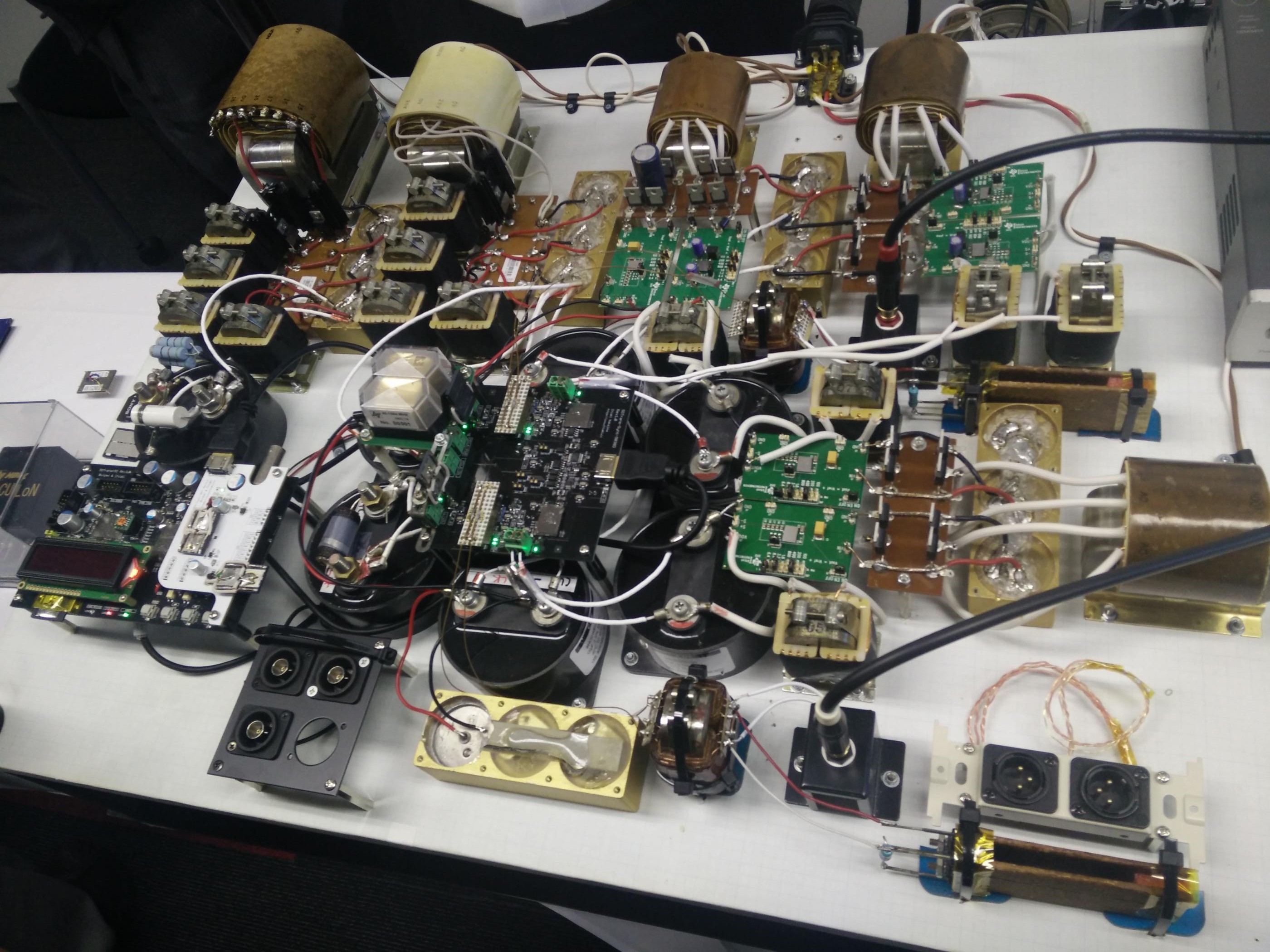

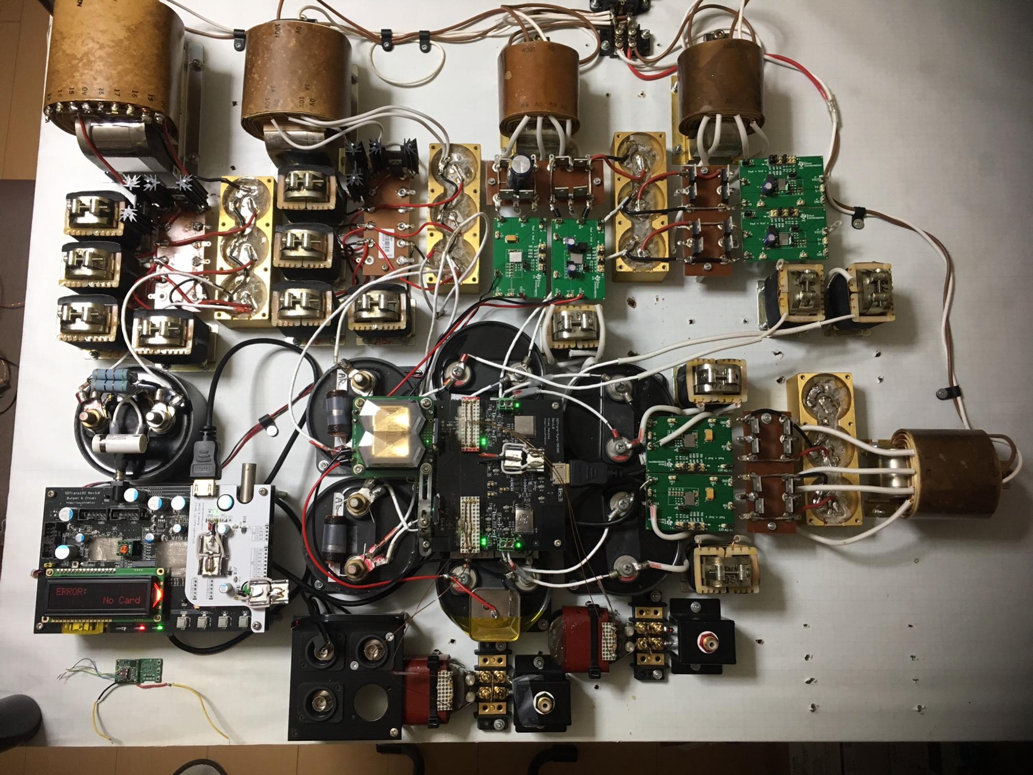

The Finemet transformers are what Chiaki & Bunpei have moved to for their personal implementations of their SDTran384 with a Chiaki-designed ESS-based DAC, using the various power, chokes, and output transformers from the Finemet line. Attached pictures shows a couple of shots of different versions of their implementation as-of awhile back.
You can see some of the line for sale on EBay US here:
fulken | eBay
Not sure the output transformers they list will fit within the confines of an RPi HAT!
Greg in Mississippi
P.S. the brass blocks with the 3 circular depressions are 3-section Evans Hybrid Capacitors which they have opened and are using each section separately. Also notice the DuCoLon clock! There is some significant financial investment in this setup!
fulken | eBay
Greg in Mississippi
