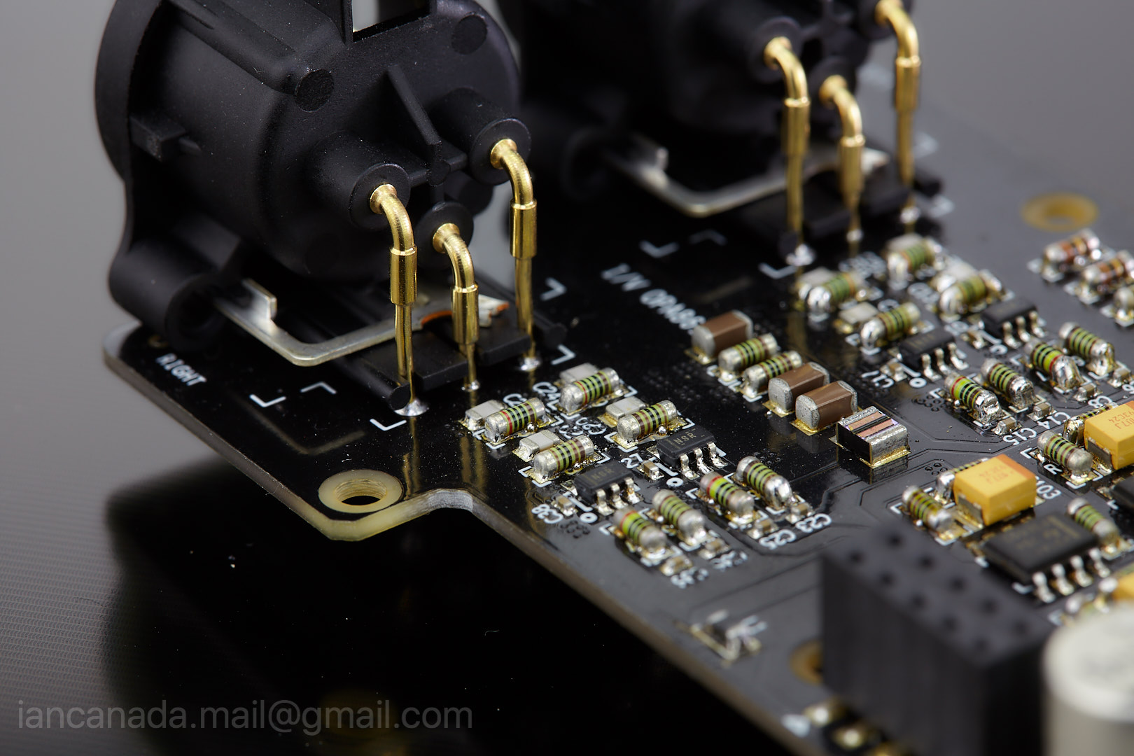

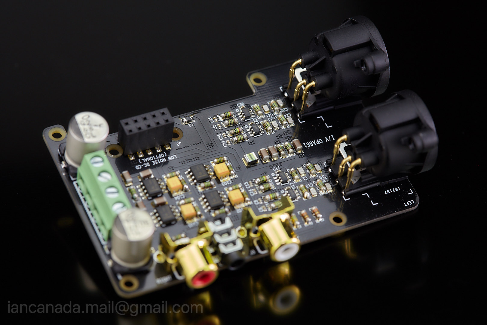

OPA861 fully balanced I/V stage PCB samples arrived last week. After a quick listening test, I have to say it's really really good. I never thought those small things can sound as good as that.
Actually OPA861 is very special, it's almost the perfect solution I can ever found for I/V stage:
1. Zero feedback, similar to passive solutions such I/V transformers or I/V resistors
2. True current input mode with impedance only around 10 ohm. ( 0 Ohm is the is the ideal input impedance of a current mode I/V stage, but it doesn't exist in the real world.)
3. 80Mhz high bandwidth and 900V/us slew rate. The speed is very good for a ESS DAC running at 50-100MHz MCLK.
OPA861 was very successful as I/V stage for TDA1541. And there are a lot of good reviews from audiophiles.

I think it was overlooked by people in recent years however.
In picture is the first balanced OPA861 I/V stage for ESS DACs. I hope very soon I'll run another full listening test to get it compare with Transformer I/V, OP amplifier I/V and the coming OPA1632 I/V.

Ian,
That looks great.
I am really hoping you will enable a way to use multiple of these with your MC FIFO for a multichannel DAC solution.
In fact a single board hosting 4x IV could offer incrementally better performance due to increased board space and larger shared power planes.
PC based DSP is very flexible and there is a need for good quality multichannel DAC.
I know you are primarily focused on Rasp Pi based stereo systems, but you have developed so many sub blocks that enabling DSP based systems also is possible now.
