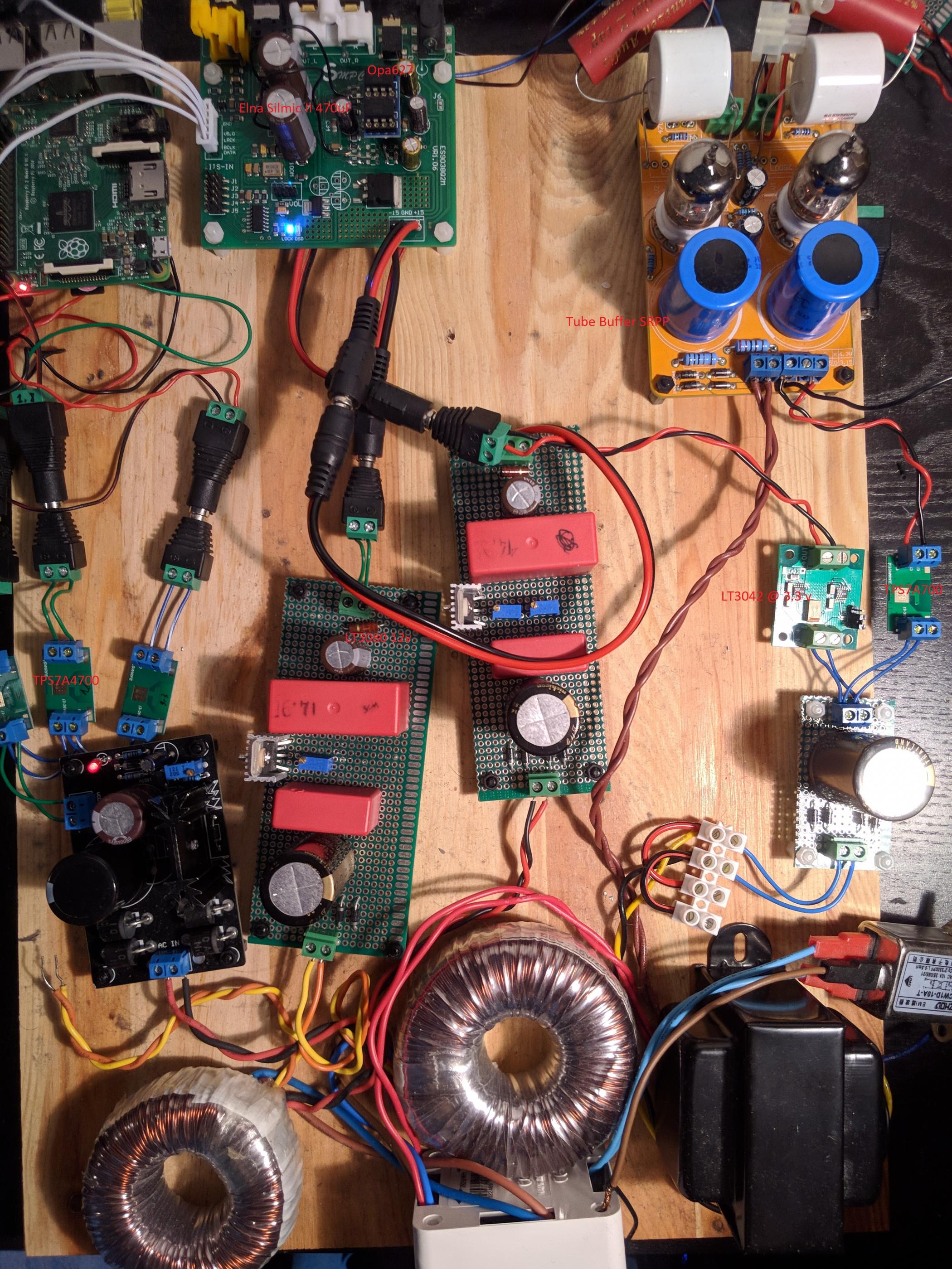

I finally finished my mods.
I use dedicated power supply for the Raspberry, improves bass control and clarity of sound.

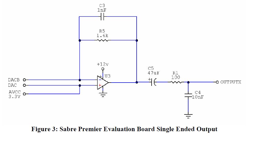

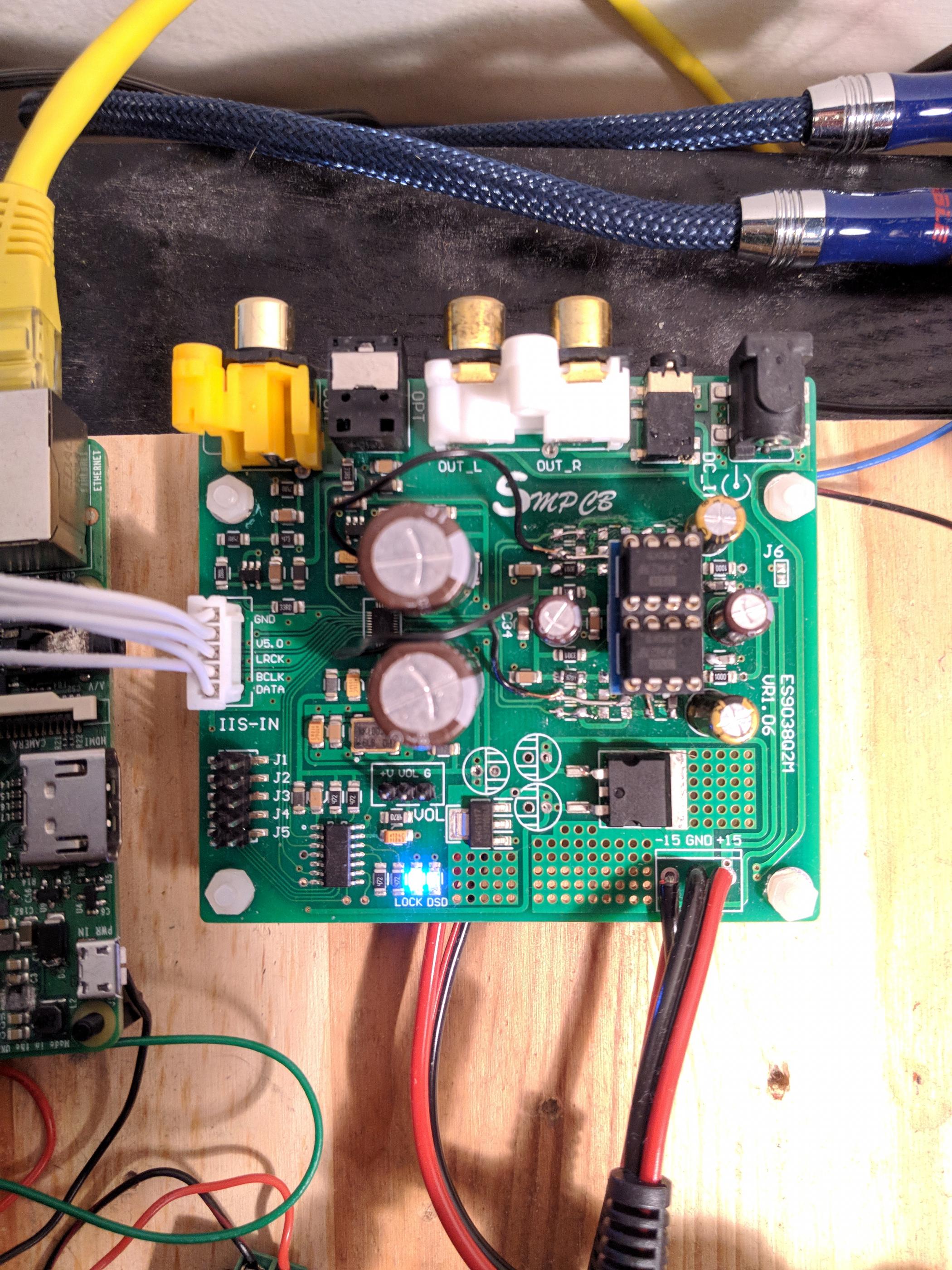

I attached the output that I applied to es9038q2m (recommended by Markw4 ... thanks).
I added an SRPP buffer to test the tube sound.
I am very satisfied with the result, now the sound is very similar to my UDA38PRO, obviously the valves have less controlled bass but the sound is now soft and not fatiguing, with good detail and stage.

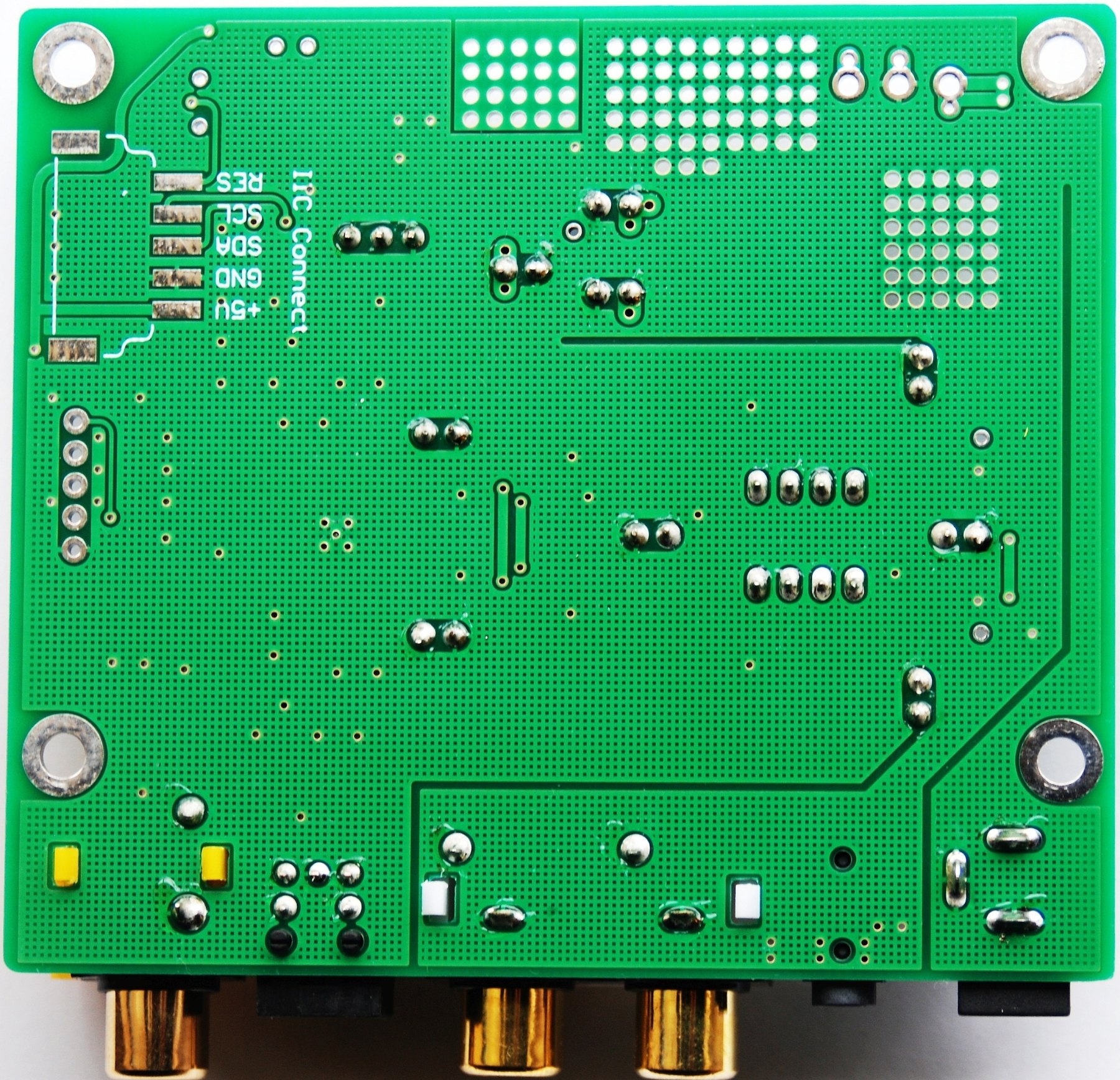

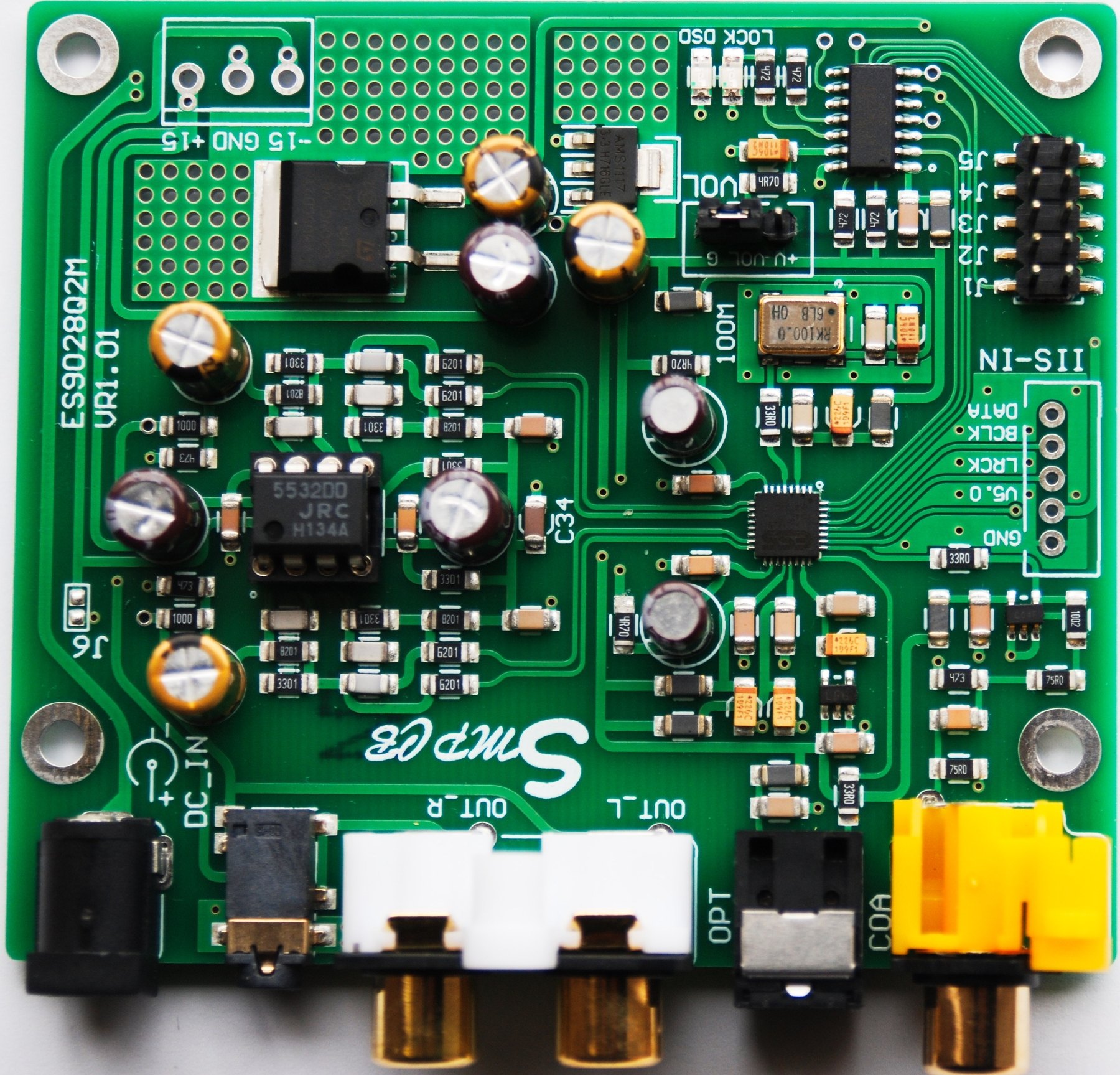

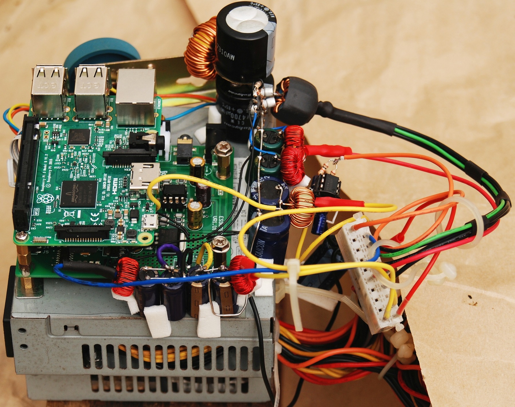

top of the board, untouched.
bottom of the board, untouched.

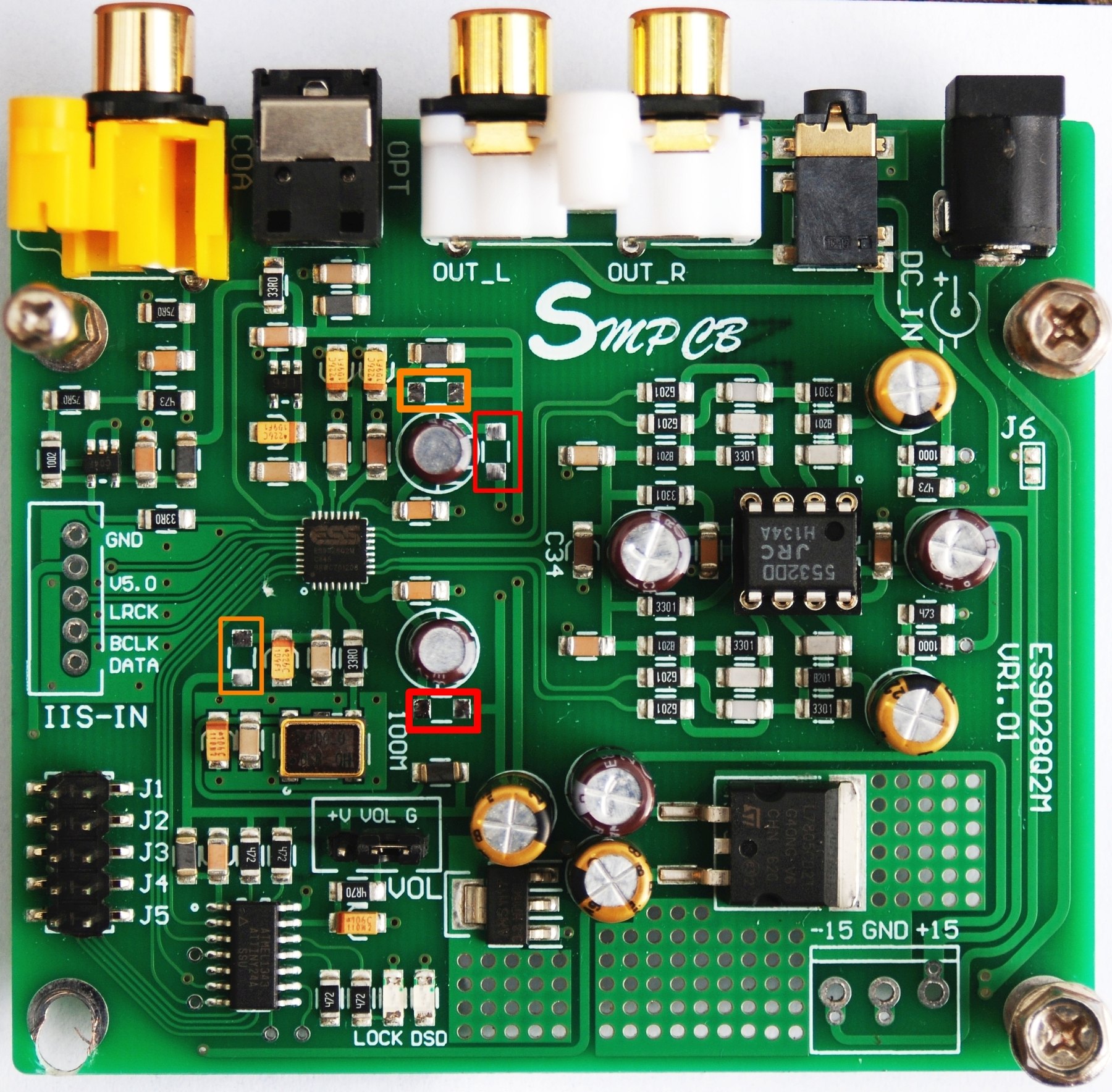

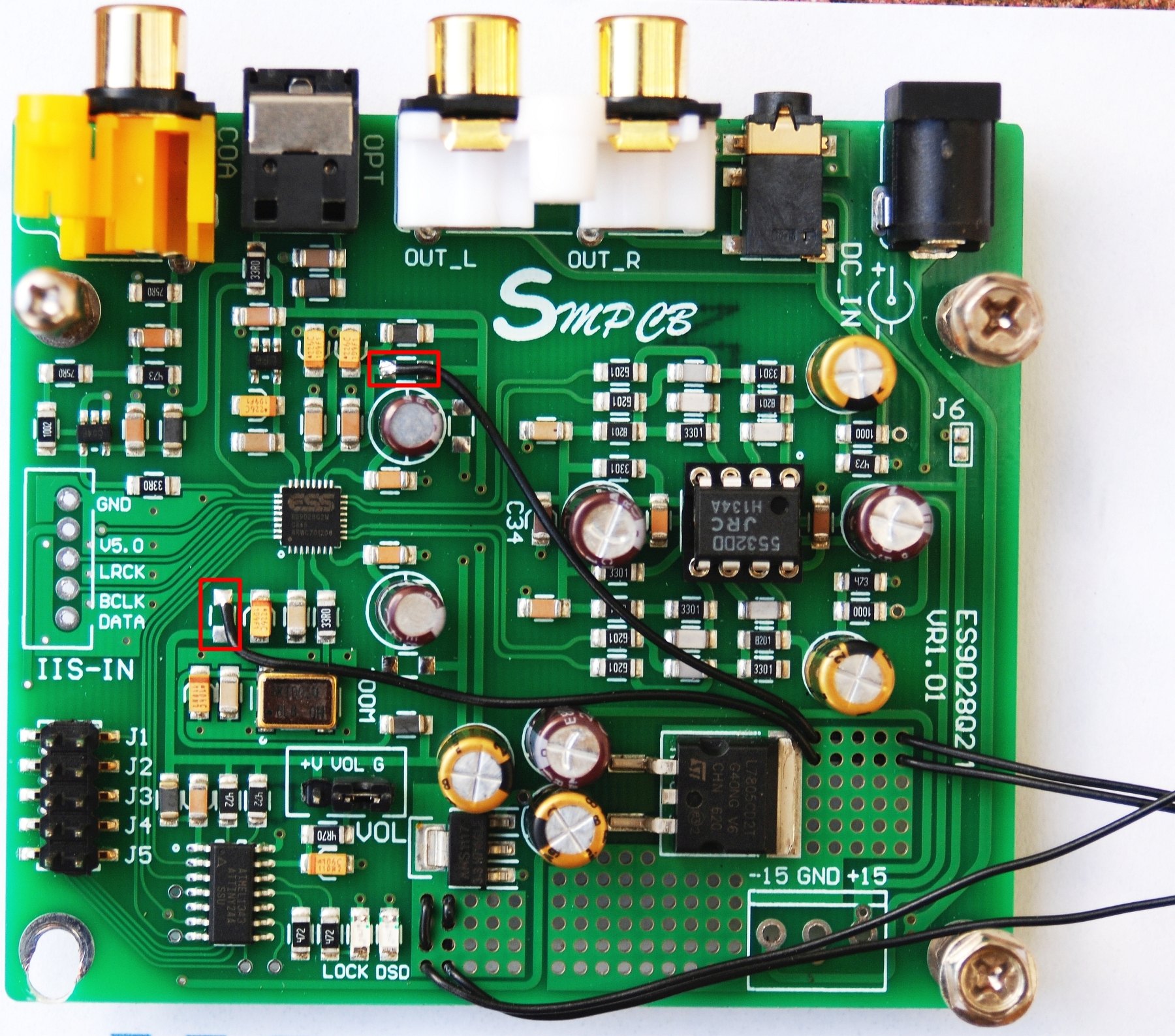

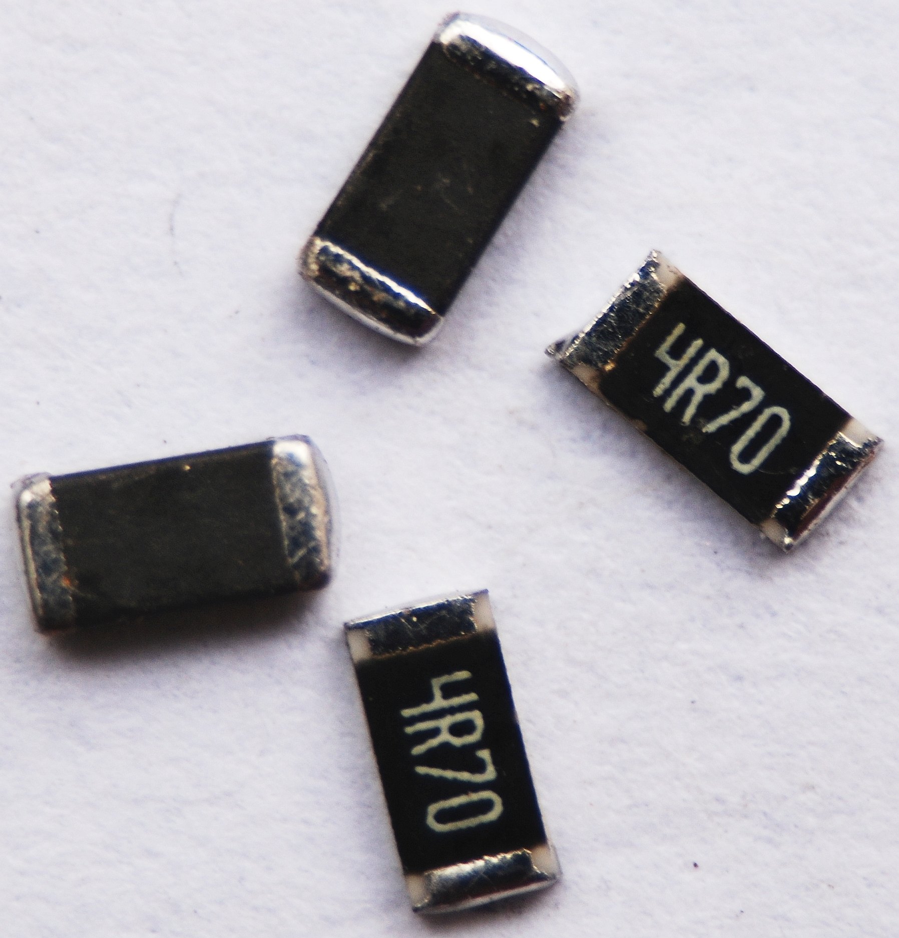

top of the board, 4 smd components out from the boad, avcc ( red ), vcca ( orange ).
4 smd components out from the board.

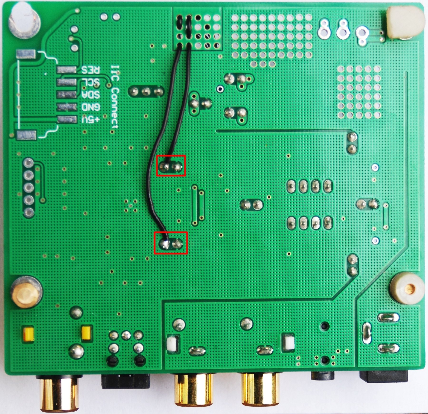

avcc wire ( red ).
vcca wire ( red ).
the dac, yes, use a recycled computer psu, all components are from recycled computer board.
avcc wire ( red ).
vcca wire ( red ).

@esli, Very resourceful use of old computer board parts! The I2S input from RPi and power supply mods all seem to make sense from what can be seen in the pictures. Looks like you have opted to stay with voltage mode output so far though. Any plans to do more with it? Or, maybe there could be a Katana happening sometime in your future?

Same SQ, so far as I can tell. I added some ground pins to help keep I2S transmission quality good at high sample rates. Also, had to make up some special interconnection cables for it. Pictures here: http://www.diyaudio.com/forums/digital-line-level/314935-es9038q2m-board-204.html#post5495993
There are also some extra ground pins added at the I2S connector on my modded Chinese dac board. Picture of that here: http://www.diyaudio.com/forums/digital-line-level/314935-es9038q2m-board-144.html#post5457773

Yeah, for some reason they say 'feet' instead of 'pin.' If there is DSD you will need F1 and F2 which some newer XMOS boards have. Otherwise you have to set the jumpers manually for DSD. The pin-1 DSD_ON signal can also be jumper selected at the D/P header. Just don't put jumpers on the SRC board if the Pin-1 and or K1/K2 are connected to corresponding pins on the USB board. The jumpers short those signals to ground which could burn up an output device on the USB board if not careful. That is my brief summary of part of what I think they are trying to say in the instructions. Hopefully, that is what you were asking about. If not, feel free to ask some more.
EDIT: Regarding extra ground pins, you have the right idea. On my dac board I had to remove the trace feeding power to the 5v pin at the I2S/DSD connection points in order to make room to put the extra ground pins. I was going to run a jumper wire to hook the 5v pin back up, but haven't done it since nothing has needed power from there so far.

Oversimon, your work (#2161) looks great, do you have a schema of the SRPP circiut? Which tubes are installed there? Is Katana a commercial product? If was yes, it seems we are getting more and more free commercial about it?
