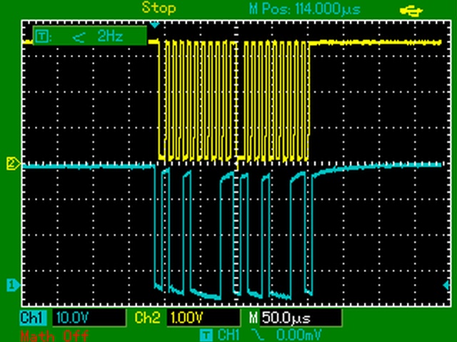

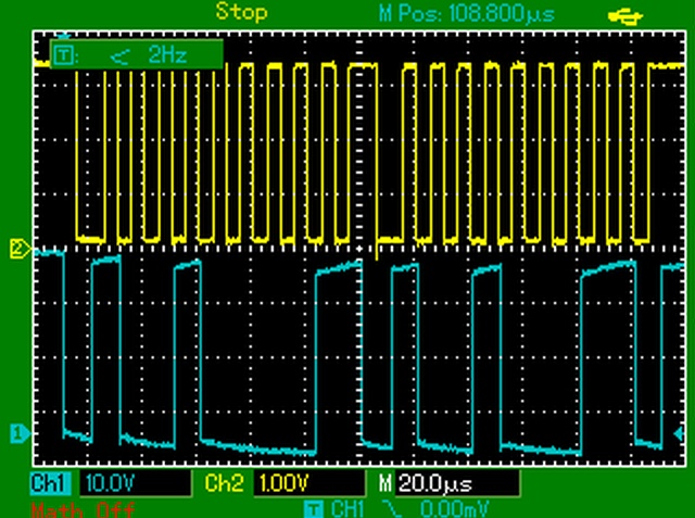

the i2c code can be seen from a digital oscilloscope, pi gpio pin 5 scl ( yellow ), pi gpio pin 3 sda ( green ). can't see any thing from other gpio pins.

@eslei, I take it your point to Ian is that he purchased one of the cheap copies he was complaining about, because it was cheaper.
I'm still not convinced you can turn off the dac MCU with jumpers. The MCU on my dac does not turn off with J1,J2 installed. Since the dac MCU runs constantly, you may or may not be able to grab control the I2C bus. Please let us know if you are successful that way. Otherwise, maybe time to lift the MCU I2C pins.
EDIT: Oops! Looks like we cross posted. Good to see to decided to get an analyzer.
EDIT 2: Notice one of your scope traces looks tilted. Are you using 10x probes that are calibrated?

i lift the attiny24 pin 2,3 at the beginning, couldn't get control of the dac but the driver is working, then add J1,J2, no luck, so time to get a logic analyzer.
you are right, that probe is a very old 10x, it dosn't have calibration features.
What I2C bus address are you using for the dac chip? It should be 0x90, if using 8-bit addressing format.
EDIT: No calibration ability for a 10x probe would be very unusual. If no little hole somewhere, I think some really old ones might have used a threaded barrel adjustment at the probe end. That's really stretching my memory though.
EDIT 2: Might there be an I2C bus sniffer or monitor for RPi? Could be somebody wrote an app for it.
