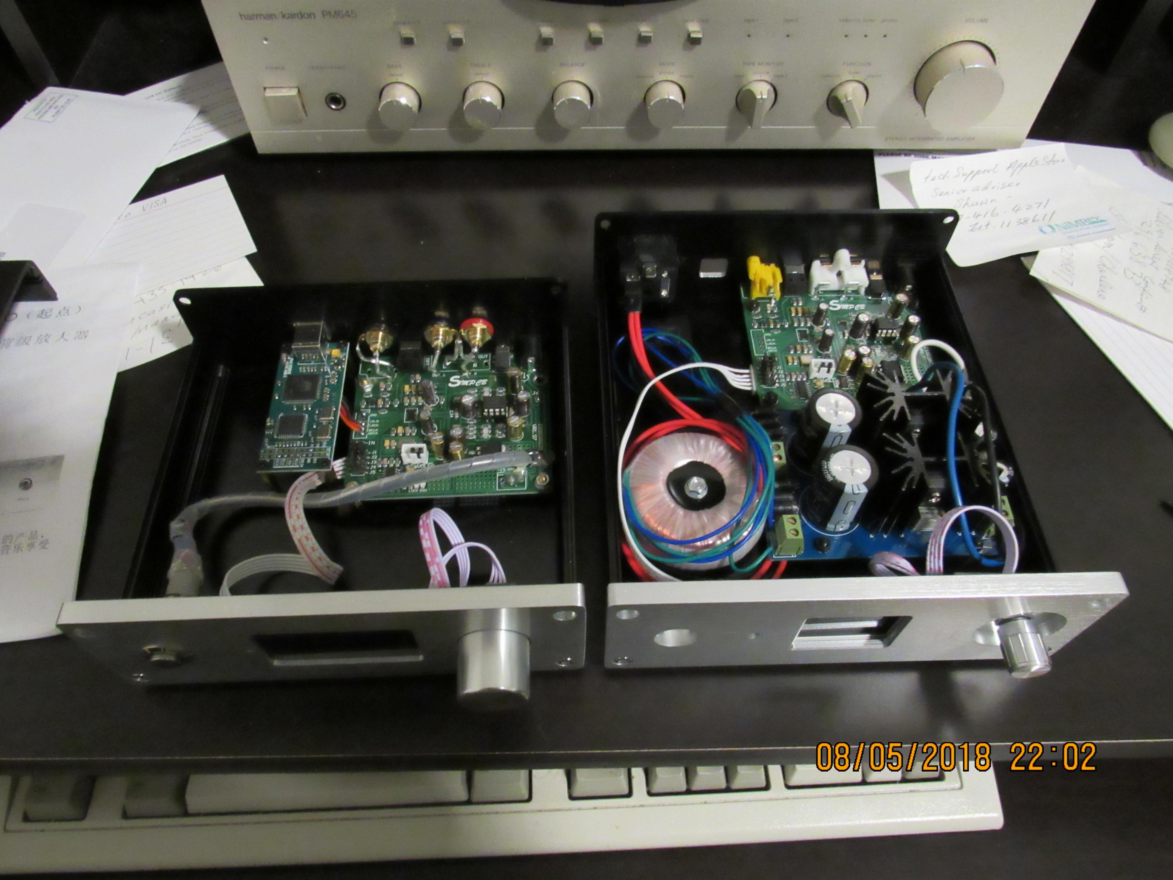

Folks may recall that I have strongly suggested modding a $32 LME49600 headphone amplifier board in order to be able clearly hear how well your dac is performing. So far, I am not aware of anyone doing that. If anyone would rather purchase a finished LME49600 HPA, a well constructed one can be found here: HP-1: Ultra-High End Headphone Amplifier
After living with this DAC using the ES9038Q2M and toyed with the idea of updating to an ES9028PRO DAC in the last month, I decide that the sound quality of this DAC is sufficient for the TV audio, DVD and CD digital sources that I use. I built another one using dual voltage internal PSU. It requires a deeper (180mm) case. The original factory built DAC and the home built DAC is shown side by side below.This is not a review and there is not much mod. Just the first impression of an inexpensive DAC using the ES9038Q2M.
The DAC links the TV cable box and a Sony BDP-7200 Blu-Ray player to a Harman Kardon AP2500 preamplifier. The Blu-Ray player also serves as my CD player.
View attachment 689897 View attachment 689898 View attachment 689899
The DAC is built around the VR1.07 of the ES9038Q2M board we discuss on this thread. At the beginning, I used a switching PS from the Topping VX-1. It sounds very good from the get go. The sound is open and transparent. It has a stable sound stage with good depth. The construction of the DAC box is well executed. A lot of hot glue to hold down the TFT display panel and wires. I like the upgraded RCA socket, better than the one on the original board.
View attachment 689906 View attachment 689907
I built a linear power supply for it. It can output 9 to 15 volts up to 1 ampere. It has a good size toroidal transformer and the board has a DC voltage panel for easy setting.
I was planning to install a dual voltage PS. But there is not enough room inside to house the transformer and PS board. I went the easy route.
I did not even try to add I/V. I just replace the output stage opamp with a LME89720. The board came with NE5532DD which should be very good. I changed the opamp only because I have a whole bunch of the 720 in my spare box.
View attachment 689903 View attachment 689904
I purchase an Apple Remote which allows me to perform all the front panel functions.
My previous DAC were a Rotel RSP-1570 (for main audio) and a Tianyun Zero DAC (computer sound). Both were 10 years old vintage. It is not surprising that the MShow DAC sounds pretty decent to me. The TFT display and remote function are nice bonus. I will not hesitate to recommend this as good investment for the money, at half the price of name brand DAC. In fact, later this month, I will try to sell mine to finance my ES9028PRO project.

It is the same VR1.07 SMPCE Chinese board. The new case uses the onboard RCA jacks instead of off-board ones. The new home built DAC is working fine as is, but I am waiting for the power on-off and volume knob.

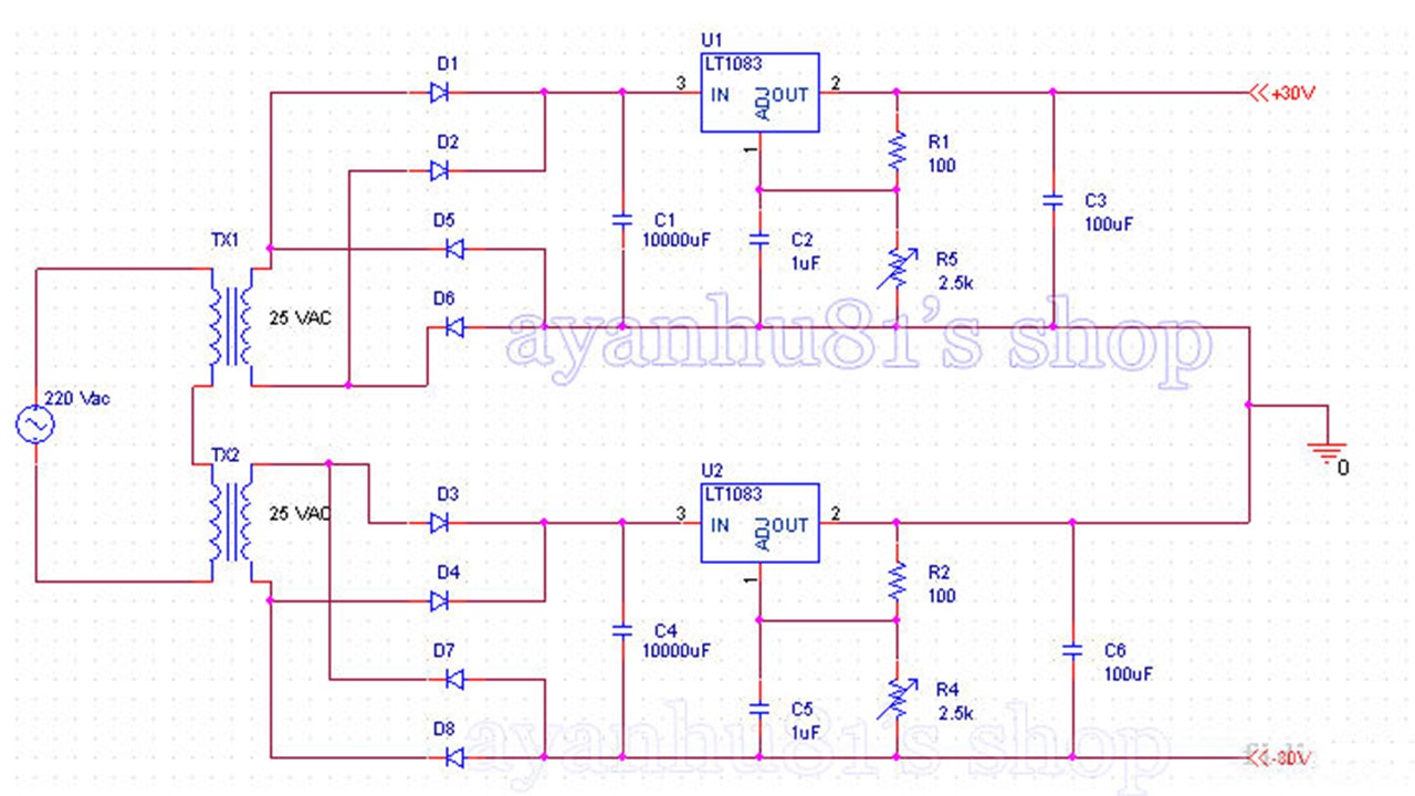

The transformer is from Antek with a dual 15VAC windings. The PSU has dual full bridge rectifier with LT1083CP regulators set at +/- 15VDC.
![LT1083CP_2channel.jpg LT1083CP_2channel.jpg](https://www.diyaudio.com/community/data/attachments/644/644668-744aff4f9b1ca43cf498423690c329cd.jpg)
The schematic of the PSU is notional, not the actual values of components that I used.
I like the home built DAC very, very well and may sell the factory built DAC soon. If you are interested, PM me.
