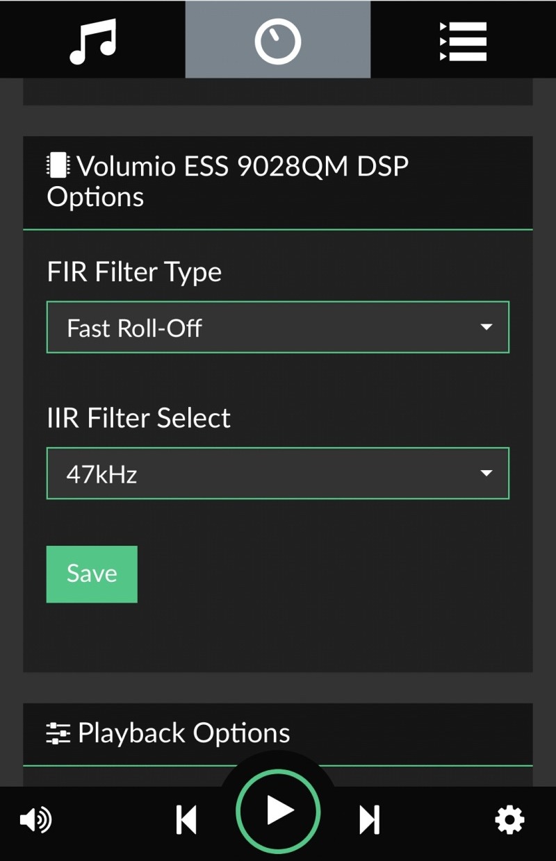

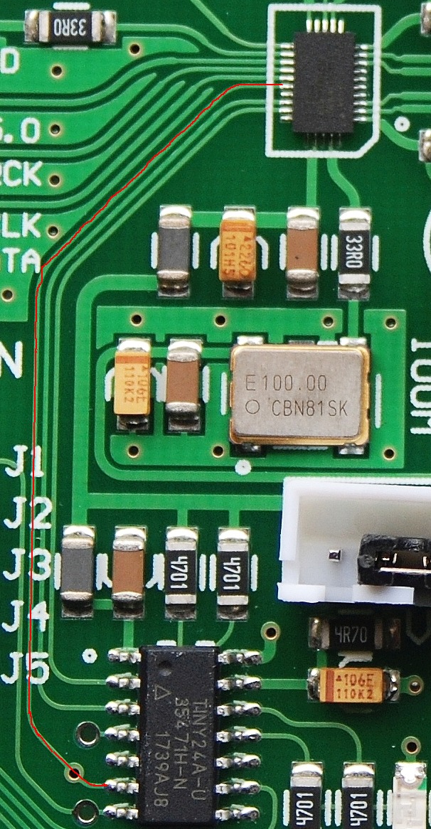

some progress on volumio v2.444 and 9028q2m driver:
green 9028q2m board i2c sda to pi gpio pin 3,
green 9028q2m board i2c scl to pi gpio pin 5,
disable the on board mcu by j1, j2 on,
I can't figure out wich pi gpio pin for res, any comments, suggestions, and solutions are appreciated, but able to get the driver working on half volume, unable to change volume, sq sounds good to me. the driver looks have full control of the dac.

@eslei, what is the physical connection the driver assumes for how Q2M is interfaced to RPi?
Does it assume there is I2S only, with four pins: DATA, BCLK, LRCK, GND?
If so, that would mean volume would have to be controlled by adjusting the PCM/I2S data sent to the dac (software volume control) rather than by using the Q2M digital volume control registers (hardware volume). Is that how it is supposed to work?

Okay, I see you want to connect I2C bus for control. RES is for RESET, which the Pi should not need to do. However, J1,J2 on does not disable the on-board mcu, it sets it to I2S/PCM/DSD mode, same as if J1,J2 are both off. If you want to disable the on-board mcu then you must lift the mcu I2C pins as I have shown in previous posts.

If you want to see what command Pi might be trying to send by I2C you can use one of these super cheap logic analyzers which are fast enough for I2C, and the software can decode I2C format into hex or decimal instructions thus making it very easy to read the code. New USB Logic Analyzer Device Set USB Cable 24MHz 8CH 24MHz for ARM FPGA M100 7000000492822 | eBay
that's the 9038q2m pin 21, master reset. on green board connect to attiny24 pin 6.
i don't have a logic analyzer, i'll try to use a digital oscilloscope.
i2c hardware volume, the code can be seen from a digital oscilloscope.
