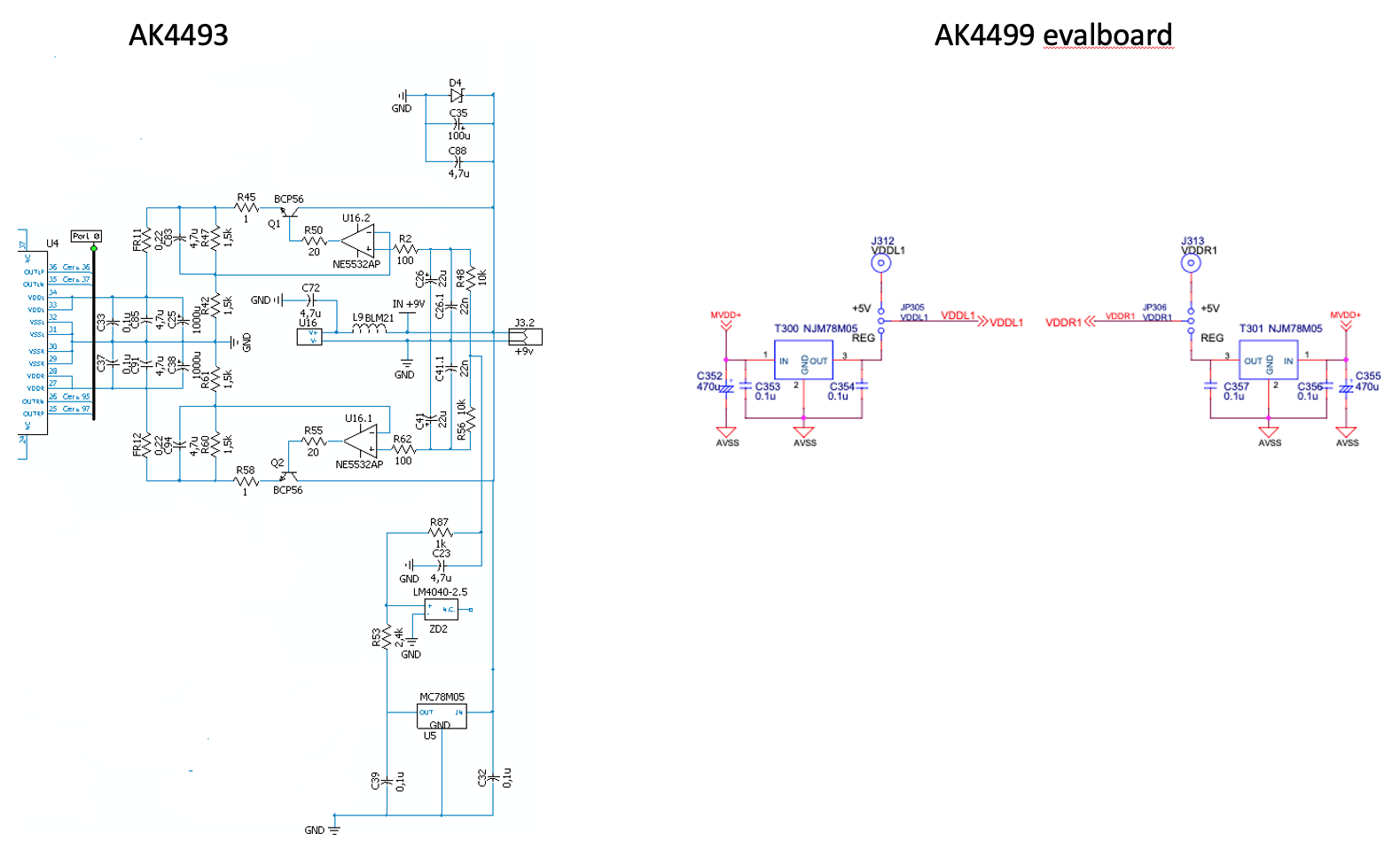

I'll take your word over what the schematics posted there show (looks like some errors in them, and legibility of text is not very good).
Don't want to argue about it, we have too much of that around the forum already.
Bottom line for me is that I like AK4499 a lot, but don't know exactly how good it can sound at best. Still working on trying to find out, but taking my time doing it. Another experiment is in the works only this time I have learn Circuit Studio first. Something to do while home bound I guess![]()
indeed, it is sometimes hard to read schematics and the text, especially if it is originally in Russian
ok, if we still continue to hijack this thread for AK4499 purpose, then one can take a look, how VDD supply is designed in AKM 4499 evalboard and how it is in Andrews AK4493 project ...
... one can take a look, how VDD supply is designed in AKM 4499 evalboard and how it is in Andrews AK4493 project ...
Its funny, I have tried a few other regulators instead of the eval board NJM7805 regulators, and the eval board 7805s always sound best so far. However, they run off pre-regulated +15v so the power coming into them is has already been regulated once. Almost all other loads have been removed from my eval board's +15v rail, mostly it is just a pre-regulator for the NJM7805s. As I have said elsewhere, some years ago a couple of guys with good ears did a listening test of all 78xx regulator brands and found there were differences in sound quality. They rated NJM78xx the best sounding. So, I don't know. It works, what else can I say.

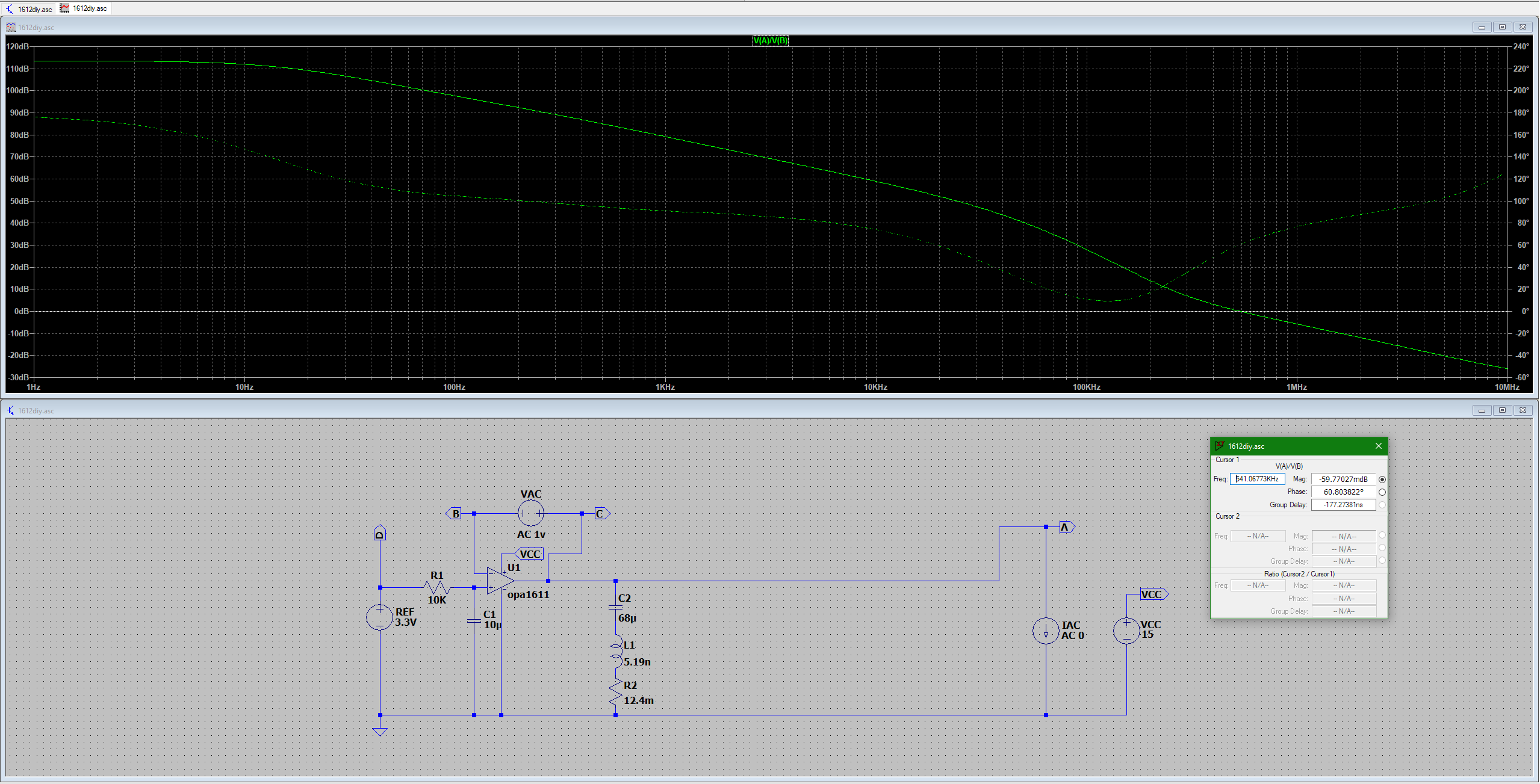

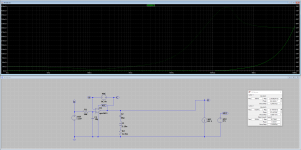

Normally you can use with grounded negative VCC on the Opamp, just depends on the voltages on the op-amps inputs (all being positive for starters) - and within the input operating range when used with Grounded Neg VCC rail....
If you post a circuit with the opamp you intend to use then I can confirm operation for you.
I attached the simulation schematic, open loop gain / phase and Zout plots here.
We plan to feed the OPA1611 from an LT3042 running at 15V output.
it is hard to guess what's up not knowing what those few other regulators were. anyway, if one leaves everything solely to listening tests, then there is no way to find out what possibly may go technically wrong. methodologically this is nonsense of course, but we are not upon any kind of scrutiny here. If onboard regs sound best, then there is no need to look further of course.
