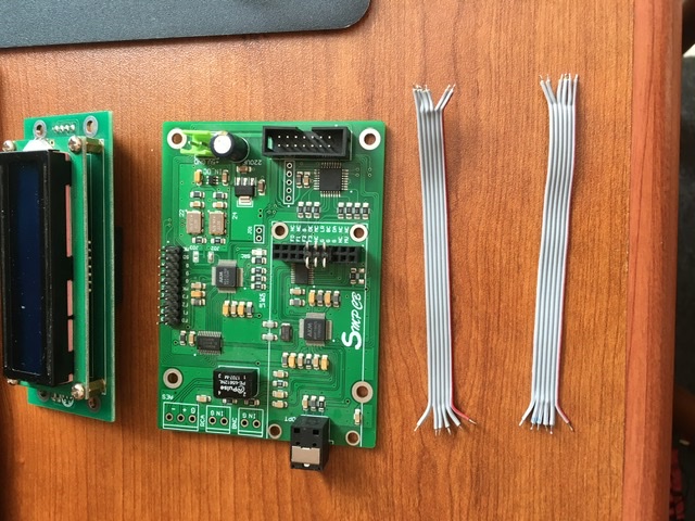

I think it’s the same board as the one you have.
The pic of your AK4137 looks like it might be missing a part. The board I have of that style has one more small pcb with a single momentary push button on it. The button board plugs into a small connector on the display board. The button is to configure AK4137 operation and select digital audio input sources.
EDIT: Also, if you don't already have a pin header kit and crimper, you might want to consider getting something like: WayinTop Connector Crimping Tool Kit Crimper Plier 2.54mm Header Male Female Crimp Pins Terminals Housing 1 2 3 4 5 6 8 10 Pin and 40pin 1.27mm Ribbon Cable FC/IDC Jumper Wire 1M (Crimping Set) - - Amazon.com
A couple of comments about using pin headers for digital audio: (1) ribbon cable conductors tend to be brittle and fatigue break easily when used with pin insert and shell type pin header connectors. I usually prefer to use #28 silver plated teflon wire with JST connectors, maybe such as: PTFE Teflon Silver Plated Copper Hook-Up Wire or Pairs 24/28/30 AWG 3m/10' | eBay
...and, (2) for I2S and clock pin (and their associated grounds) header cables I found that using other than gold pins can cause audible jitter problems. At one time low cost gold flashed pin header kits were available from Amazon or ebay, but haven't seen any for a long time. Gold JST pin inserts (both male and female) that work with standard shells are available from suppliers like Mouser and Digikey, but they are sold by the individual pin and are not cheap. Don't know what to do about that but only use them in critical locations.
Also, best to get in some practice crimping and or soldering pins before using gold inserts. It takes some practice to do reliably. I could offer some tips later when the time comes.
