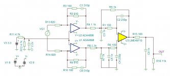

You could do that, or there is newer version of it and maybe a B.O.M. attached to post #3003 of this thread. In addition, there is a version someone posted of Topping D10 output stage which I will attach below. You can see they are all essentially the same topology, which is a good one (but with some different component values used which we could discuss in more detail).
Of course, a schematic is not the only consideration. Proper components and a good layout matter a lot too. In more recent times I have changed my preferred I/V opamp to OPA1612, although LME49720 can work too. Capacitors in the signal path should be COG or NPO types, and the resistors should be thin film SMD or metal film through hole types.
You may be interested to know I created a through hole component output stage board how-to together with pics and instructions at the request of some thread members. I can give you a link if you would like to take a look at it. However, my preference has always been to go with SMD which I personally find easier to work with. The guys wanted through hole parts though, so that's the version I did.
Regarding differences between ES9038Q2M and ES9018, the only thing that matters from output stage perspective is dac maximum output current. The I/V feedback resistor value can be adjusted to give the output voltage swing needed (usually configured for about 3v peak to peak maximum output swing).

WRT 11V vs 15V PS rails, that is surprising. Normally the opposite is the case and they nearly always measure slightly better with higher rails.
WRT the I-V schematic, have you checked what LPF function it is or if it is 'linear phase'? There have been plenty of published I-V LPF's that didn't have
linear phase response which is a no-no.
WRT NPO ceramic caps, they do measure very low distortion but I've nearly
always used Wima FKP (Film+Foil polyprop) caps for LPF circuits.
